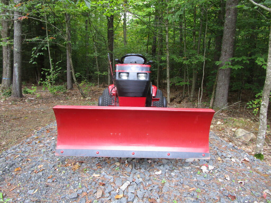

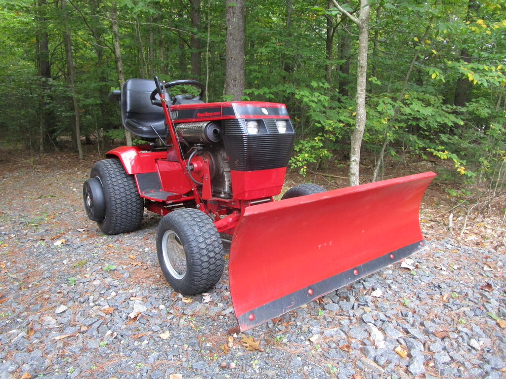

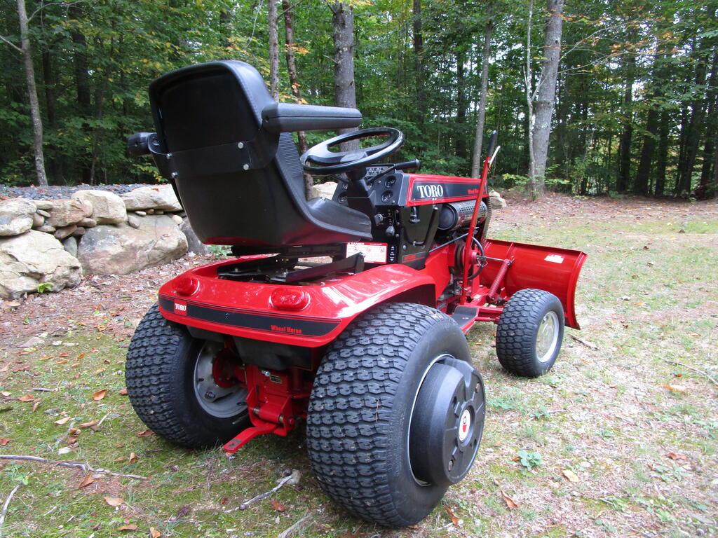

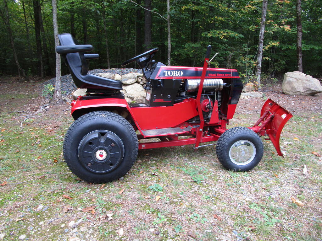

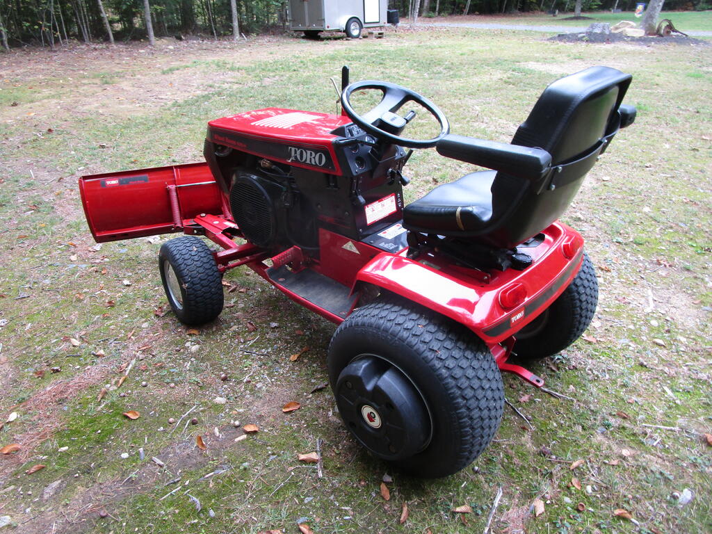

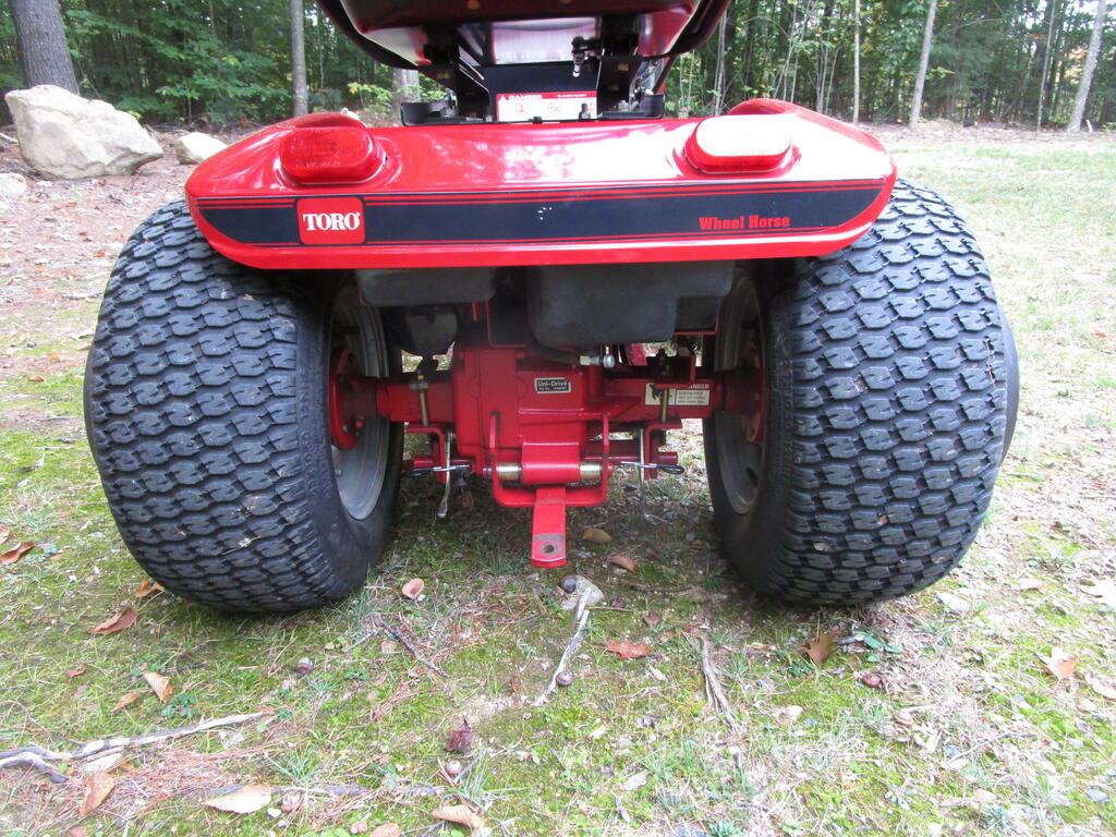

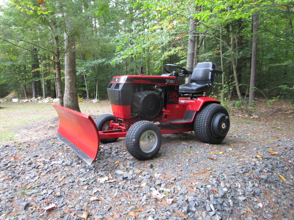

JCM 9,991 #1 Posted October 6, 2023 Been a long time coming to have the 520 set up for plowing somewhere in the time frame of 20 years. I bought this plow new in 1990 one year after the 89 312-8 was purchased and used it for a couple of years plowing the driveway. Back then I had no idea that the 520 required a front extension kit so the front tires would clear the blade when angled. Only used it twice and decided to buy a 44'' two stage and set that up on the 520 instead. I was able to locate an Original Cab Co hardtop soft cab,and misc parts pile, basically all new , slightly used. In that pile was brackets etc of which the seller and I had no idea what their purpose was. Those were in the garage of a new house he bought and the PO left them behind. Also a rear Kwik-Way rear weight box with attaching parts etc that I still have. Last year I repainted the front side of the 48'' dozer blade and cutting edge with Rust O leum regal red. Last weekend I repainted the rear of the blade with Toro new red. Have not used the Toro paint since the early 2000's and here are my thoughts and opinions. The regal red seems to spray a wider pattern than the Toro so the overlaps are much closer when using Toro. The color has that less orange look to me than the Toro. The Toro dried much faster and able to handle it much sooner. Taking into consideration last weekend was absolutely perfect for painting and drying outdoors. I feel the Toro is a closer match than the regal when trying to get close to the original panels on the rest of the tractor. Here are some pictures as it sat today. This will be used to clean up after using the big tractor and for smaller lighter storms.I consider the 520-H semi-retired after performing flawlessly for the past 21 years. Forgot to add a big Thank you to Mike and Eric for help with the NOS rear weights Mike and the offset plow lever Eric . Chains will go on when the snow flies. Enjoy the pics all. 4 11 Share this post Link to post Share on other sites
ebinmaine 70,320 #2 Posted October 6, 2023 VERY nice Jim! Glad to help out. Will you run it with the cab? 2 Share this post Link to post Share on other sites
JCM 9,991 #3 Posted October 7, 2023 35 minutes ago, ebinmaine said: VERY nice Jim! Glad to help out. Will you run it with the cab? No cab on this one Eric. 2 Share this post Link to post Share on other sites
Horse Newbie 7,193 #4 Posted October 7, 2023 3 hours ago, JCM said: Back then I had no idea that the 520 required a front extension kit so the front tires would clear the blade when angled Where does this extension kit go ? 2 Share this post Link to post Share on other sites
c-series don 9,374 #5 Posted October 7, 2023 The extension kit goes on the rear of the plow frame. It lengthens the plow for 520’s with a forward swept front axle. 4 1 Share this post Link to post Share on other sites
Horse Newbie 7,193 #6 Posted October 7, 2023 Thanks @c-series don, I have it then… guess it threw me off a little when I read “front extension kit.” It extends the back of the frame which in turn extends the front of the frame… I would just call it an extension kit… or an extension… And this “ kit” is needed on all long frame WH’s, not just the 520’s with the swept forward axles, correct ? 1 Share this post Link to post Share on other sites
c-series don 9,374 #7 Posted October 7, 2023 @Horse Newbie No, the kit is only necessary for 520s with a forward swept front axle. The kit is not necessary for any other tractors. 1 1 Share this post Link to post Share on other sites
WHX?? 50,488 #8 Posted October 7, 2023 Just a beast Plunge. Keepherunnin they just don't make em like that anymore... 1 1 Share this post Link to post Share on other sites
c-series don 9,374 #9 Posted October 7, 2023 Something about a black cutting edge I like! So I painted mine 👍🏻 3 2 Share this post Link to post Share on other sites
peter lena 9,053 #10 Posted October 7, 2023 @JCM very nice set up on that ! do any plow quadrant / related , linkage detailing / easy function ? pete 2 1 Share this post Link to post Share on other sites
JCM 9,991 #11 Posted October 8, 2023 Yes @peter lena I gave that quadrant and associated parts a good lube job. 2 Share this post Link to post Share on other sites
peter lena 9,053 #12 Posted October 8, 2023 @JCM glad you did that , when I first did mine , just kept tweaking on it , adjusting , tightening up , the lever pull handle , made for easier / faster response . had it up off the floor , so I could roll around it for motion checks .snugged up all movement areas , red aerosol grease , at lever quadrant pull slide . it was such a difference , also did the other , 2 plows , recommend things that I have been doing . combine that with a slick plow blade face , and plowing is much easier , thanks for the shout , pete 3 Share this post Link to post Share on other sites
Sparky-(Admin) 21,863 #13 Posted October 11, 2023 On 10/6/2023 at 6:45 PM, JCM said: Forgot to add a big Thank you to Mike and Eric for help with the NOS rear weights Mike and the offset plow lever Eric . Nice to see those weights getting used! They spent many years just sitting in storage here. 4 1 Share this post Link to post Share on other sites
