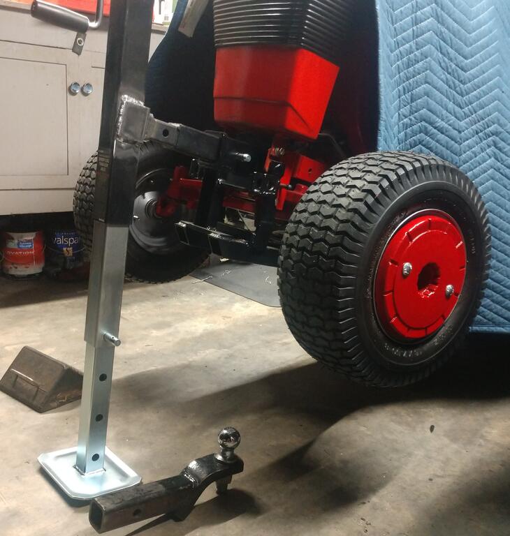

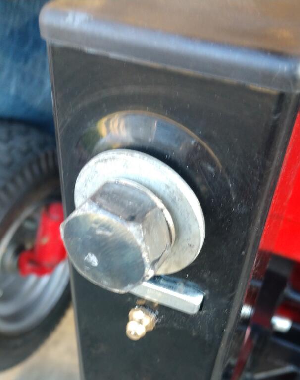

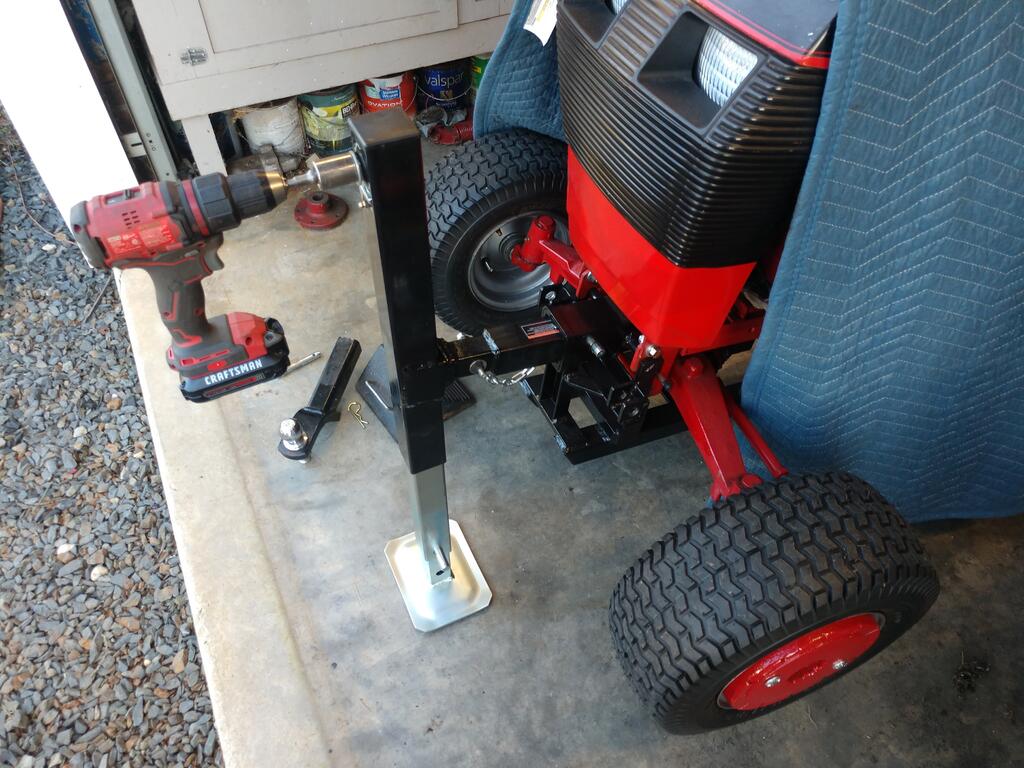

kpinnc 13,105 #1 Posted September 30, 2023 Should be "Scag jack", but it works with my front hitch as well, so what the heck. 24 inches of lift, claims 52 inches with the drop foot extended. 3500lb rated. I removed the round pivot and welded up an adapter to fit a 2 inch receiver. I also canted it back a little so it is closer to straight up when lifted higher. The pic below is only about 1/2 way up, and still has two more holes in the drop foot. And no, I won't use it without jack stands. Not going under a 1000lb Scag without them, and wheel chocks. Works very well. I'm considering cutting the crank off and welding a 3/4 nut on the shaft so I can use a cordless drill to run it up and down. 4 7 Share this post Link to post Share on other sites

ri702bill 8,738 #5 Posted September 30, 2023 2 hours ago, Pullstart said: Pretty nifty! That’ll help get the trans oil over the hump! And to be able to properly grease the front axle...... IF you could add a curved "rocker" to the underside of the foot plate, it would keep the load more under the center as it lifts and tilts .... 2 Share this post Link to post Share on other sites
ebinmaine 69,710 #6 Posted September 30, 2023 Well done Sir. 9 hours ago, kpinnc said: considering cutting the crank off and welding a 3/4 nut on the shaft so I can use a cordless drill Could you leave the crank in place and add the nut to the outside? Perhaps both methods would be handy? 1 Share this post Link to post Share on other sites

Lee1977 6,917 #8 Posted September 30, 2023 (edited) I would not want that handle moving around with a drill turning it. Edited September 30, 2023 by Lee1977 2 Share this post Link to post Share on other sites
kpinnc 13,105 #9 Posted September 30, 2023 2 hours ago, ebinmaine said: Could you leave the crank in place and add the nut to the outside? I was thinking of making the handle use a socket so it can reattach if needed. 5 Share this post Link to post Share on other sites
Horse Newbie 7,168 #10 Posted September 30, 2023 I would go with the 3/4” nut, void the warranty, and use a 3/4” combination wrench or ratchet and socket if you need to fine adjust the height… 4 Share this post Link to post Share on other sites
ebinmaine 69,710 #11 Posted September 30, 2023 1 hour ago, Lee1977 said: I would not want that handle moving around with a drill turning it. Oh yeah you'd have to keep it slow for sure 1 Share this post Link to post Share on other sites

kpinnc 13,105 #13 Posted September 30, 2023 10 hours ago, Lee1977 said: I would not want that handle moving around with a drill turning it. I'll make a handle that slips over the nut for use when needed. 9 hours ago, Horse Newbie said: I would go with the 3/4” nut, Yep, that's what I did. Runs to full length in about 15 seconds now. Works well with the Scag too... 2 1 Share this post Link to post Share on other sites
