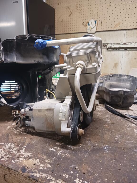

enamel 35 #1 Posted September 28, 2023 Sorry didn't know where else to post this But the is an air compressor. This is the main air feed line to the manifold and stuff. I haven't loosend it either. Reason I took it apart is I can hear a slow leak. I did soapy water on manifold and lines I could see,but the sound was coming from in the case so figured pressure switch. Then found this. I just assumed it shouldn't move. 20230927_2046011.mp4 Share this post Link to post Share on other sites

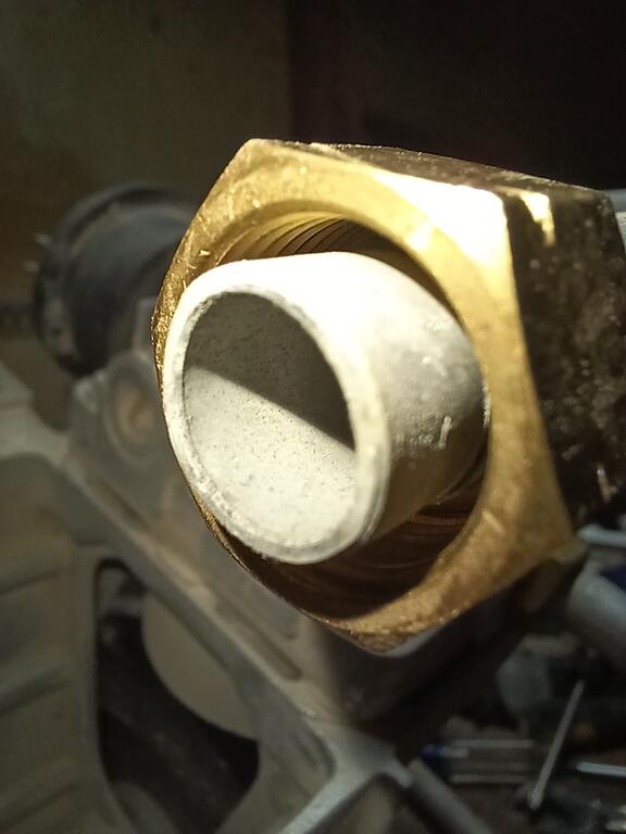

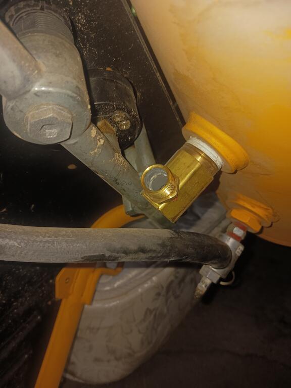

enamel 35 #3 Posted September 28, 2023 1 hour ago, JCM said: What does the opposite end with the blue tape look like. I have never had one apart but it might be a flared connection because of the operating pressure ? First pic is blue tape end. Other pic is what goes into head. Share this post Link to post Share on other sites
lynnmor 8,480 #4 Posted September 28, 2023 Of course it should be tight, most of the cheap compressors make no provision to deal with the vibration. A good compressor will have a coil of tubing that will flex to allow for the vibration. 1 Share this post Link to post Share on other sites
gwest_ca-(File Mod) 11,957 #5 Posted September 28, 2023 Looks like the air intake. Should be tight with an air filter on the other end. 1 Share this post Link to post Share on other sites

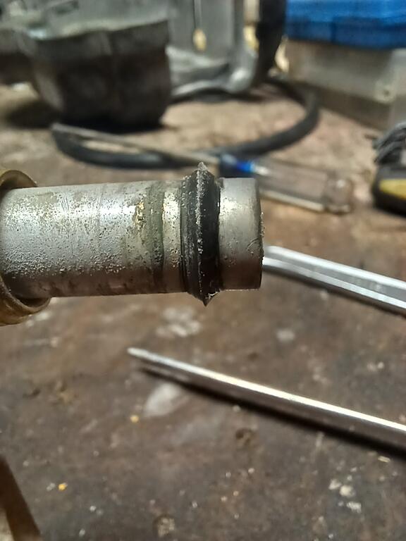

Kenneth R Cluley 659 #6 Posted September 28, 2023 (edited) That is like a ferrule that compresses on tube when tightened. Fault usually occurs at edge of ferrule, cracks. Check inside tube and you may see crack. Another trick is to shave a little off of end of tube to allow it to tighten a little more and seal. Think file or hack saw, doesn't require much taken off. Edited September 28, 2023 by Kenneth R Cluley 1 Share this post Link to post Share on other sites

enamel 35 #8 Posted September 28, 2023 5 hours ago, gwest_ca said: Looks like the air intake. Should be tight with an air filter on the other end. Other end feeds the tank. 1 Share this post Link to post Share on other sites
enamel 35 #9 Posted September 29, 2023 OK,i put it back together whith out its case. Now I don't hear the leaks. I did remove the pipe and reinstalled it. So is it possible over the time of use the nut loosend up a tiny bit? Causing the leak. There is a clamp on the pressure switch also. Share this post Link to post Share on other sites
