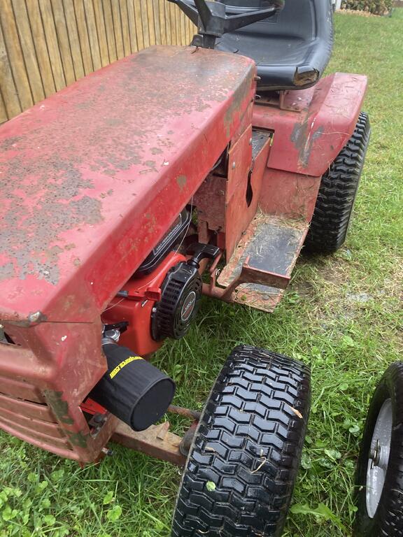

Jake the 312-8 72 #1 Posted September 23, 2023 Wheel horse 1100 special 71718388814__5825CF67-7D8D-4CF4-8954-82FDD1955EF4.MOV Share this post Link to post Share on other sites

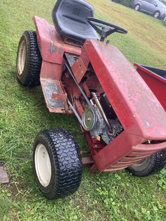

Pullstart 63,529 #5 Posted September 24, 2023 Do you have plans for a belt guard or a way to stop the belt while shifting? Looks like fun, but don’t break your transmission 1 Share this post Link to post Share on other sites

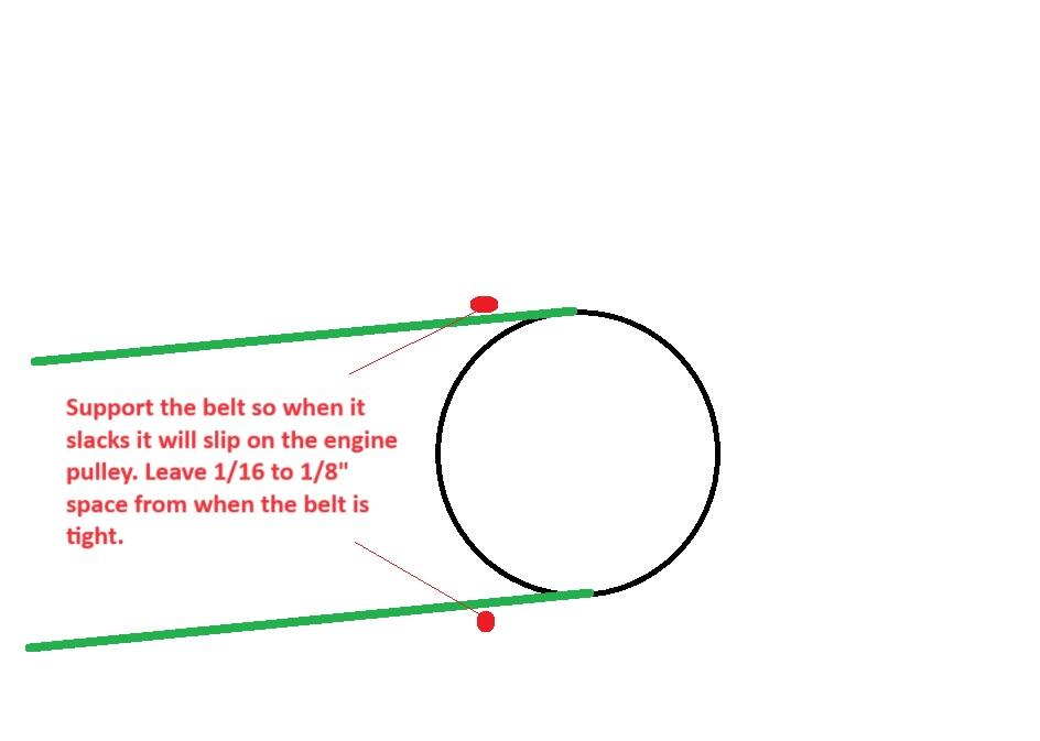

wallfish 17,193 #7 Posted September 24, 2023 Any change for the trans pulley too? Going smaller for it will speed it up even more. You can substitute the belt support of the belt guard with some small steel rods attached to the engine to achieve the smooth clutching action. 3 Share this post Link to post Share on other sites
Jake the 312-8 72 #8 Posted September 24, 2023 Yeah i just have the belt guard off at the moment it does about 18 mph i will try to post a video Share this post Link to post Share on other sites

Jake the 312-8 72 #11 Posted September 24, 2023 It has a 6 on the front and 4 on the back Share this post Link to post Share on other sites

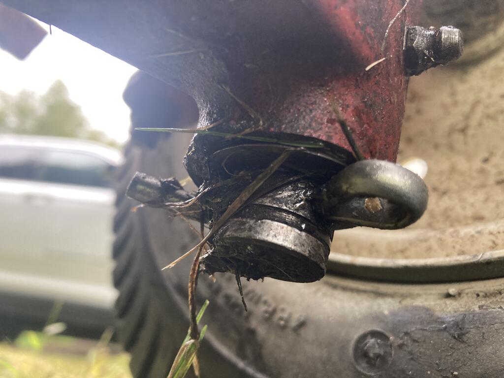

Handy Don 13,084 #12 Posted September 24, 2023 With the axle inverted, I’m sure hoping that you have more than a “C”-clip securing those front wheel spindles into the axle. Other members have drilled and tapped a hole in the end of the spindle for a bolt/washer (with blue Loctite) as a backstop to the C-clip!? 1 Share this post Link to post Share on other sites
wallfish 17,193 #13 Posted September 24, 2023 ABSOLUTELY DO NOT TRUST THOSE C CLIPS FOR HOLDING THE SPINDLES IF THAT'S ALL YOU HAVE HOLDING THEM ON THERE!!!!!!!!!!!!!! Can't stress that fact enough. It would save some pain to just go to the dentist's office and knock your teeth out there in the parking lot with a hammer so you can get treatment quicker. 3 Share this post Link to post Share on other sites
Jake the 312-8 72 #14 Posted September 24, 2023 Yeah we drilled it and we have the biggest cotter pins you can have and there holding in there Share this post Link to post Share on other sites
