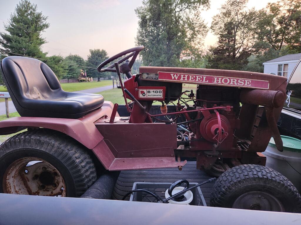

Nathan W 5 #1 Posted September 20, 2023 What cranking Amp battery is everyone using on an auto 16/ c 160. Also what brand. 190 doesn't seem to turn it very well. Saw a 320 cranking Amp. Just curious. The 341k is on a gt1142 so battery is where gas tank is on the auto 16. Thanks. Share this post Link to post Share on other sites

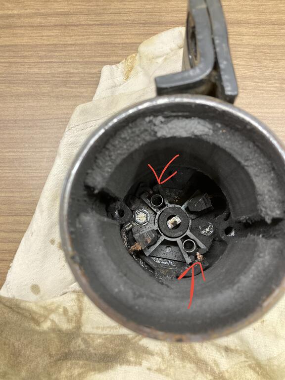

oliver2-44 10,367 #9 Posted September 20, 2023 It might also be time to give your starter some maintenance. The Kohler manual has a good section on this. You can get a brush and bushing rebuild kit from DB electric. These starters are really not hard to disassemble, clean and lube bushings. The starter on my sons 312-8 seemed to be dragging or turning over slower. Pulled the starter and the brushes were worn down to almost nothing. 3 Share this post Link to post Share on other sites
Nathan W 5 #10 Posted September 20, 2023 This is great info. I have a k321. The starter is a 237510 part # if I'm taking the one off the k341. I Need to look up if it interchangeable. I got it on a b100 it's a 75 so short frame 1in axles not keeping it only the k321 on it. 1 Share this post Link to post Share on other sites
oliver2-44 10,367 #11 Posted September 20, 2023 @Nathan W There is a “ High Mount” and Low Mount” starter on the Kohler K engines, easy to see the difference. Also count/compare the number of teeth on the starter gear to be sure they are the same. 1 1 Share this post Link to post Share on other sites
