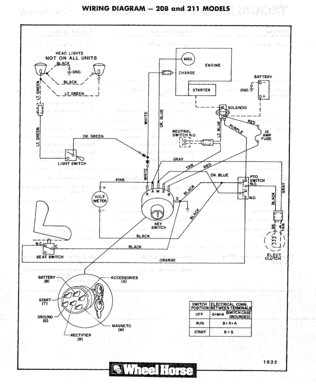

River_Ratt 0 #1 Posted September 19, 2023 so i bought this mower a few months ago for 100 bucks and when i got it, it tried to start with no oil in it, once i put oil in the motor it would not start, it wouldn't even bump over. the starter is good and everything is attached that needs to be BUT i was going over the wiring and i found a pink wire that was crimped with a grey wire attached to it, would the pink wire with it not being connected to anything else, would that have an effect with it not starting or even cracking over? Share this post Link to post Share on other sites
gwest_ca-(File Mod) 11,241 #3 Posted September 19, 2023 Download this file. Each circuit has it's own diagram. 1 Share this post Link to post Share on other sites
River_Ratt 0 #4 Posted September 19, 2023 would a pto switch affect anything about it not starting Share this post Link to post Share on other sites
gwest_ca-(File Mod) 11,241 #5 Posted September 19, 2023 Yes. The pto switch is in 2 parts. One half controls the starter along with the clutch pedal switch and the other half controls the ignition with the seat switch. 1 Share this post Link to post Share on other sites
