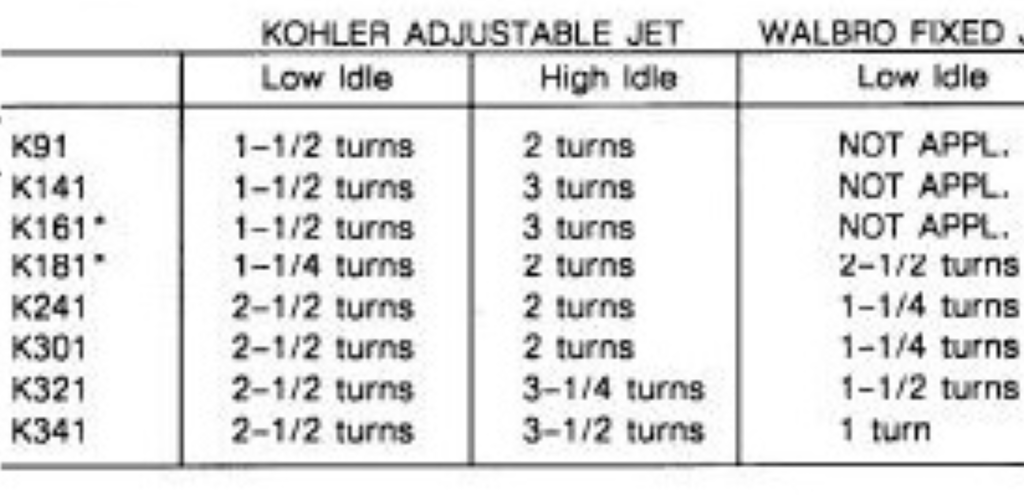

hotajax 226 #1 Posted September 19, 2023 (edited) Is it two turns out on main jet AND low idle screw? New carb. Thanks. Other question: If the main jet screw with the pointy tip ( the one that sits way down inside the carb ) looks a little dull, is it OK to take a file to it lightly and make it nice and thin again? Edited September 19, 2023 by hotajax Share this post Link to post Share on other sites
wallfish 17,494 #3 Posted September 19, 2023 Those are initial settings. Still best to adjust them according to each engine when it's running Don't file that ! You will not be able to keep it symmetrical to fit the seat IMO. 1 2 Share this post Link to post Share on other sites
tunahead72 2,518 #4 Posted September 21, 2023 On 9/18/2023 at 8:39 PM, hotajax said: Is it two turns out on main jet AND low idle screw? New carb... Depends on the carb. There's fully adjustable Kohler/Carter and Walbro carbs out there, they're different. And what do you mean by a "new" carb? All bets are off if it's something other than a Kohler or Walbro. 1 Share this post Link to post Share on other sites
