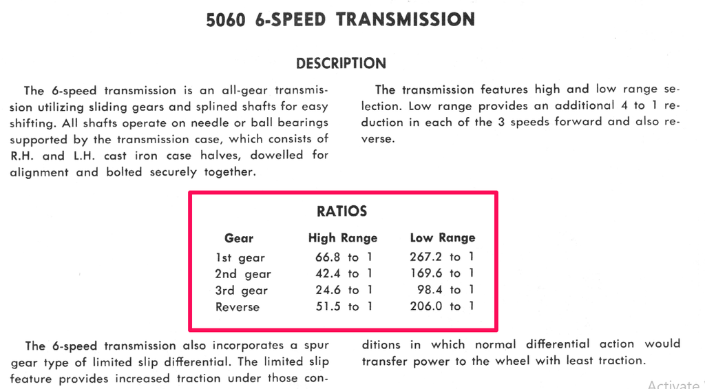

Pullstart 71,098 #2 Posted September 18, 2023 Power is a touchy term. 3L is a bit lower gearing than 1H. Power is relative though. 1 Share this post Link to post Share on other sites
Achto 32,347 #3 Posted September 18, 2023 8 hours ago, Sled Man said: My question is does 1H have more power than 2L or do all three low gears have more power than the higher gears. Tractor generally stalls out and just want to know which gear is best to pull in. 1st & 2nd are probably the strongest gears inside your transmission. Running in low range will give you more pulling power but you will sacrifice ground speed. Slower ground speed will put you at a disadvantage when pulling, making it more prone to loose traction. Momentum is your friend. Check the rules where you are pulling. Our local club allows the RPMs of the engine to be increased according to HP rating in stock class. Example - under 10hp are allowed to run at 4200RPMs max, 10 - 15hp can run at 4000RPMs max, 16hp & up are limited to 3700RPMs max. Increasing your engines RPMs will give it a little more horse power to help keep it from stalling out. Share this post Link to post Share on other sites

WHGuy413 2,859 #5 Posted September 19, 2023 My son is getting into pulling and the local pulling club president let him come pull at his place of business the other day to see if he liked it. He said that the rpm’s can be brought up as he goes. But some people will crank it right from The start. We played around with gears and determined that h1 works good for most and the dropped it down to l3 or even l2 when needed. Can’t wait for his first pull in a few weeks. Will be running in the strictly stock class with his c-121. 1 Share this post Link to post Share on other sites

Jon Paulsen 291 #7 Posted October 15, 2023 On 9/17/2023 at 11:47 PM, Pullstart said: Power is a touchy term. Thanks for the laugh bro. Pullstart For future reference: Share this post Link to post Share on other sites
