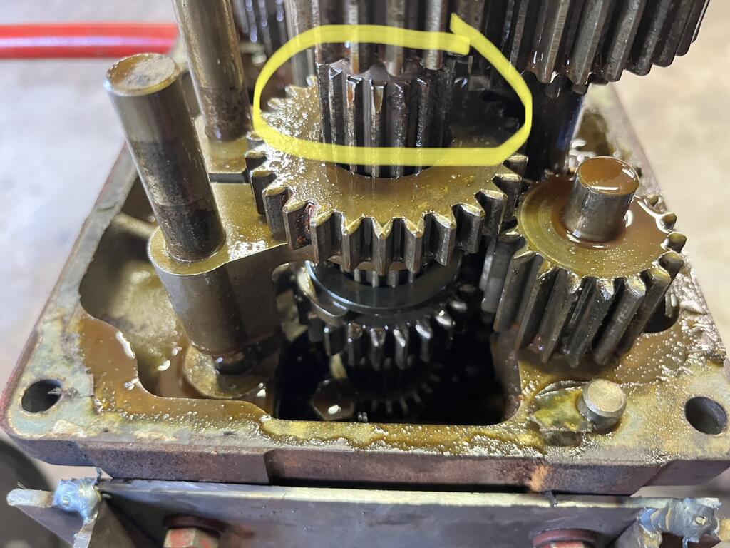

Wvtroutbum81 215 #1 Posted September 17, 2023 Thoughts on the damage. Share this post Link to post Share on other sites
ri702bill 8,613 #2 Posted September 17, 2023 The gear just below it moves - up and down in the picture. Shifting at speed, not coming to a complete stop does just that......... 1 1 Share this post Link to post Share on other sites
Wvtroutbum81 215 #3 Posted September 18, 2023 Does it need replaced, I pulled it out of a field where it sat for 20 years Share this post Link to post Share on other sites
oliver2-44 9,968 #4 Posted September 18, 2023 @stevasaurus what’s your thoughts on the above gear damage? Share this post Link to post Share on other sites
squonk 41,737 #5 Posted September 18, 2023 Spline gear in the left lower of this pic. Is that the only bad spot? How's the other side? What was the exact issue that caused you to take it apart? You might get away with cleaning up the burrs with a small triangle file. A-Z probably has a decent gear. 1 Share this post Link to post Share on other sites
Wvtroutbum81 215 #6 Posted September 18, 2023 Thats the only bad spot. I drained the fluid and it looked like apple butter and was full of grit, thank you for the help Share this post Link to post Share on other sites
squonk 41,737 #7 Posted September 18, 2023 (edited) That gear that slide there is the 1st/Rev gear. Most likely caused by not getting completely stopped when shifting out of Reverse. Did this tractor do any snow plowing or dirt moving? Might want to look at the inside teeth of that rev/1st gear Edited September 18, 2023 by squonk Share this post Link to post Share on other sites
Wvtroutbum81 215 #8 Posted September 18, 2023 No clue on history, sat in a field for 20 years before i bought it 1 Share this post Link to post Share on other sites
stevasaurus 22,955 #9 Posted September 18, 2023 I'm thinking you will be OK with that shaft being like that,..as long as you make sure you come to a complete stop before shifting. Limcoln at A to Z should have one should you want fo replace that shaft. He is in our Vendor Section. Share this post Link to post Share on other sites
