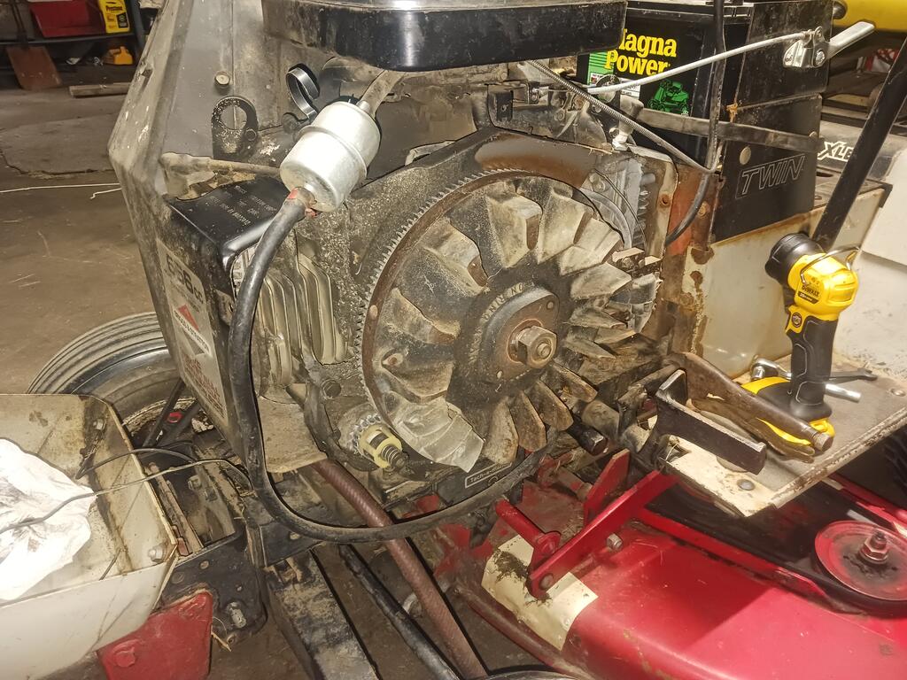

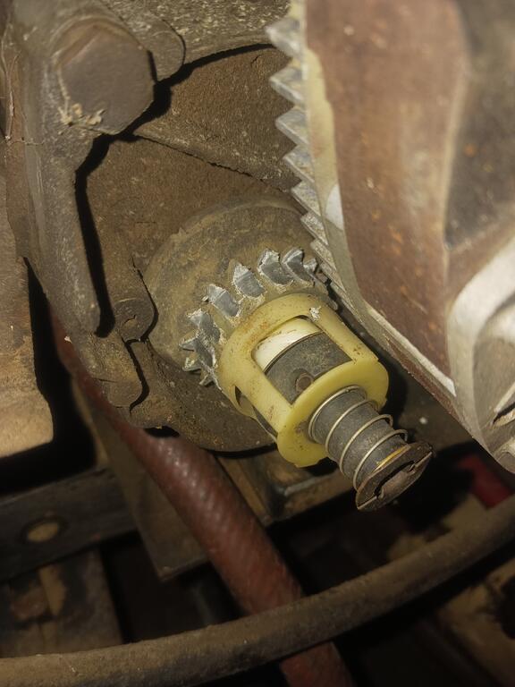

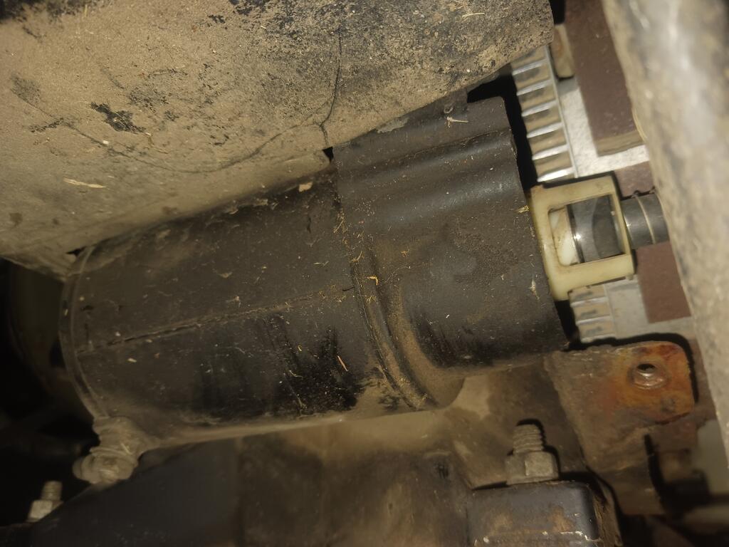

enamel 35 #6 Posted September 17, 2023 31 minutes ago, Achto said: If you could post a picture of your starter set up, I may be able to help further. Here's a couple pics. 2 Share this post Link to post Share on other sites
Howie 899 #7 Posted September 18, 2023 I think one of those bolts is under the flywheel. They can be taken off without removing the flywheel though. The bolt can be loosen and then feel up under flywheel and rotate engine to a spot on the bottom of the flywheel to allow bolt to be loosened completely. It stays in the starter and the starter can be pulled out. Done this numerous times on customers engine to cut down on the time it takes to do the job. 1 2 Share this post Link to post Share on other sites
WHX?? 50,727 #8 Posted September 18, 2023 Yep just the starter gear is toast. Would be best to pop the flywheel looks like the motor could use a good cleaning anyway. Easier than removing the starter too since you have all the sheetmetal off. Those two holes either side of the nut should be threaded to accept a standard bar puller. 2 Share this post Link to post Share on other sites
WHX?? 50,727 #9 Posted September 18, 2023 (edited) Correct Howie but I'm a believer in cleanliness is next to godliness. Pop the flywheel and give everything a good bath & degreasing including the fins. Edited September 18, 2023 by WHX?? 2 1 Share this post Link to post Share on other sites
enamel 35 #10 Posted September 18, 2023 Ok thanks guys. And you're probably right, it does need a good cleaning and since I'm in there prob do it now lol. Gonna try what Howie said also incase it needs replaced again down the road so I know how to do it with fly wheel on. 2 Share this post Link to post Share on other sites
Howie 899 #11 Posted September 18, 2023 I agree with the cleaning part. That one did not look too bad and the method I use will work. But saying that I have pulled a lot of shrouds and metal tins over the years to clean out all the accumulated debris! 1 Share this post Link to post Share on other sites
Achto 28,777 #12 Posted September 18, 2023 This should be the part that you need to fix your starter. https://www.napaonline.com/en/p/SME703455?cid=paidsearch_shopping_dcoe_google&campaign=GSC-Small-Engine-Lawn-Garden&campaign_id=11655985660&adgroup_id=112185060854&adtype=pla_with_promotion&gclid=Cj0KCQjwx5qoBhDyARIsAPbMagAImTLx7uWDbLH43BSXOlwIrHLU-oFzIIJGoyD5s-Ot3wW4AbczK2MaAjsaEALw_wcB&gclsrc=aw.ds& Available other places as well. 1 1 1 Share this post Link to post Share on other sites
