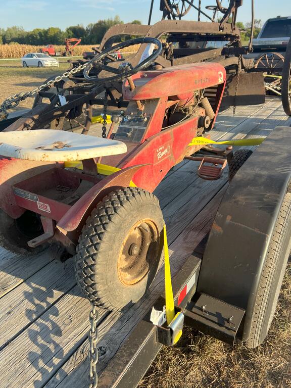

ksellers 6 #1 Posted September 16, 2023 This week I purchased a wheel horse tractor at an auction for my boys. Since purchasing, I have done research on them and have a few questions I hope someone can assist with! What is the exact model of this one? It has an H60 engine on it, however, I am not able to find a tag anywhere on it. When I purchased it, the transmission was locked up. I found that it was dry and just needed some assistance getting the pulley spinning, what kind of oil does everyone run in their transmissions? Is 90 weight acceptable? After getting it home, I took off the recoil starter and cleaned out the mouse nest, I checked it for spark and it doesn't seem to have any. Are parts readily available for these or should I consider a powerplant change? Thanks in advance! 20230915_222044031_iOS.heic 20230913_231948780_iOS.heic 3 Share this post Link to post Share on other sites
pfrederi 18,180 #2 Posted September 16, 2023 (edited) Welcome Apple pictures are hard for some here to see/download. You have an early Lawn Ranger. 1962-1964 probably someone will have a better guess Edited September 16, 2023 by pfrederi 5 Share this post Link to post Share on other sites
gwest_ca-(File Mod) 11,176 #3 Posted September 16, 2023 Anything here? 3 Share this post Link to post Share on other sites
WHGuy413 2,769 #4 Posted September 16, 2023 (edited) Welcome! Definitely a lawn ranger. The Tecumseh h60 is correct I believe. You can still purchase all new electronics for them. I found my last stuff on ebay. All the electronics are located under the flywheel. Setting the timing can be a bear but there are some great videos on YouTube. Edited September 16, 2023 by WHGuy413 1 Share this post Link to post Share on other sites
Achto 28,190 #5 Posted September 16, 2023 Nice Lawn Ranger! 80 - 90wt or 90wt oil for the transmission will work great. Looks like others have you covered on where to search for ignition parts. 1 Share this post Link to post Share on other sites

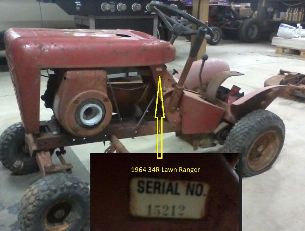

gwest_ca-(File Mod) 11,176 #10 Posted September 17, 2023 2 hours ago, ksellers said: I did find the serial number, it appears to be 72360. Is the serial number similar to the postage stamp in the above picture? Is it possible the serial is A-72360? 2 Share this post Link to post Share on other sites

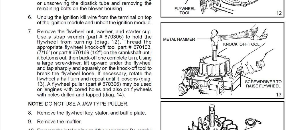

pfrederi 18,180 #12 Posted September 17, 2023 You do not use a puller for Techy flywheels. Service manual click on picture to get it 3 Share this post Link to post Share on other sites

ksellers 6 #14 Posted September 17, 2023 10 hours ago, gwest_ca said: Is the serial number similar to the postage stamp in the above picture? Is it possible the serial is A-72360? You are correct, it is A-72360, I missed the A when looking at it last night. 1 Share this post Link to post Share on other sites
ksellers 6 #15 Posted September 17, 2023 1 hour ago, pfrederi said: You do not use a puller for Techy flywheels. Service manual click on picture to get it Thank you, I will look into getting the knock-off tool Share this post Link to post Share on other sites
gwest_ca-(File Mod) 11,176 #16 Posted September 17, 2023 Click on the picture in the link In 1962 Wheel Horse started using a 62-xxxxx serial for tractors and a A-xxxxx for the attachment serials. They used up the unused serials in the following years. 3 Share this post Link to post Share on other sites

oliver2-44 10,075 #18 Posted September 18, 2023 On 9/16/2023 at 3:26 PM, pfrederi said: @ksellers I noticed the oily rear rim which suggest it needs rear axle transmission seals and possible axle bearings. With the tractor jacked up and the rim & tire removed check if you can move the hub/axle up/down any. Any movement more than a tiny tiny bit indicates the bearings are worn. If you just replace the seals and have worn bearings the new seals usually don’t last very long. The good news is you can drive it around awhile with a slight seeping seal. When the time comes these transmissions are not hard to rebuild and there are videos on here by our own Stevasarus showing how to do it. PS. Don’t use a 3 jaw puller on those axle hubs, they will break. When your ready, ask and the guys will show you how to pull hubs. 2 1 Share this post Link to post Share on other sites
