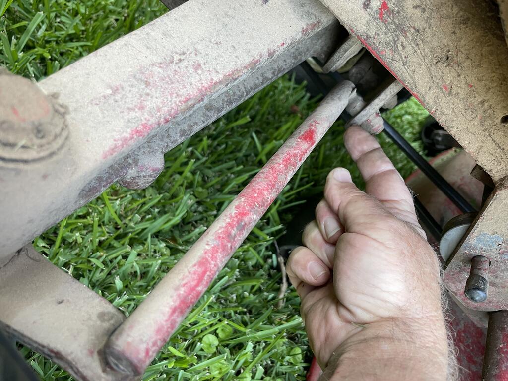

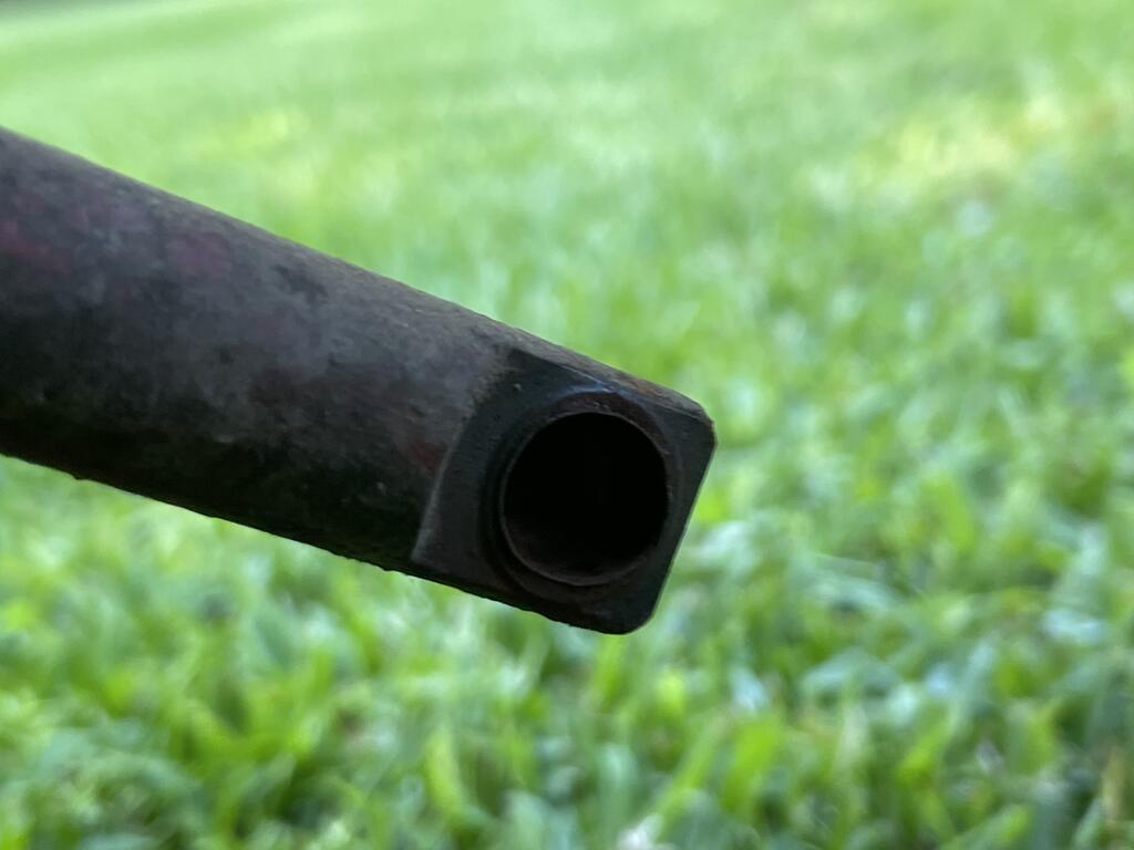

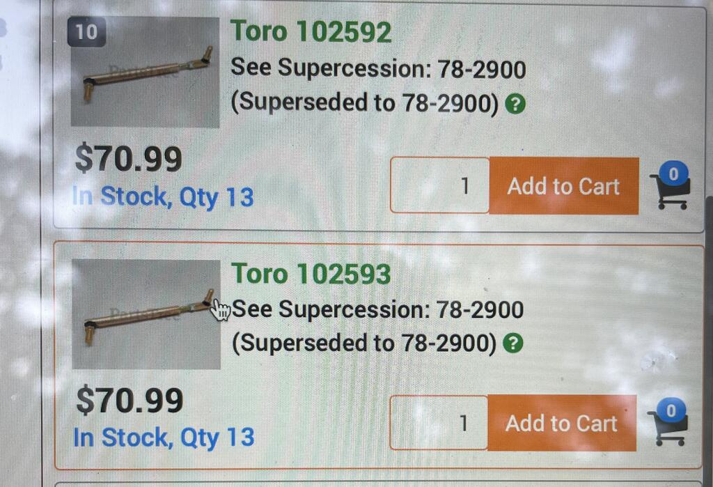

heysavoy 19 #1 Posted September 15, 2023 Hi. I am hoping someone can help me? I have a 1990 WH tractor Model 31-12KE01 and while cutting today my steering stopped. Image 3672 is after I had put it back on but of course it didn't stay after making another turn or two. One of the rods came out. (IMG 3675) I believe this is called a tie rod? Am I correct? If so it seems these are the two parts (see image # 3676 below) I need to have replaced. (One works but shouldn't I go ahead and do both?) If it's not necessary to replace both... which part # is the one on the left if you are sitting in the driver's seat? They look the same to me. If not the correct part # does anyone have the correct one? I appreciate any assistance you can give me. This site has been awesome as It's given me the confidence (with a little help) to make some repairs in the past I never thought I could. 2 Share this post Link to post Share on other sites
ri702bill 8,968 #2 Posted September 15, 2023 Yes, BOTH sides need to be replaced. due to age and one potentially catastrophic failure. No room for Band-Aids.... Some of us (me) and others make our own using Heim joints. Lowell in the Vendors section sells quality modern replacements. Adjustable length, modern tech. is the only way to go... Bill 2 Share this post Link to post Share on other sites
ebinmaine 70,725 #3 Posted September 15, 2023 $71 EACH??? Yeah definitely get ahold of Lowell at Wheelhorse Parts And More. 3 Share this post Link to post Share on other sites

Achto 28,777 #6 Posted September 16, 2023 (edited) 1 hour ago, heysavoy said: They look the same to me. If not the correct part # does anyone have the correct one? Here is a direct link for Lowell's tie rods $58 for the pair. They also have replaceable ends that are available at most hardware stores for the next time they need replacing. https://wheelhorsepartsandmore.com/product/toro-wheel-horse-tie-rod-78-2900-78-290001-longer-length-with-replaceable-ends-with-nuts/ For a temporary fix you can remove your old tie rods, place the ball back in the hole, & hammer the side down to keep the ball from popping out. Will get you through until your new ones arrive. Edited September 16, 2023 by Achto 1 1 Share this post Link to post Share on other sites

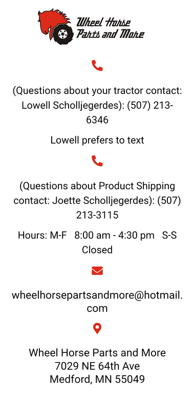

ebinmaine 70,725 #7 Posted September 16, 2023 13 minutes ago, heysavoy said: I'm not familiar with that portion of the site. How do I get hold of him to make sure I'm ordering exactly what I need? Thanks Eric!! From the main page scroll down to Classified, Vendors, Wheelhorse Parts And More. Open their site. Here's a cut/paste of the contacts. 2 Share this post Link to post Share on other sites
Sparky-(Admin) 22,058 #8 Posted September 16, 2023 8 minutes ago, Achto said: For a temporary fix you can remove your old tie rods, place the ball back in the hole, & hammer the side down to keep the ball from popping out. Will get you through until your new ones arrive. Temporary Dan? Lol! I had one that I repaired like that and it worked for years. Put a smear of grease in the socket first, then peened it….keeping it greasy 2 2 3 Share this post Link to post Share on other sites
