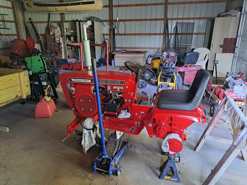

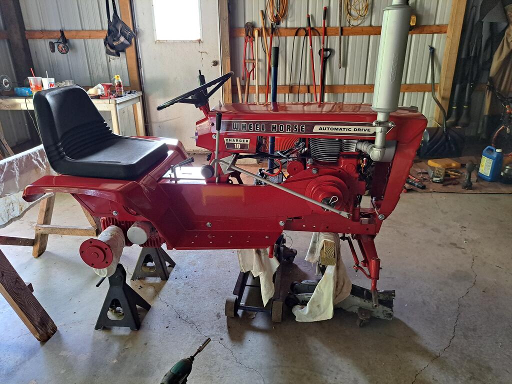

Mike_eash 59 #1 Posted September 14, 2023 Hello guys I recently restored a charger 10 my first restoration. I am done except for the wheels which I am having powder coated. I am happy with how it turned out However I used rust oleum spray paint a decision which I am now regretting because it seems like it scratches way to easily My next restoration will not be spray paint However since I can't change it now my question is there something I can do to preserve this paint job? I have heard putting certain oil on it helps preserve but I am not sure Any input would be great!! Thanks in advance 5 4 Share this post Link to post Share on other sites
