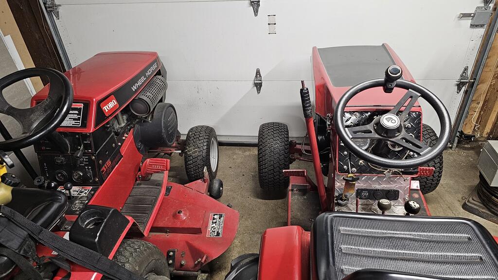

bds1984 1,466 #26 Posted September 13, 2023 20 hours ago, Handy Don said: The reduction steering can, with some effort and tweaks, go into pretty much any 300, 400, 500. It expects a swept front axle (with its 1” spindles), with its slightly different geometry. One noticeable effect is that the steering column is more vertical. Another is that it gets crowded at the base of the hood stand! There really aren't any tweaks to putting in a gear reduction system into anything else as long as you have the complete system, it was pretty much bolt and go. The most difficult aspect for my ride's gear reduction steering install was removing the original steering wheel. I just cut the steering shaft after asking nicely too many times. I figured that steel can be too demanding if it is a liquid. As far as the more vertical position of the steering wheel... I've never observed any difference between the two. Left is my 315-8 and right is my C165 with a complete 520H reduction set up. Anyways, if I had to choose, I'd go for the 520H with the reduction. I have both, and there are days I wish my straight axle 520 had that feature. 1 4 Share this post Link to post Share on other sites
