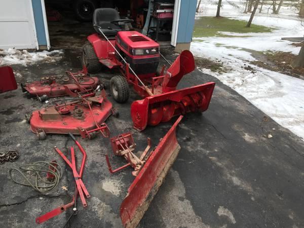

squonk 42,533 #4 Posted September 4, 2023 (edited) I had a 210-H for 20 years and plowed snow and leveled 15 ton of gravel with it. by the looks of your pics you are missing the angle control lever. Look at this picture. It's from an ad the guy I sold the tractor too put up a couple of years ago. The bent lever on the ground with the black grip is the angle control Edited September 4, 2023 by squonk 2 Share this post Link to post Share on other sites
TC10284 111 #5 Posted September 4, 2023 1 hour ago, squonk said: I had a 210-H for 20 years and plowed snow and leveled 15 ton of gravel with it. by the looks of your pics you are missing the angle control lever. Look at this picture. It's from an ad the guy I sold the tractor too put up a couple of years ago. The bent lever on the ground with the black grip is the angle control Thanks for the heads up. I'll see if I can find one here or in FB groups. 1 Share this post Link to post Share on other sites

TC10284 111 #8 Posted September 5, 2023 From what I can tell by looking at the parts breakdown, I am just missing part 51 - the handle. Share this post Link to post Share on other sites
