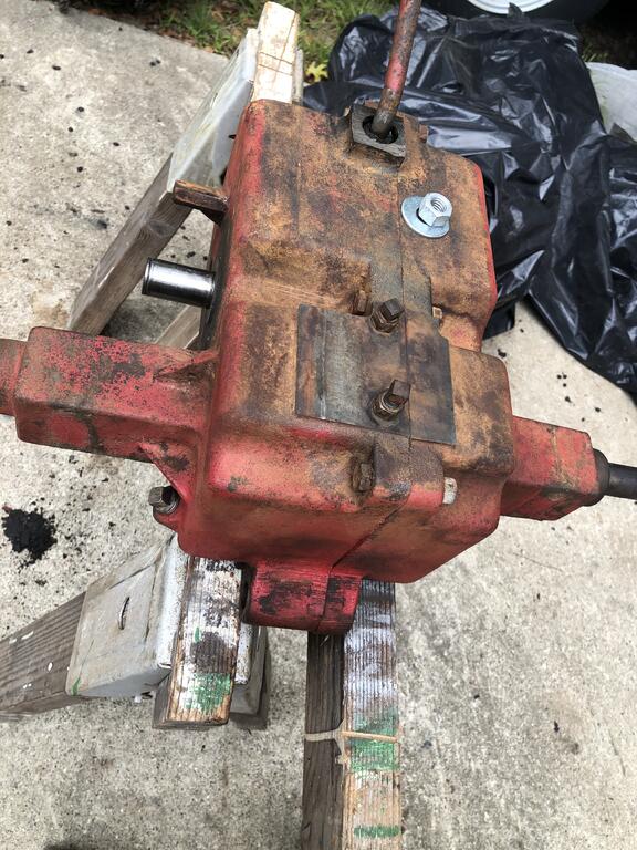

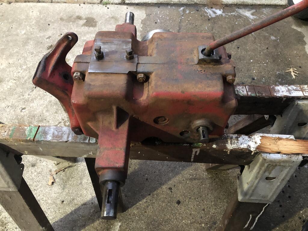

Rob J. 1,942 #1 Posted September 3, 2023 I know everyone has their favorite way to get these things out. I’m in the process of rebuilding a 3-speed tranny and have worked on hitch pins before. A lot of heat and banging seemed to be involved. So I got to thinking as I have never seen this way done before, although I’m sure it has, in using a ball joint press. It took me 5 minutes, only a couple smacks with the hammer and the pin isn’t all marred up and reusable. The beauty of this method is it’s portable and not a stationary press. Gitty up! 3 1 Share this post Link to post Share on other sites

Handy Don 12,826 #5 Posted September 3, 2023 Well done! Everyone needs a set of beater sawhorses! A lot of pin removal depends on what part is stuck. The slot hitch arms (in my case) or the part in the transaxle case. I was able to use a BIG clamp on a big nut over one end (hole bigger than the pin) and a small washer (slightly smaller than the pin) on the other end. Pressure, penetrant, propane, and patience. On the third day of adding a bit more pressure it popped. 4 Share this post Link to post Share on other sites
WHX?? 49,581 #6 Posted September 3, 2023 You lost me Rob I guess I don’t know or have never used a ball joint press. Got a picture of it in action? 2 Share this post Link to post Share on other sites

Rob J. 1,942 #9 Posted September 3, 2023 1 hour ago, WHX?? said: You lost me Rob I guess I don’t know or have never used a ball joint press. Got a picture of it in action? What Ed said. I didn’t take pics or a video mainly cause I wasn’t sure it would work. 😂 Mine was stuck in the tranny. The hitch was stuck too and was able to move it with a rubber mallet. 2 Share this post Link to post Share on other sites

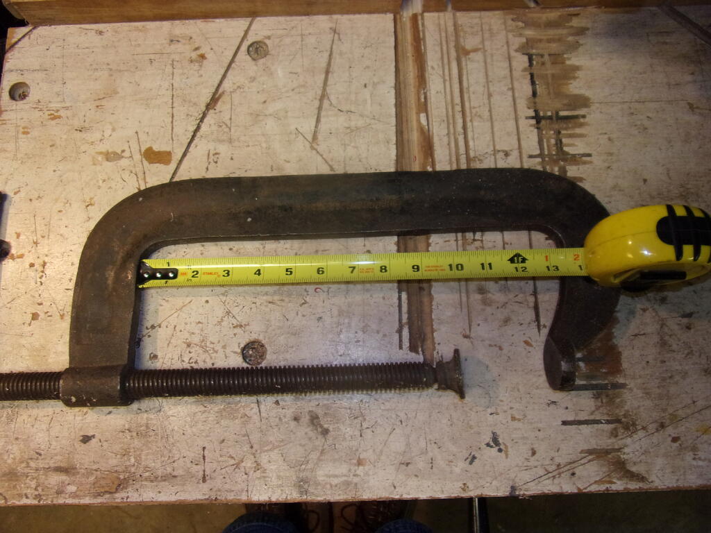

Ed Kennell 39,415 #11 Posted September 3, 2023 Here's my portable press. Hargrave #44 12" made by Cincinnati Tool USA. Used to press pins, straighten plow blades, frames, augers, etc. 4 2 Share this post Link to post Share on other sites
ri702bill 8,614 #12 Posted September 3, 2023 1 hour ago, Ed Kennell said: Hargrave #44 12" made by Cincinnati Tool USA. And looks to have a finer pitch ACME squareform thread - really rugged....worlks best with a coating of light oil... 2 1 Share this post Link to post Share on other sites
