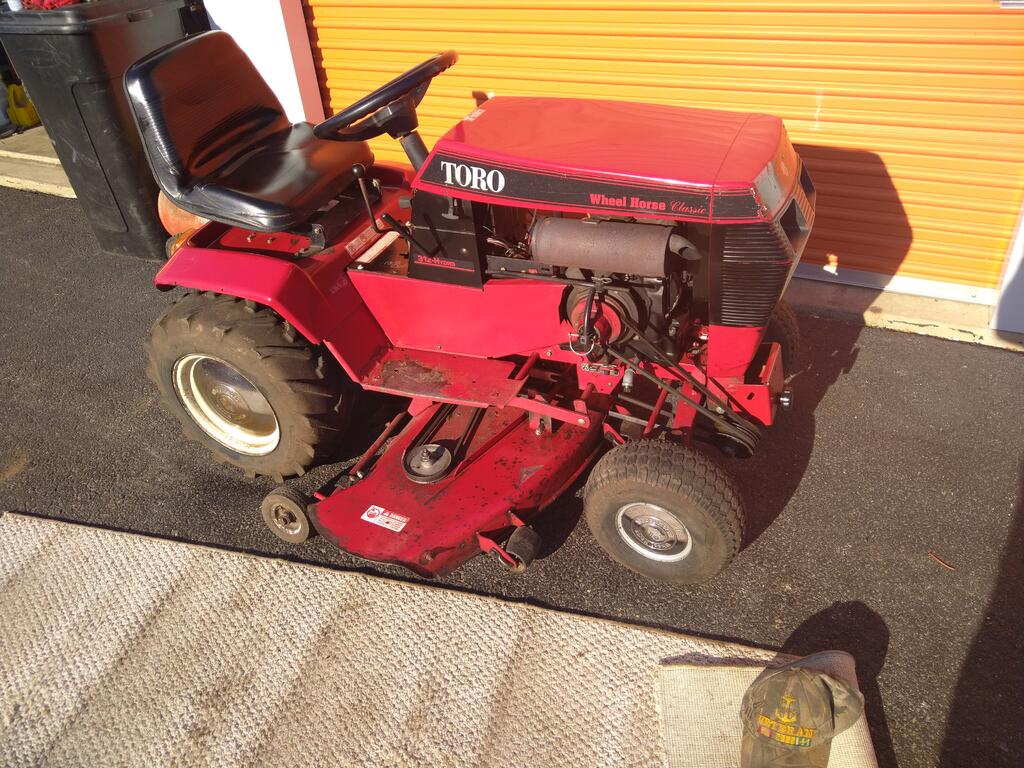

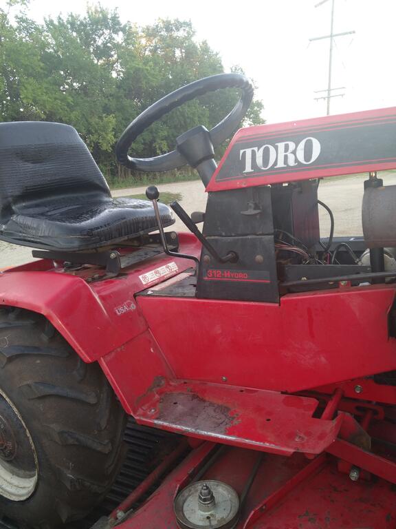

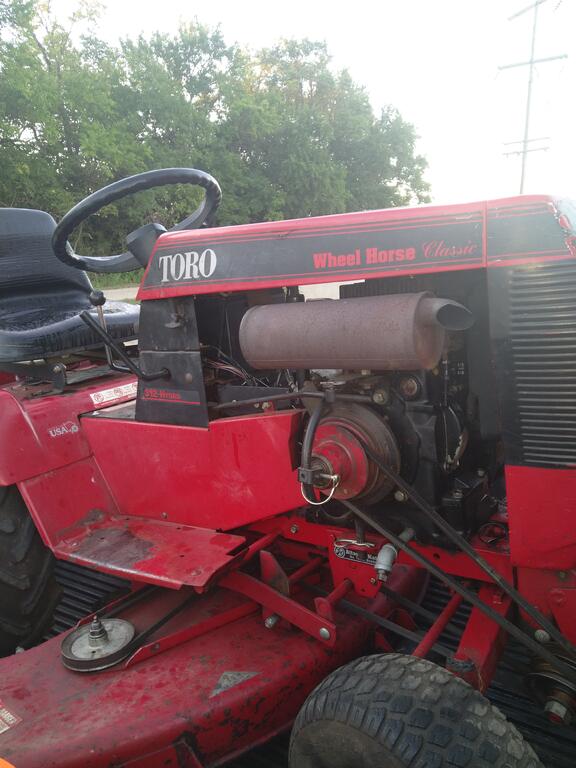

BPEisenhower 538 #1 Posted September 2, 2023 Hello all! Been busy this year but I'm still around. Like a dummy, I picked up a cheap 312 that hasn't ran in 3 years due to electrical problems. The plus side is I bought it with the books, bill of sale and from the original owner that put it in the corner of his shed saving it from being outside.The choke cable is stuck and throttle cable is so loose that it falls on it's own. After draining old fuel, changing oil, cleaning All the grounds, and putting safety switches in the correct places, I got it to wake up. So, a bath was next then a rub down with fluid film. Might as well see if it works. I mowed for 3 hours and no problem. However, how do I get the deck to raise higher? The rear gauge wheels drag the ground. It seems no point to even raise or lower it anyway. Tractor is way too small to fit me and told the other half that it's being sold since I do not want a roller skate. She informed me that she is little and she is going to keep it. Didn't know my tractor was her idea..... Fine! Since SHE is the proud owner that means only one thing, I can sell the other tractors I don't like and find a 520! 1 4 Share this post Link to post Share on other sites

8ntruck 7,380 #3 Posted September 3, 2023 Good find. As far as lifting the deck, check the lift link. Some of them are a threaded rod with a trunion that can be adjusted up and down on the lift rod to adjust the lift height. When the deck is in the up position, there are a couple of rubber bumpers that should contact the frame. Good luck and have fun. 1 1 Share this post Link to post Share on other sites
c-series don 9,425 #4 Posted September 3, 2023 On the deck there’s a bolt on either side of it, right behind where you hook up the deck to the tractor. It’s in a slot, I see yours in the bottom of the slot. Move it to the top and you should see the rear wheels come up. Sorry I don’t know how to circle the bolt in the picture, I’m not that tech savvy! 2 Share this post Link to post Share on other sites

peter lena 9,087 #6 Posted September 3, 2023 @BPEisenhower easy to remove dash face , 4 Philips screws , that will give you a easy view of what's going on , get your aerosol lubricant in the movement areas , make the rust run out , watch / look at intended function , firm up sloppy lift areas / added flat washers . get some help to operate lift , so you can watch what's going on. would also clean out / sharpen / lubricate deck, a higher setting will also assist in deck discharge , cut down on build up . Pete 1 Share this post Link to post Share on other sites

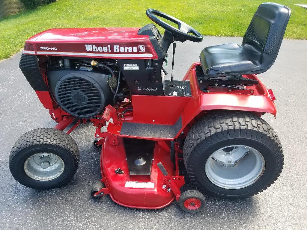

Brockport Bill 1,824 #10 Posted September 3, 2023 if you actually want a "bigger" WH than the 312 -- then get a 520HC rather than a 520H --- the HC is actually wider and longer -- not much, but by couple inches Share this post Link to post Share on other sites
Brockport Bill 1,824 #11 Posted September 3, 2023 37 minutes ago, Brockport Bill said: if you actually want a "bigger" WH than the 312 -- then get a 520HC rather than a 520H --- the HC is actually wider and longer -- not much, but by couple inches here is photo of "bigger" 520HC --- only a couple inches --- but typically the HC's also have the slider seat to give operator more room to slide seat back -- of course you can put the seat sliders on other wh seats 1 2 Share this post Link to post Share on other sites
