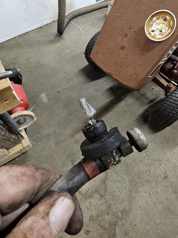

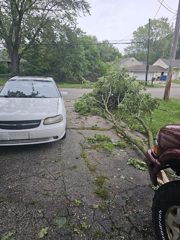

We got hit by a tornado on Thursday here in Grand Rapids, MI.  I had a lot of cleanup to do a tree and lots of limbs no major damage..   got the b60 out to tow firewood and pull some logs around.  here are some pics of Friday..   today I went to fix the choke cable and found the grommet all dry-rotted on the bottom of the tank and the cable was not fixable.  what a Bummer waiting on parts now!

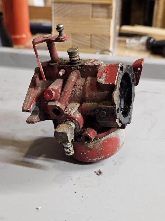

Jay hope all is well. Looks the B60 did well. If you are handy those are easy fixies on carb and tank parts. Try and find good fuel line = not soft black rubber.It is getting hard to find good line today at the auto part stores because of EFI. Good line I found at Napa is about $8 a foot.
Edited by Retired Wrencher
Good to see you're ok.
That carb is special to 16 HP and some 14.
You'll need a rebuild kit. Easy to do.
Check the top pivot at the throttle shaft for looseness. That can be repaired.
IMHO you're FAR better off rebuilding the OE type than considering an aftermarket one.
If you can wait a couple weeks to get it done, send it here. I rebuild them.
It's great to see someone putting one of these old beasts to work like we do here.

@Jayoutdoors  use some  SUPER LUBE  or dielectric silicone grease  on that tank grommet , makes for a much easier  slide in fit , and grommet will sit in place easier . that liquid super lube , is also great on cables , makes them work much easier . pete
