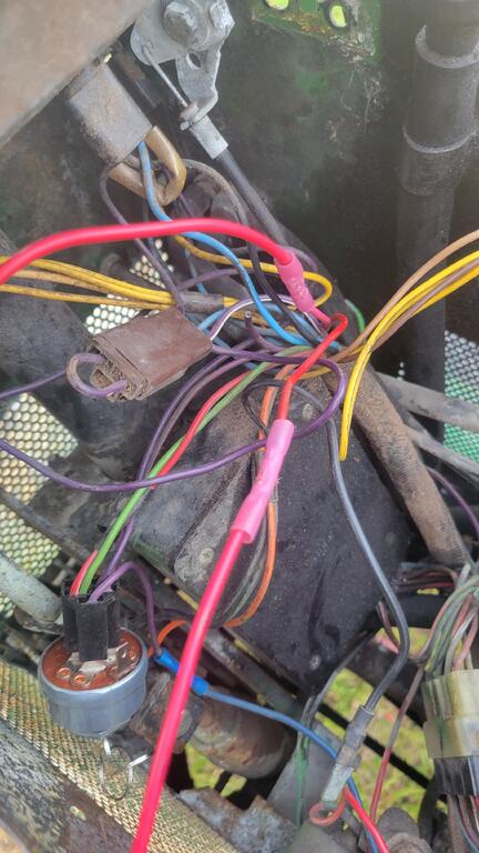

RED-Z06 2,430 #18 Posted August 27, 2023 55 minutes ago, Handy Don said: I’ve long admired the 425 & 445 as well as the 318 for their capabilities. They really hit it out the park with the 318/420/430, and 4x5 series. So capable yet not complicated to work on. After redoing the 9 pin connector on my 416-H...id rather pull the engine out the 318 and rebuild the driveshaft again, it was easier Share this post Link to post Share on other sites
Handy Don 13,146 #19 Posted August 28, 2023 2 hours ago, RED-Z06 said: yet not complicated to work on I think this is because you have lots of exposure to JD stuff. The 318’s electronics issues and the PTO or mule being located so low in front were not stellar, in my view (hence the PTO driveshaft in the later models). Also, you have to do a lot of disassembly to get deep into any of theses models--they are tightly packed. If electrics aren’t your thing, the 9-pin is intimidating but compared to pulling an engine and rebuilding the driveshaft? I’ll take the electrics, thanks! Share this post Link to post Share on other sites
RED-Z06 2,430 #20 Posted August 28, 2023 25 minutes ago, Handy Don said: I think this is because you have lots of exposure to JD stuff. The 318’s electronics issues and the PTO or mule being located so low in front were not stellar, in my view (hence the PTO driveshaft in the later models). Also, you have to do a lot of disassembly to get deep into any of theses models--they are tightly packed. If electrics aren’t your thing, the 9-pin is intimidating but compared to pulling an engine and rebuilding the driveshaft? I’ll take the electrics, thanks! Its intimidating to look at but its really easy. Slip the pto belt off the front (4) 1/2" bolts with speed nuts hold the hood and hood stand on, it lifts off. (4) 7/16 bolts hold the shaft on..they are accessed from the left side. Unplug 5pin plug Unhook fuel line from onan pump Unplug the starter wire and 12v power from starter. (4) 9/16 bolts hold the engine down from below (back 2) and above (front 2).then the engine can be tilted forwards...and the Shaft slides out. Takes about 25 minutes to get the engine and shaft out from "running". And about 25 minutes to rebuild the shaft. It took me 3 hours to fail to do my 9 pin and end up doing it as individual bullet connections...there was just 0 room between the engine and dash and 0 extra wire. I haven't seen any real electronics on my 318 or 420, the time delay module is there on both but even my 318 that sat a decade in a field started right up. The wiring is surprisingly on the nose once you realize the wiring scheme. The oil light for example..12v applies to the light at key on, and the oil switch is grounded below 4psi..so it illuminates at key on until the ground goes away. Here is the bulk of the wiring harness in the 318, previous owner hardwired both fuses direct by cutting them out so i added new ones...that powered up everything. Share this post Link to post Share on other sites
