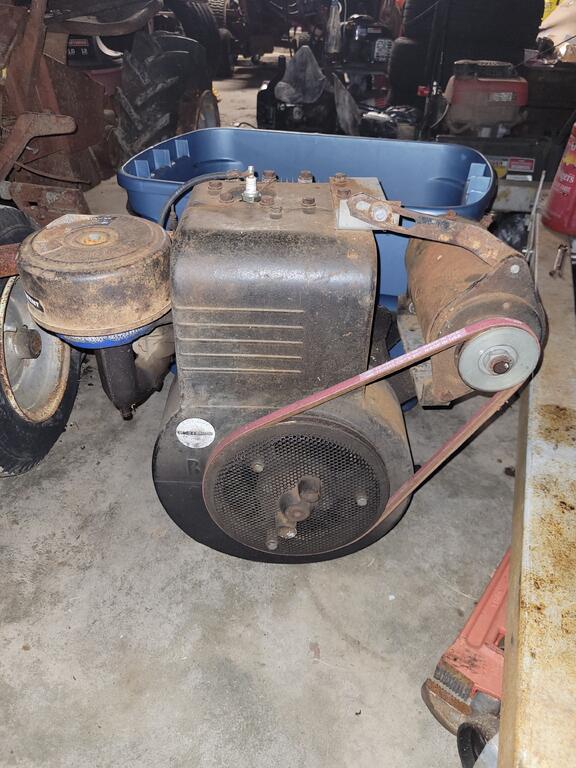

It's 23D 0129.  I'll get some pictures in a bit.  Would it be too much for a 552 that has already been repowered with a Wisconsin?

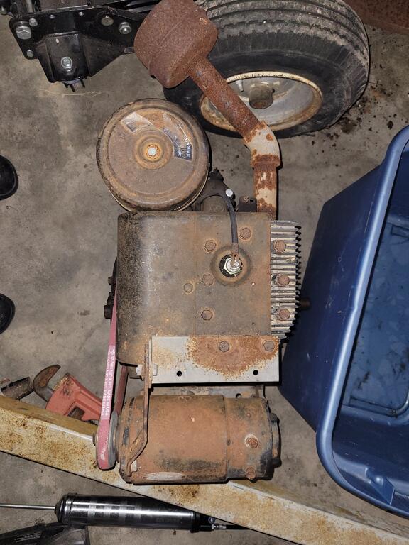

Vinco
On 8/26/2023 at 2:48 AM, ebinmaine said:
If it's the BIG single cylinder older Briggs...
It is.  It's 18" tall from the floor to the top of the shroud.  The Wisconsin ACN that's on the tractor is 14".  I don't have any Kohler singles so I don't have a practical concept of scale to compare those.  It weighs a LOT!  I can barely pick it up by myself,  though that's not saying all that much,  as I have lost a huge amount of strength over the last 2 years because of medical stuff.

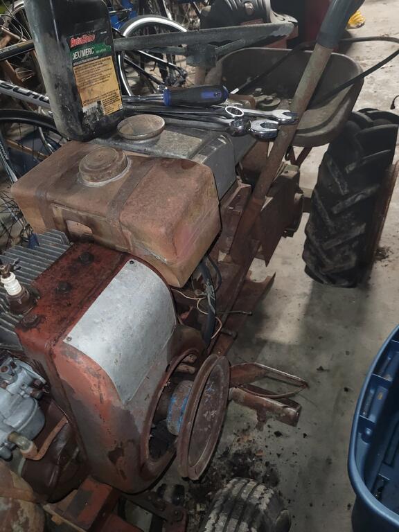

On 8/25/2023 at 5:22 PM, Vinco said:
Is there a Wheel Horse that came from the factory with a Briggs 23D engine?  I acquired one today that runs.
Got any pics of this?
Vinco
I measured again.  The Briggs is 18" tall, but the Wisconsin ACN is actually just 14" tall.   It sits on a 1" spacer on the 552 frame,  and with that the crankshaft centerline is about 4.25" up from the frame.  The Briggs crankshaft centerline is about 6.25" off the floor. So it will likely not be a good fit on the 552 because of the belt drive.  Peek at the 552 in the last picture.
