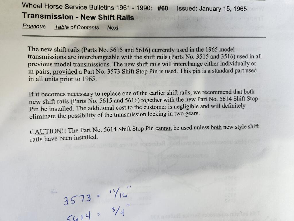

Racinbob 11,398 #4 Posted August 21, 2023 Actually @Lane Ranger just it's the rails that are different. The forks remained the same. The early rails are 3515/3516 and were upgraded to 5515/5516. The shift stop pin (3573) needs to be replaced with a slightly longer 5614 pin. The 3573 pin could be used but you wouldn't get the benefit that the upgraded rails provide. The spring and balls remain the same. 1 1 1 Share this post Link to post Share on other sites
