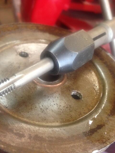

JoeM 7,882 #5 Posted August 20, 2023 Something I have done is tap the two holes in the pulley and used a puller. At the same time I also took window/door shims and tapped them snug under the pulley. Once you get some tension on the puller give the center puller screw a few taps with a hammer. Heat and quench with WD first. 4 Share this post Link to post Share on other sites

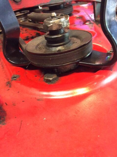

peter lena 8,960 #6 Posted August 20, 2023 @Brockport Bill this is what you do , rebuilt a number of decks , note in first photo , the pry bar rocker is under the pulley on top of the spindle housing bolts , up against the center shaft mount , strongest spot on pulley , 2 levers , pushing in oposett directions , pops that right off , also note in last picture , look at the added flat idler pulley I added to the unsupported drive belt ? also use lucas green grease on / in every related bearing . my decks are quiet , smooth and no bearing whyining . pete 2 Share this post Link to post Share on other sites

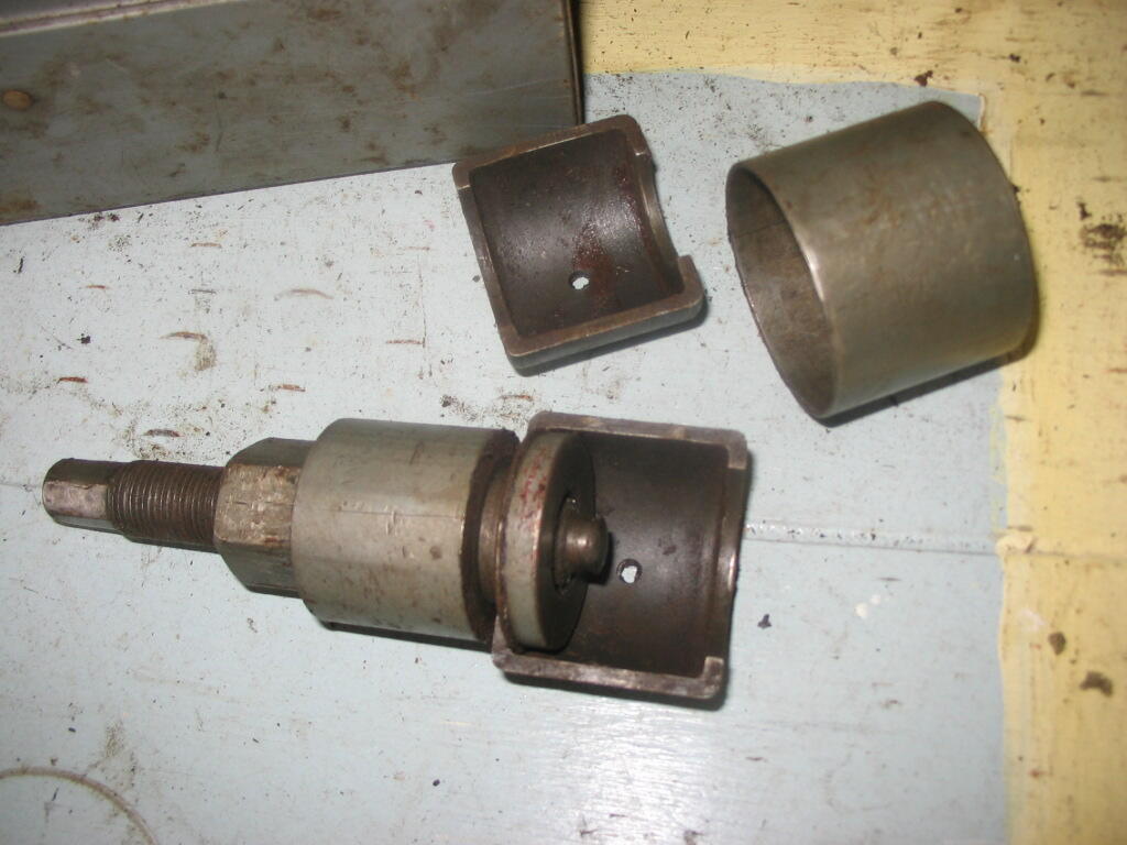

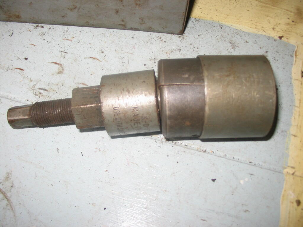

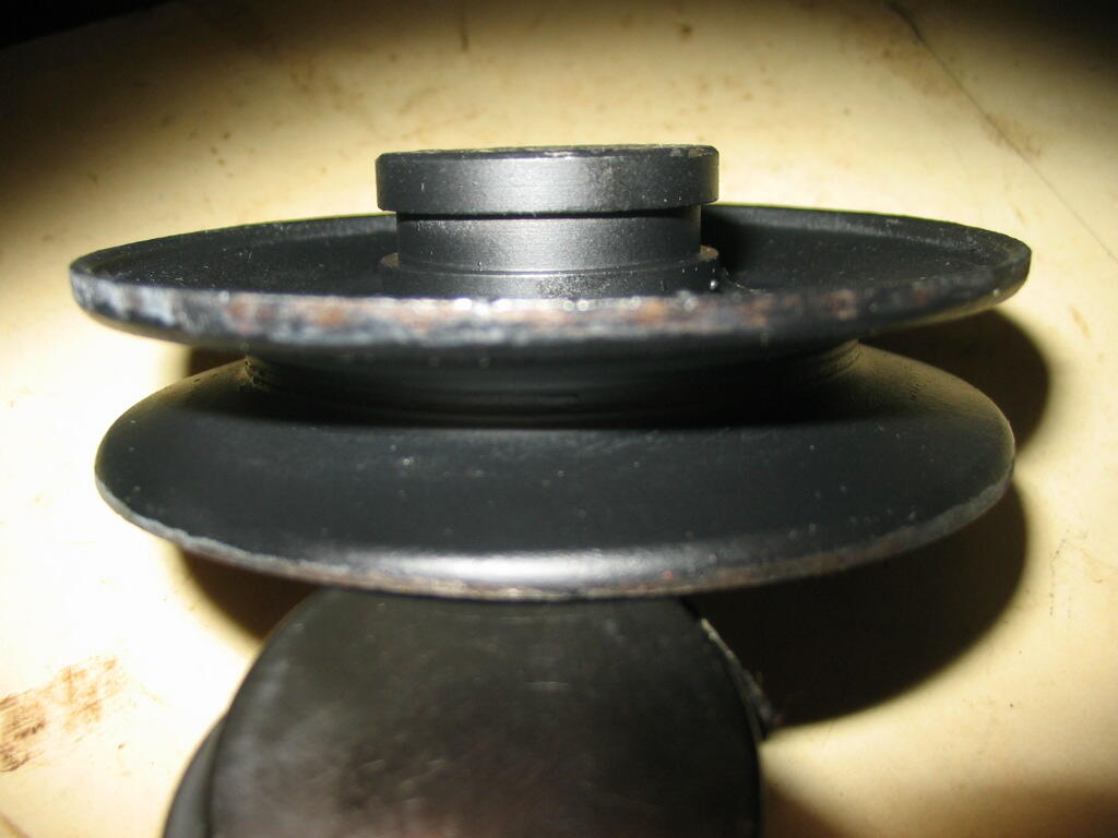

daveoman1966 3,766 #8 Posted August 20, 2023 If your side pulleys look like this...with a 'lip' on the top edge, rent a 'Power Steering Pump Pulley' puller tool. Free rent if returned undamaged. It'll show how to use the tool. The tool looks like this: It locks on to that top lip and pulls the pulley off. The two pry bars method shown here MAY work...but the right tool will guarantee removal. If your pulley does NOT have that 'top lip'.... see my next post. 4 Share this post Link to post Share on other sites
daveoman1966 3,766 #9 Posted August 20, 2023 To remove a stubborn pulley that doesn't have the 'top lip'. Try this...(having removed the blade): 1) Set the bottom side of the spindle into the hollow of a cement block...leveling the other side of the deck, of course. 2) Put the TOP NOT on the spindle shaft and thread it to LEVEL with the shaft top threads. 3) Hold the flat side of a ball peen hammer onto that top nut which MUST be level with top of shaft. 4) Using a BFH, whack that ball peen hammer ---like you got a pair. 5) All you gotta do is break loose the pulley....then it'll lift right off. 6) when it breaks loose, remove the nut and pulley.... PRESTO ! Pulley off and shaft threads not damaged. 5 Share this post Link to post Share on other sites
