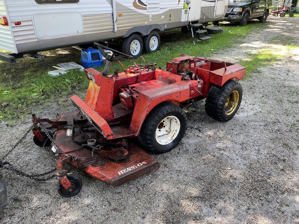

JunkyGMT200 7 #1 Posted August 16, 2023 I bought what I thought at the time was a Toro GMT200 with a 60” deck at an auction for 100$ I got it home and pulled the cylinder head the seized Kohler K-532 and found this horror scene: After a little cleanup I found the bore was only slightly pitted, and I got the engine moving but it was stiff. Here is the right side: Here is the Left: I oiled the bores and got it spinning freely. I got looking at it, and there is orange paint and Hesston decals under the red paint and the Toro decal, the deck also says Hesston on it. The serial number tag is gone, Is there a way to know for sure what it is without that? The engine tag is also destroyed. Any way to find the year? Does anyone have or know where to get a service manual for this unit? Does the power steering pump have a separate reservoir or does it use the trans oil? Is the valve and set of lines factory? If so what did it run? Any help is appreciated, Tommy. Attachments IMG_1775.jpeg 1.6 MBViews: 11 IMG_1782.jpeg 1.8 MBViews: 11 IMG_1783.jpeg 1.9 MBViews: 10 2 Share this post Link to post Share on other sites

JunkyGMT200 7 #7 Posted August 17, 2023 (edited) Thank you for all of the help thus far. I have a theory that mine used to have a back portion that was a bagger, because mine has the extra hydraulic valve and it has a perch for the blower. But then someone put the back half off of a Toro on it because under the poorly painted red and The Hesston orange is Toro red. On a side note it got a bath. Edited August 17, 2023 by JunkyGMT200 3 Share this post Link to post Share on other sites

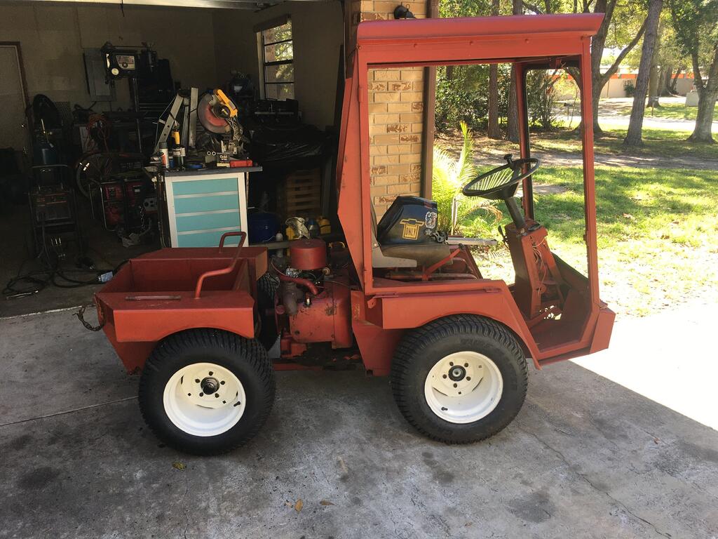

19richie66 17,820 #9 Posted August 17, 2023 This was mine. 2 4 Share this post Link to post Share on other sites
