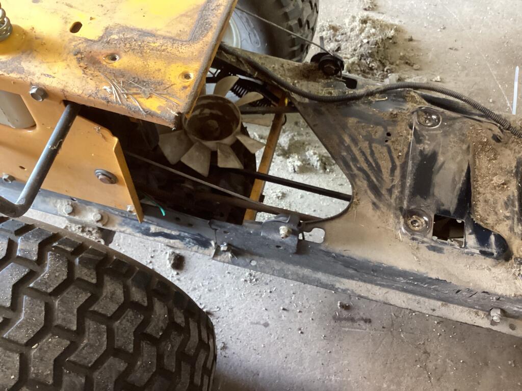

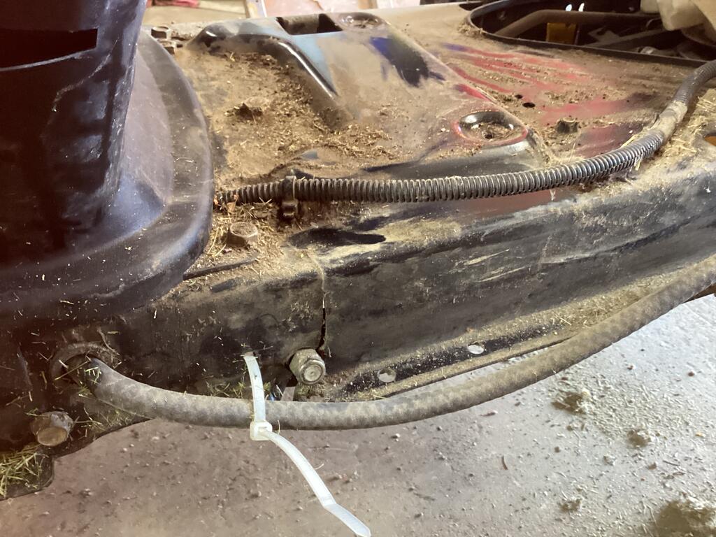

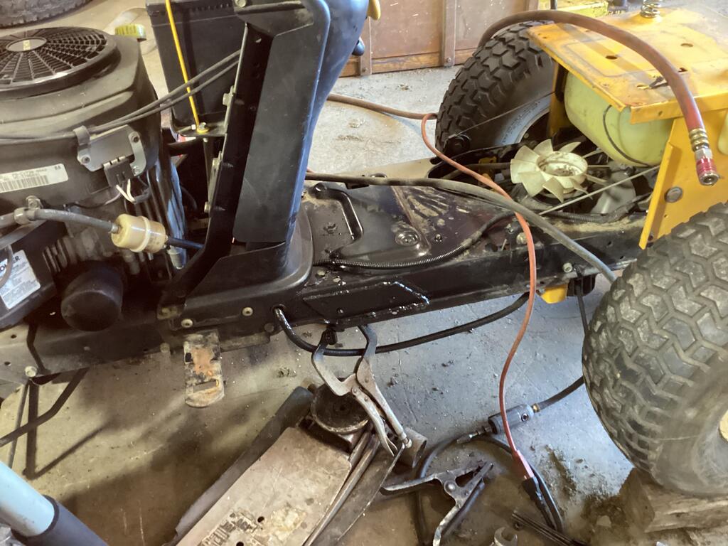

Pullstart 64,484 #1 Posted August 11, 2023 We all seem to share the common ground on quality standards, that’s why we are on the Wheel Horse Forum! I have this CC Stamped frame mower here, one of my volunteer homes for Project Evergreen / Green Care for Troops. This mower runs great, and all things considered, mows very well. The wife of the Master Sergeant deployed overseas told me something was wrong with the mower, but she didn’t know what exactly. I told her I’d mow with it, get a feel for things that might need attention, and work on it at home for free, just cost of parts. One of the main issues was the very slow reverse. Another, was the deck wouldn’t lift very far in the front. I think I found the issue. Both sides of the “frame” are cracked. The right side, it’s cracked right through. The left side, is split up the side and up to the horizontal plane. The reverse is a push rod, which makes the crack wider, which explains the slow reverse. The low lift is explained because the belly of the frame is extending down to meet the deck. I have every confidence in welding the cracks and the welds holding. I have very little confidence in the frame staying put throughout the rest of the chassis. I thought of a fish plate on the cracks. I thought of a full 1/8” plate on both sides, stitch welded in place. All this work is pro-bono. I have a call in to the wife to see if she wants me to proceed. I may just end up bringing a Horse with a 36” RD to their house and let them think on the outcome of this mower. Oh boy, I didn’t think the repairs would be this demanding! 3 1 Share this post Link to post Share on other sites

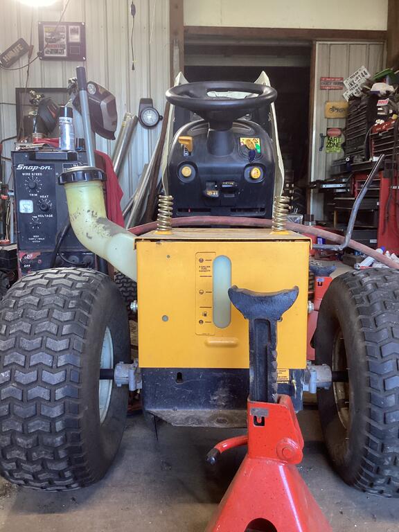

Pullstart 64,484 #2 Posted August 11, 2023 From the rear, you can see the center lean from the forward/center left side split. It’s not good at all. 1 1 Share this post Link to post Share on other sites
Pullstart 64,484 #3 Posted August 11, 2023 I spoke with the Mrs. on the phone. She said they picked it up fairly cheap from her FIL and it’s not worth investing in. I’ll bring a loaner over for the rest of the summer, that I can use and let them decide what to do for next mowing season. I’ll be getting seat time on a too, so it’s a win! 4 Share this post Link to post Share on other sites

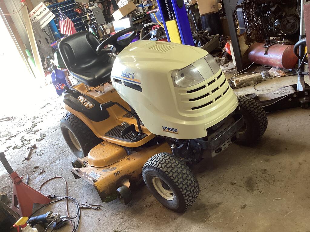

Pullstart 64,484 #10 Posted August 11, 2023 50 minutes ago, ri702bill said: I disagree - it is worth his time to breathe a lit of life into this one. NOT a WH, never will be...... if the fix does not work, move on to parting it...... Before I saw this, I made that call as well. I’m NOT spending any money, or charging any at least. The fish plate is thicker than the “frame” I’ll do the same treatment on the other side. 2 2 Share this post Link to post Share on other sites
SylvanLakeWH 27,498 #11 Posted August 11, 2023 (edited) Appears pretty accessible... Why not just weld up with a small plate / flat bar along frame and get it rolling for another couple seasons? Something else needed? Edit - you typed faster than me... Edited August 11, 2023 by SylvanLakeWH 2 1 Share this post Link to post Share on other sites
Pullstart 64,484 #12 Posted August 11, 2023 20 minutes ago, SylvanLakeWH said: Appears pretty accessible... Why not just weld up with a small plate / flat bar along frame and get it rolling for another couple seasons? Something else needed? Edit - you typed faster than me... Their grass grows VERY SLOW. I decided it was worth trying for the rest of the season anyway. 2 Share this post Link to post Share on other sites

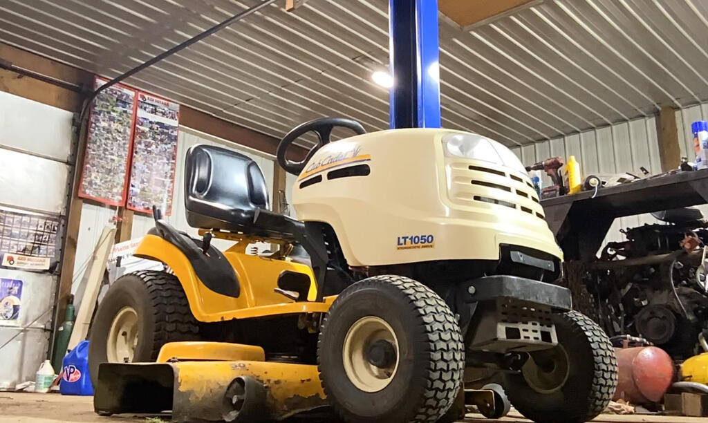

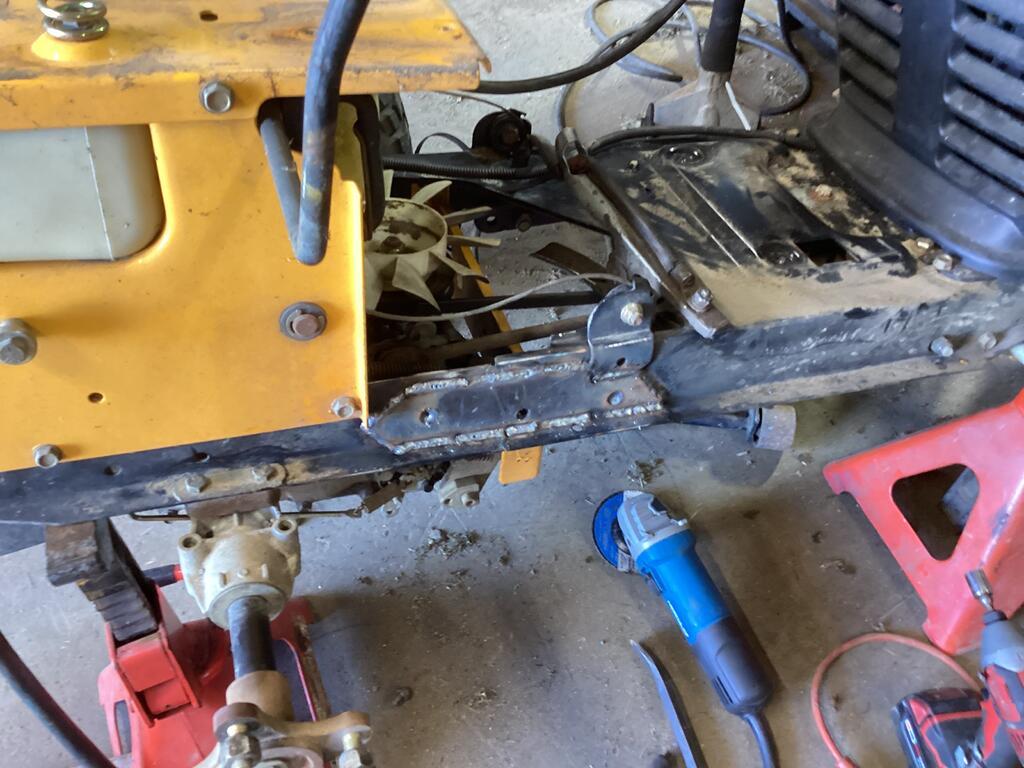

Pullstart 64,484 #13 Posted August 11, 2023 Driver’s side done! I’ve gotta go get my head mechanic daughter from FOOTBALL practice and I’ll get to reassembly and testing! 3 Share this post Link to post Share on other sites
Bill D 2,088 #14 Posted August 11, 2023 55 minutes ago, Pullstart said: Before I saw this, I made that call as well. I’m NOT spending any money, or charging any at least. The fish plate is thicker than the “frame” I’ll do the same treatment on the other side. That repair will outlive the tractor. Very nice. 1 1 Share this post Link to post Share on other sites

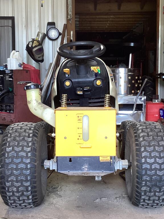

Pullstart 64,484 #15 Posted August 11, 2023 My eyecrometer says it’s looking MUCH better too! 3 1 Share this post Link to post Share on other sites

ri702bill 8,957 #17 Posted August 12, 2023 I'm a-figurin' you had to turn the heat wayyyyy down to keep from burning thru the parent metal. I think the rear fenders on my 854 are a heavier gauge material than that "frame". 1 Share this post Link to post Share on other sites
Pullstart 64,484 #18 Posted August 12, 2023 3 hours ago, ri702bill said: I'm a-figurin' you had to turn the heat wayyyyy down to keep from burning thru the parent metal. I think the rear fenders on my 854 are a heavier gauge material than that "frame". I just kept the focus on the fish plate, but my heat was about 2/3 the way up, with a medium feed. It flowed quite well. 2 Share this post Link to post Share on other sites

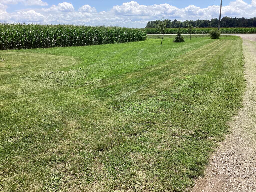

Pullstart 64,484 #19 Posted August 12, 2023 I could use some leveling of the deck practice, but it does what it needs to do again! 1 2 Share this post Link to post Share on other sites
