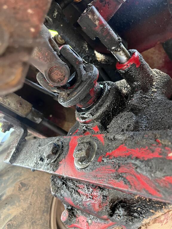

857lover 291 #1 Posted August 7, 2023 (edited) hey guys i’m trying to locate a part number for the seal that seals the input shaft on the transmission or where you think i might be able to find info on it anything would be appreciated! edit: 1976 Edited August 7, 2023 by 857lover Share this post Link to post Share on other sites
gwest_ca-(File Mod) 11,845 #2 Posted August 7, 2023 You did not say what year. Here is one illustrated parts list so you can determine the original part number and then search for seal by manufacturer. 1 1 Share this post Link to post Share on other sites
857lover 291 #3 Posted August 8, 2023 i believe i found the part number but it’s discontinued through toro the part number is 251034 Share this post Link to post Share on other sites

gwest_ca-(File Mod) 11,845 #7 Posted August 8, 2023 Compare the dimensions. SKF recognized the 251034 for Wheel Horse https://www.skfextranet.com/crsealsfinder/datasheet.aspx?s=30X55X7+CRW1+R 1 Share this post Link to post Share on other sites
