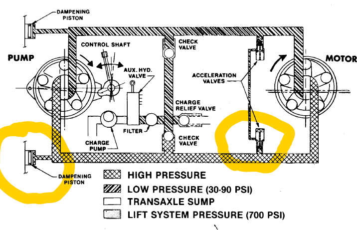

JoeM 9,305 #3 Posted August 6, 2023 just knowing what inside of an 1100 makes it a no no to tow. here is what have learned about it. when towing or pushing the oil from the output side is greater than the input side and a intensification of pressure can occur. the check valves prohibit the oil from back flowing into the charge system and to the sump. there are o-rings in the unit that can be compromised due to this high pressure. you could get away with towing slow on older machines with "wear" as this oil can bypass the input. if you notice when pushing an 1100 you can hear those click it t clacks. (it means you got a good tight one) that is the acceleration valves. I usually tow or push xi machines that have a neutral on the trans and this is not a issue, on the other machines with no neutral I will trailer them or use the FEL under the back wheels to go longer distance. to be safe I would stick to slow hand push only. 2 1 Share this post Link to post Share on other sites

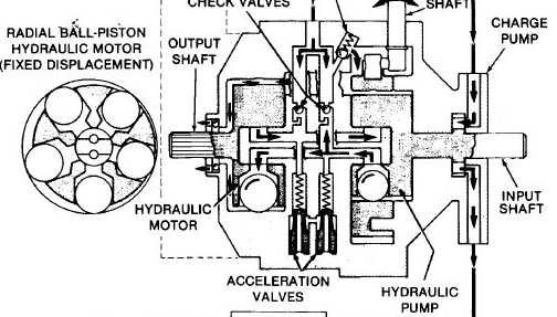

Handy Don 15,152 #11 Posted August 6, 2023 (edited) 5 hours ago, ebinmaine said: What's the correct procedure for moving a tractor with an Eaton 1100 that doesn't run? Also, exactly what happens when one is towed that makes it a bad idea? Per the manuals, it can be moved very slowly by pushing. As noted above, the internal acceleration valves (which allow for smooth starting under power) will close once the “motor” side of the system builds up a certain pressure due to being rotated by the tractor’s motion. When the valves close (unless there is a lot of internal wear) the transmission locks up. (The locking up is a good thing, as it means that in normal operation there is little to no pumped fluid bypassing the hydro motor meaning it’s very efficient. The inefficiency of hydros comes largely from the friction of moving the oil around and the heat it generates.) ’93-’96 520-H Owners manual: HAND PUSHING TRACTOR Hand push tractor only. Do not tow. Towing can cause severe damage to hydrostatic transmission. Hydrostatic transmission tractors can be pushed at a slow speed. To do this, move motion control lever fully forward; tractor will then move when pushed. Transaxle service manual HYDROSTATICTRANSMISSION 1. Rear wheels should "lock up" if tractor is pushed at about walking speed. This is a rough check of transmission condition. If all other parts of the system are good and tractor’s wheels do not lock, it is likely that transmission has excessive internal wear or an internal failure. Conduct a charge pressure and power test. Edited August 6, 2023 by Handy Don 4 1 Share this post Link to post Share on other sites

JoeM 9,305 #13 Posted August 6, 2023 1 hour ago, Handy Don said: To do this, move motion control lever fully forward; tractor will then move when pushed. Not quite sold on that line in the manual. I would say only if the input shaft could rotate freely. Especially if the belt is engaged. I have hand pushed several and that lever had no effect on making it easier. Still the capacity of the output is far greater to the input. I have seen those damping piston o rings bad. The unit still runs but will slow when warmed up to hot. That is why heavy weight oil helps. If the check valves are good that oil is locked in and only gets relief from the acceleration valves and they are small. 2 Share this post Link to post Share on other sites
