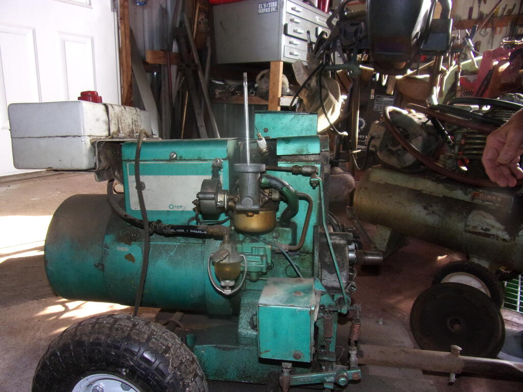

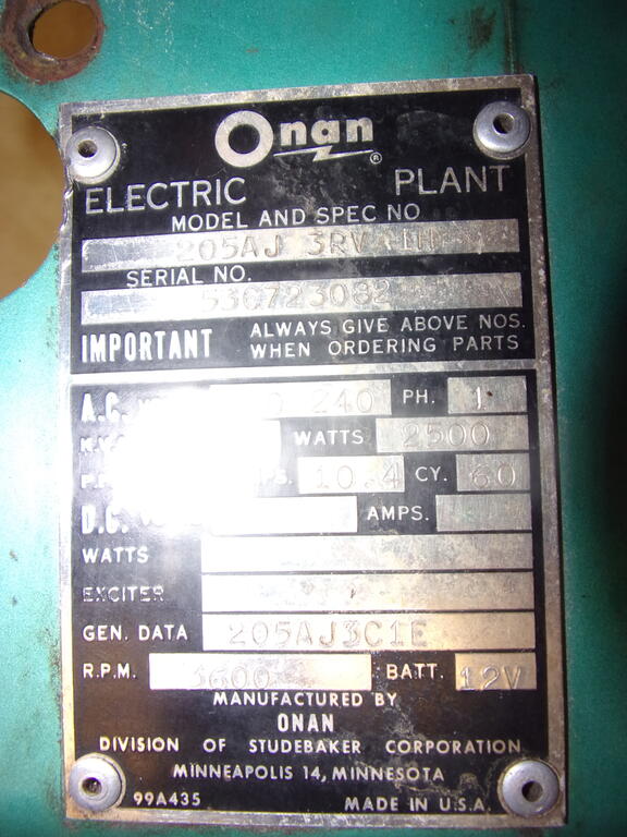

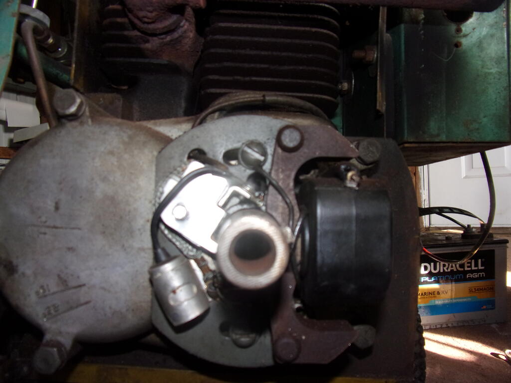

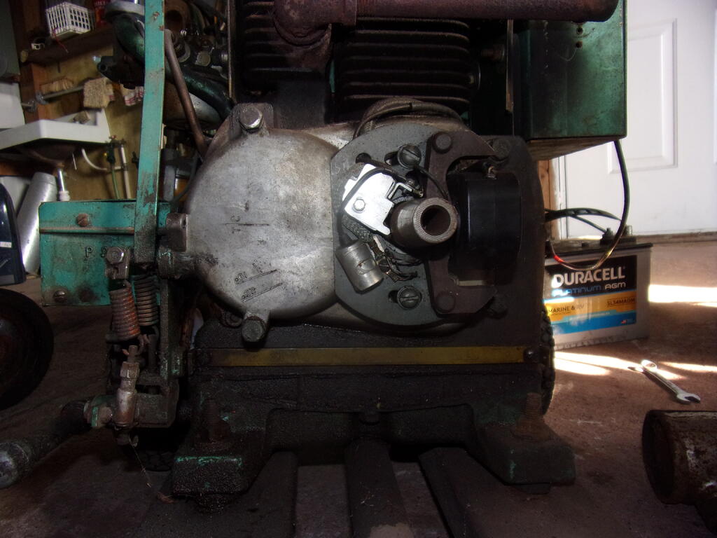

Ed Kennell 37,282 #1 Posted August 6, 2023 Trying to get my 1950s vintage Onan gen set running. It ran when I parked it in 2018. M/N 205AJ 3RV/1H S/N 53C723082 ONAN, a division of Studebaker Corp. Has compression and fuel. Spark is too weak to fire the plug. I have pulled the flywheel and cleaned the magnets....no change. I could use some help to check condenser, coil, points. How to check and set the magnet gap? Share this post Link to post Share on other sites

lynnmor 7,218 #6 Posted August 8, 2023 Here is the manual. Point gap is .021", plug is .025". I took a quick look thru the manual and didn't see information on the magnet gap, perhaps it is a fixed distance, typical clearance is .008" to .012". Use a points file, or other thin fine file to clean them, abrasives can leave grit embedded and cause poor contact. Also, I didn't see the ohm readings expected for the coil or condenser, I would just use readings and testing from popular engines and they should be close enough. Usually you can do a quick test to a condenser by putting an analog ohmmeter across it and quickly reversing the leads, a quick blip of the needle is a good thing. You should have a good attraction from the ends of the magnets to a flat screwdriver, in the good old days magnets could be recharged (remember an auto electric shop on Market Street near the bridge)? 1 1 Share this post Link to post Share on other sites

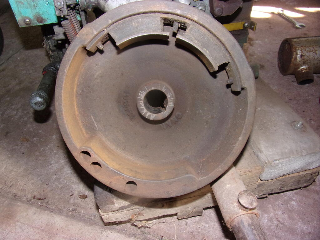

Handy Don 11,820 #7 Posted August 9, 2023 (edited) On 8/6/2023 at 9:04 AM, Ed Kennell said: Thanks for posting this image showing the magnet bar attached by rivets and the drilled-out spots on the counter weight that balance the flywheel. Thinking of the manufacture, it wouldn’t surprise me to find that the drill for balancing was part of the balancing machine so there wouldn’t be any time wasted for mounting/dismounting. With just the two magnets, it seems this is a magneto engine, right? So electric start would come from battery charged by the attached generator? Edited August 9, 2023 by Handy Don 1 Share this post Link to post Share on other sites
Ed Kennell 37,282 #8 Posted August 9, 2023 1 hour ago, Handy Don said: With just the two magnets, it seems this is a magneto engine, right? So electric start would come from battery charged by the attached generator? Exactly Don. Share this post Link to post Share on other sites

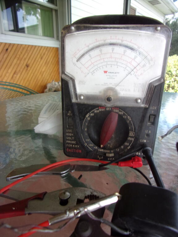

Ed Kennell 37,282 #9 Posted August 9, 2023 OK, it seems the coil is dead. Dead short from primary to ground. Not much hope to find a good 60 yo coil at a reasonable price. This may become a Wheel Horse powered Gen Set. Share this post Link to post Share on other sites
