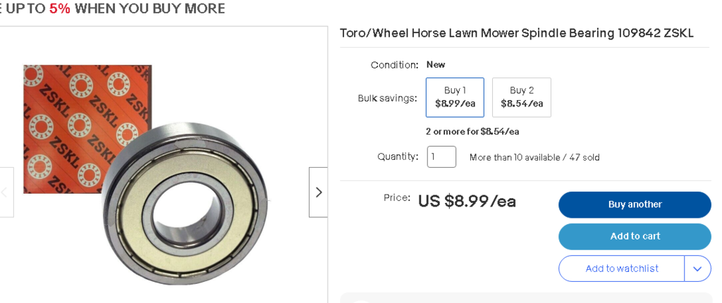

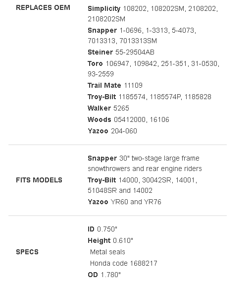

Check out this thread Mike:
Outer bearing Napa PP204RR6
JoeM
I have used these and they work good.
