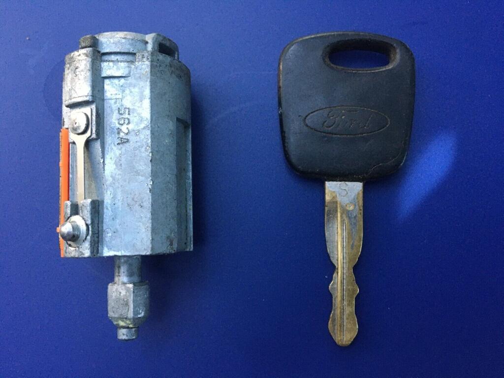

Achto 30,200 #8 Posted August 2, 2023 (edited) On 8/1/2023 at 5:15 PM, TJ5208 said: I'm trying to get it to where I can take a key that goes in a truck and use it on my tractor. A switch like what @wallfish showed would be the way to go. The key switch in most cars & trucks do not have any electrical terminals on them. They are only used to move linkage that is connected to a switch box which is mounted lower down on the steering column. Example : Edited August 3, 2023 by Achto 1 3 Share this post Link to post Share on other sites

Achto 30,200 #13 Posted August 2, 2023 8 hours ago, TJ5208 said: Not really worried about year want dodge key and ignition though You would have to find one from an early model dash mount ignition. All steering column mounted switches will work like the Ford switch that I posted above. Share this post Link to post Share on other sites
TJ5208 1,841 #14 Posted August 2, 2023 Just now, Achto said: You would have to find one from an early model dash mount ignition. All steering column mounted switches will work like the Ford switch that I posted above. Ok so try to get one of those ford ones. Share this post Link to post Share on other sites
Achto 30,200 #15 Posted August 2, 2023 2 minutes ago, TJ5208 said: Ok so try to get one of those ford ones. No, what I'm saying is GM, Ford, Mopar switches that are mounted on the steering column of a car or truck will not work. They do not have any electrical terminals on them, they only move linkage that is connected to a large switch box which is mounted lower on the steering column. 1 1 Share this post Link to post Share on other sites
TJ5208 1,841 #16 Posted August 2, 2023 2 minutes ago, Achto said: No, what I'm saying is GM, Ford, Mopar switches that are mounted on the steering column of a car or truck will not work. They do not have any electrical terminals on them, they only move linkage that is connected to a large switch box which is mounted lower on the steering column. So what I'm trying to do will not work. 1 Share this post Link to post Share on other sites
