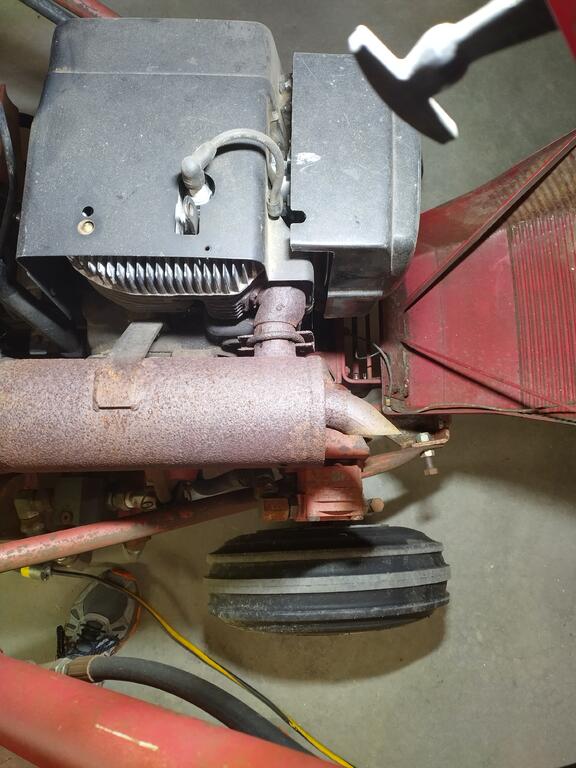

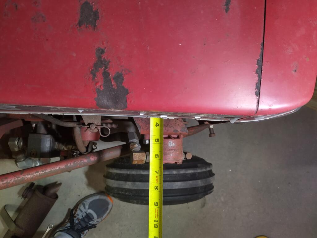

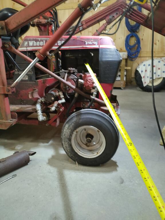

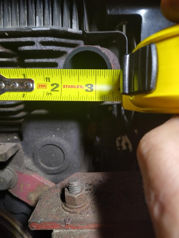

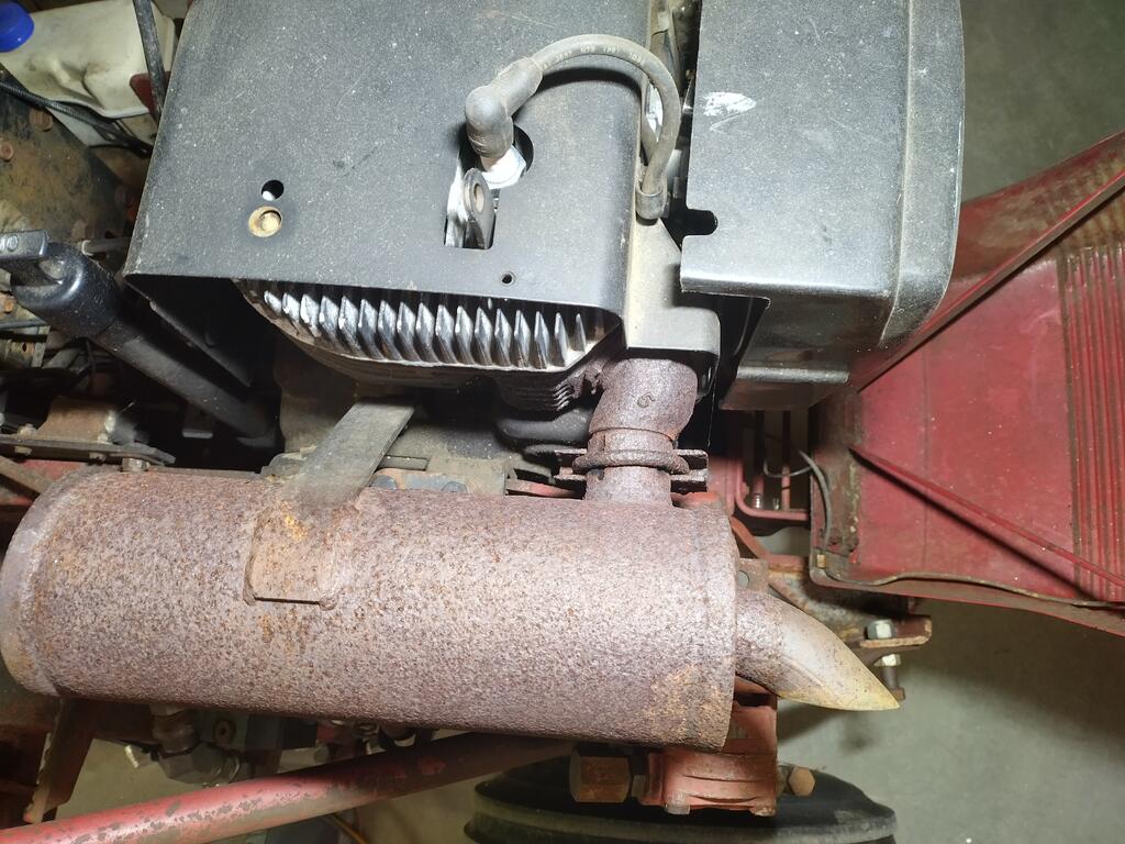

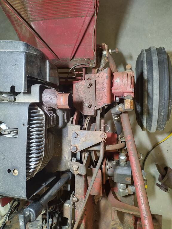

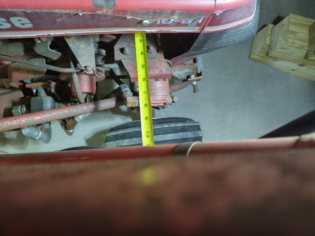

ebinmaine 70,720 #6 Posted July 30, 2023 59 minutes ago, Pullstart said: EB. No pics? Got some for ya. Here's the old muffler. Here's the amount of space and pipe sizing. Looks like just under 1.5" OD. Tape is pointing to the outlet for reference. 1 Share this post Link to post Share on other sites

ebinmaine 70,720 #8 Posted July 30, 2023 2 minutes ago, Pullstart said: Is there something wrong with the stock one? At shutdown the machine backfires LOUDLY. Having had issues with mufflers causing that in the past I got to looking at it. There's an extra hole on the outside at one end, a soft spot on the inside at the other, and it's very rusty crunchy overall soft. Whether it solves the backfire or not this muffler is gonzo... 1 Share this post Link to post Share on other sites

CCW 1,333 #15 Posted July 31, 2023 (edited) 17 hours ago, ebinmaine said: Got some for ya. Here's the old muffler. Here's the amount of space and pipe sizing. Looks like just under 1.5" OD. Tape is pointing to the outlet for reference. So this the same muffler I just replace that you gave me input on. I purchase the "Rotary 8284 Clamp-On Muffler for Kohler" from the A..zonian website. Only problem is took a couple of weeks to arrive. I had to buy a 1.5 ID coupler and another muffler clamp to attach it to the exhaust outlet pipe on the Magnum 12. Edited July 31, 2023 by CCW 1 Share this post Link to post Share on other sites
