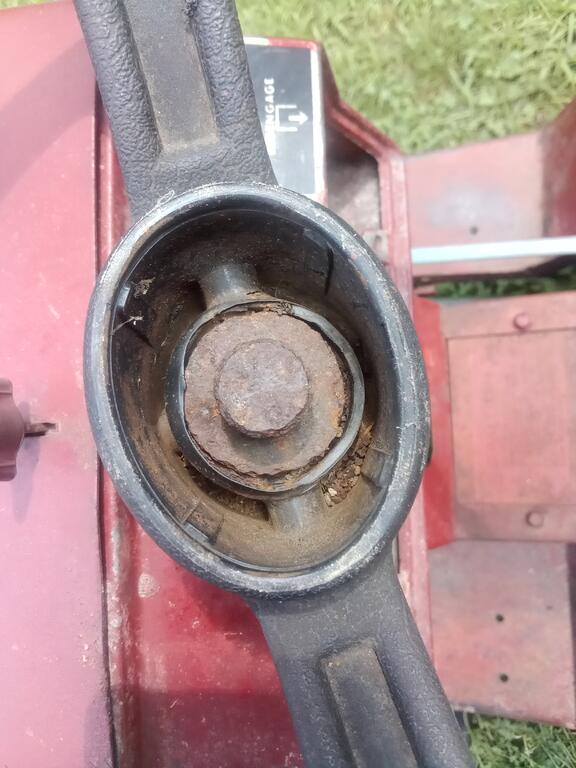

Colby G 244 #1 Posted July 28, 2023 How would I use one of these tools? Share this post Link to post Share on other sites

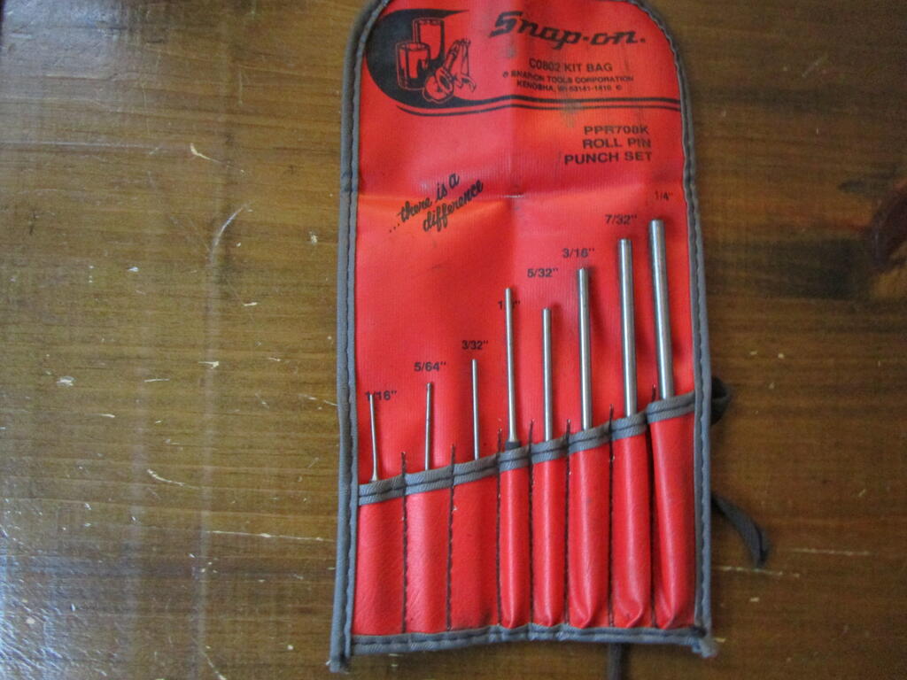

ebinmaine 70,362 #4 Posted July 28, 2023 6 hours ago, Colby G said: Sounds easy enough It would be easy if it isn't rusted. That'll be the kicker. Not to discourage you but please be careful and use great patience. Soaking overnight can easily turn into a week or more. Make sure you get ROLL PIN punches. Regular round punches often won't stay lined up. Also make sure to get a good set. Cheap box store tools may not be hardened enough to tackle this one. Sometimes removing the steering wheel is the most challenging thing about disassembling the whole tractor. Follow the pics by @JCM and definitely set yourself up with a board going from the steering shaft to the wall or other good strong support. 2 5 Share this post Link to post Share on other sites

lynnmor 7,545 #6 Posted July 28, 2023 3 hours ago, ebinmaine said: Follow the pics by @JCM and definitely set yourself up with a board going from the steering shaft to the wall or other good strong support. It appears that a bit of the steering shaft is exposed just below the wheel where he could back it up with steel. A heavy steel weight against the side opposite the hammering will do much for the pin movement. A weight could be made up from a piece of angle iron clamped or welded to whatever scrap you might have. Backing up the soft wheel with a piece of softwood wrapped with a soft towel will have only a small effect, of course if there is no option it is better than nothing. 2 1 Share this post Link to post Share on other sites

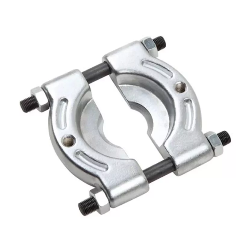

squonk 42,338 #9 Posted July 28, 2023 I don't have any pictures. but I had to remove the steering wheel on my 1267. roll pin was going no where and I have removed plenty of roll pins in my time. I ended up getting a couple of different bearing separators from Harbor Freight. One big one small. I put the small separator under the steering wheel su it would pull on the hub. Then put the large separator under the small one. I got a very large 2 jaw gear puller from work and a 24" Crescent wrench. I got the gear puller on the large separator and the center screw on the steering shaft. a small pipe on the end of the wrench and sheared the roll pin into 3 pieces and got the wheel off. Chunk of broken pin fell out of the steering shaft 1 3 Share this post Link to post Share on other sites

squonk 42,338 #11 Posted July 28, 2023 Bent the bolts on the separators too! 2 Share this post Link to post Share on other sites

lynnmor 7,545 #16 Posted July 28, 2023 5 minutes ago, Colby G said: Yeah, I think it may be rusted onto the shaft... I'm not seeing penetrating oil on that thing, it should be sopping wet including both ends of the pin. Repeat application as often as necessary to keep it wet. Can take days to work. Did you try finding a piece of steel to back up the shaft below the wheel? 1 Share this post Link to post Share on other sites

JCM 9,993 #19 Posted July 30, 2023 On 7/27/2023 at 9:19 PM, Colby G said: How would I use one of these tools? A quality set will help make a difference in your attempt. 2 1 Share this post Link to post Share on other sites
