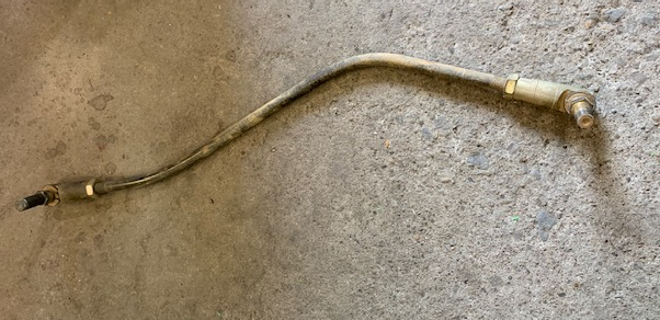

JoeM 9,317 #5 Posted July 27, 2023 hey @ebinmaine look at this 1/2" tie rod I took off of an 522xi. Wonder if the air bags came out? I did straighten it out but took a while. 1 1 1 Share this post Link to post Share on other sites

ebinmaine 75,748 #7 Posted July 27, 2023 Just now, JoeM said: hey @ebinmaine look at this 1/2" tie rod I took off of an 522xi. Wonder if the air bags came out? I did straighten it out but took a while. WOW. 1 Share this post Link to post Share on other sites
Handy Don 15,179 #8 Posted July 28, 2023 (edited) 48 minutes ago, JoeM said: hey @ebinmaine look at this 1/2" tie rod I took off of an 522xi. Wonder if the air bags came out? I did straighten it out but took a while. Takes a pretty hefty amount of force to do that. Airbags indeed?! Son and Daughter used to have a pretty sturdy lawn tractor at their camp. One day a “guest” driver caught a front wheel on a tree while going at a good clip. Tie rod and spindle both bent and the steering arm on the spindle ripped off. We got it repaired but it never worked the same after that. When the transmission started being balky I was able to convince them to invest in a Wheel Horse. Last time I was at the camp, the WH towed the “other” unit ½ mile out to the main road where we put a “Free” sign on it. It was gone in two hours! Edited July 28, 2023 by Handy Don 5 Share this post Link to post Share on other sites

ri702bill 10,571 #10 Posted July 28, 2023 And that is why I went away from using 1/2" round stock and now use 5/8" mild hex stock. Three beffits - stronger to resist tweaking like the picture. Hex shape makes it MUCH easier to die cut the male threads. The hex flat gives a built in spot for an open end wrench to hold the tierod and tighten the joint and jamnut...... 2 Share this post Link to post Share on other sites
JoeM 9,317 #11 Posted July 28, 2023 2 hours ago, peter lena said: those rod ends for anyone that needs the, replacement Yep and they work well at a good price. You can see from the pic how tough those standard ends hold up. Maximum abuse for sure. The updated hem joints do reduce drag and will ease steering especially some of those newer ones with internal bushings. Though the years I have found out when beefing up one area it transfers a problem to another. Sometimes harder and more expensive to repair. 3 Share this post Link to post Share on other sites
