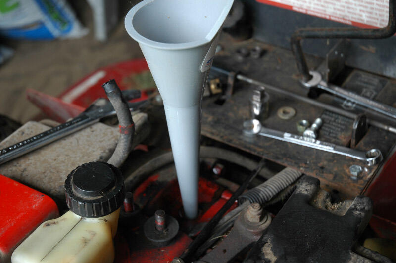

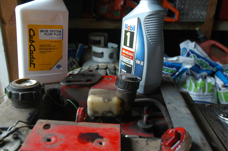

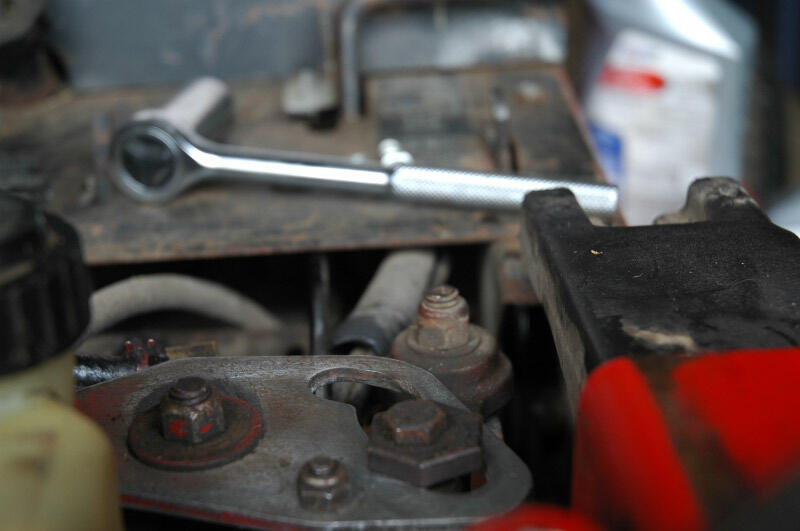

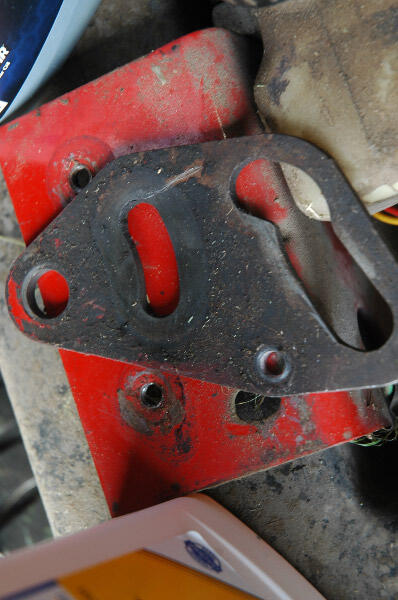

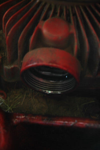

graywolf1939 24 #13 Posted July 27, 2023 Today while it was 92 degrees, it was a good day to work on the 518H in the shed in the shade. I took a few photos which I will include in this reply to my problem. First of all, the hydrostatic transmission (Eaton700) has a Left-hand thread, so it was necessary to turn the drain cap plastic head bolt CW to remove it. Why Eaton uses a CW loosen direction is beyond logic reasoning. The fluid did not look too bad after 35 years, but there could have been tiny bits of metal from original manufacturing, no way to tell without filtering the residue drain. Next was the transaxle drain, it had never been changed in 35 years either. Again, it did not look too bad at all, certainly not like my car oil changes after just 10,000 miles and 12 months. The 3rd action was to align the neutral on the plate and I had to shorten the control rod a bit, it also had never been adjusted from original setting. Then a rip-roaring thunderstorm hit with driving rain so final test will be tomorrow unless we get another expected TS. The photos will show the condition of the plate, the location of the plate after adjustment to neutral and at high-speed position of the control rod. Another photo shows the location of the transmission drain screw removed. Comments welcome. Share this post Link to post Share on other sites

graywolf1939 24 #15 Posted August 5, 2023 Thank you for your reply Tuneup. Before I add my reply and experience with my problem, let me add my prayers and thoughts for your 7 neighbors they were killed today in that mud slide that destroyed the resort in the mountains, 30 more missing and feared dead. My 518 is one tired beast. Now I have it running OK again, what I did to adjust the transmission is as follows: I adjusted the plate while in neutral so that the top edge of the large washer was just touching the top opening of the slot. I also made an adjustment to the linkage shift rod about 2 turns shorter. I then changed the transmission oil to synthetic 10W-30. If our summers get much warmer for longer periods of time than in the past 40 years, I will change to 15W-50. When it is in the 90's and cutting 2 acres of lawn, some hilly areas, the oil after 30 minutes will be very thin and very hot. In Massachusetts (Central hills), we typically are in the 70-80's in summer, so 10W-30 has been the "go-to" oil. I am buying a new lawn tractor soon, it would have been another Wheel Horse, but as we know they are OOB. Anyone interested in purchasing a running H518 with commercial grade 48" mower deck? Share this post Link to post Share on other sites
