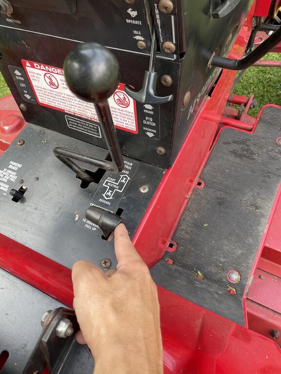

Kissinger_520H 3 #3 Posted July 24, 2023 Okay now I realize that I misspoke. I’m actually talking about the transmission engagement clutch. I think that they did away with this design shortly after 1989. Will attach photo for clarity, Share this post Link to post Share on other sites
WHX?? 49,884 #5 Posted July 25, 2023 OK yes pic = 1k words around here. That was the early models and they have such did away with it on older models. It disengaged the clutch idler so the tractor could be started without powering the transmission. When they realized the power of the Onan they figured they didn't need it. Used on many other older models and they rattle too. Wouldn't hurt anyone to pull the belt guard and see what's going on. Should be done anyway for inspection and cleaning. 2 1 Share this post Link to post Share on other sites

Handy Don 13,046 #7 Posted July 25, 2023 (edited) 15 minutes ago, WHX?? said: That was the early models and WH removed it on newer models. I’m running a 520-H chassis without the release and as long as your battery and engine are in good shape, there is no need to disengage the transmission. I’m convinced it is a hold-over from lower HP tractors and the Eaton 700 transmission. The most common causes of rattle there are a drive belt that is nearing end-of-life, worn our bearings in the idler/tensioner pulley, and the cross-tractor shaft that supports the idler/tensioner pully wearing (itself and the holes in the frame it rides in). Bottom line is that it can be eliminated by swapping out the idler tensioner arm and its pulley for a newer one (the pulley is larger and the spring attaches differently). Edited July 25, 2023 by Handy Don Share this post Link to post Share on other sites

peter lena 8,967 #9 Posted July 25, 2023 @Kissinger_520H agree with the belt inspection layout , a regular problem is the idler pulley , if its not smooth / or noisy in any way , replace it , another thing , there are a number of related bushings , that are probably dry / rusty , get some aerosol penetrating oil in those for easier / quieter movement . especially on the belt tension spring pull point , pete Share this post Link to post Share on other sites
