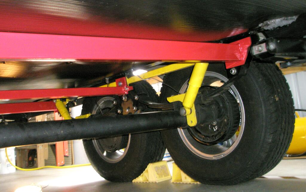

lynnmor 7,459 #2 Posted July 19, 2023 (edited) I did considerable work to my travel trailer to make it usable. I replaced the cheap tires with LT load range D Goodyear Wranglers. The cheap steel wheels were replaced with wider aluminum ones to match the tire width. The skinny and bent 2-3/8" axles were replaced with heavier wall 3" tubes. The bent, broken and malformed springs were replaced with some from a farm store. The cheap too thin shackles were replaced with ones I made from 4140 HT steel. The bolts were all replaced with wet bolts so the new bronze bushings could be greased. Framework was added to beef up the frame and stop the cracking that I had in four places. Monroe gas shocks were added and fastened to the framework mentioned. All tires, wheels and drums were balanced as assemblies, because factory drums are not balanced at all. A TPMS was added to keep track of tire pressures and temperatures. Plus much more. Edited July 19, 2023 by lynnmor 6 2 Share this post Link to post Share on other sites

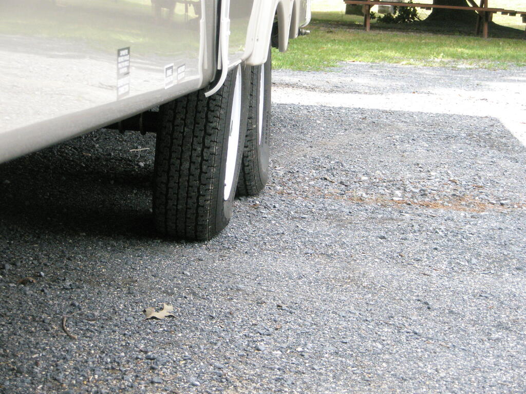

lynnmor 7,459 #7 Posted July 19, 2023 57 minutes ago, ranger said: One thing I think many people “Don’t” take into consideration with heavy multi axle trailers is the stresses imposed on the framework, etc when being towed by a big truck with stiff suspension. A single axle trailer is relatively unaffected by ‘Pitching’ movement between the vehicle and trailer, but a multi axle trailer is. Tremendous stresses can be placed on frames and drawbar/tongue? If the trucks suspension doesn’t move easily to accommodate trailer movement. A popular towing accessory over here is a towball mounting called a ‘Shocklink’? Which absorbs movement of the trailer in a vertical plane when the truck’s stiff suspension doesn’t. You mean something like this while making a U-turn in a gravel parking lot? This is before I did the modifications mentioned above. Here is one of the four frame cracks where the cross members tried to punch thru the incredibly weak main frame beams. 2 Share this post Link to post Share on other sites

ranger 1,769 #9 Posted July 19, 2023 (edited) 2 hours ago, lynnmor said: You mean something like this while making a U-turn in a gravel parking lot Not exactly. What I’m referring to is the trailer trying to ‘rock’ and pivot around the axle centre. On a single axle there’s no problem. A multi axle trailer tends to take weight off one or the other axle over undulations. Again not a huge problem if the towing vehicles suspension is ‘matched’ to the trailer and can move easily, if the coupling/hitch end is effectively solid, I.e, very stiff truck springing then excessive stresses are applied to the ‘A’ frame etc. Edited July 19, 2023 by ranger 1 Share this post Link to post Share on other sites
