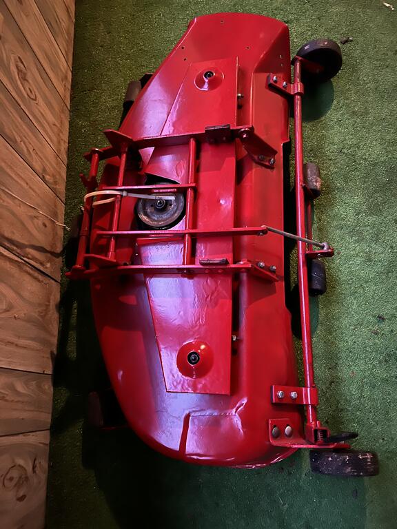

gretle_2.0 41 #1 Posted July 15, 2023 (edited) Hey guys was wondering if someone could help identify which year this deck was made (couldn’t find a sticker anywhere on it), trying to get all new wheels and rollers for it as well as mowing blades. Bought this for my 94 520H. Are the blades the same size for 42” rear discharge as this 48” side discharge? much thanks! Edited July 15, 2023 by gretle_2.0 Share this post Link to post Share on other sites
gwest_ca-(File Mod) 11,171 #2 Posted July 15, 2023 Here are the possibilities Mower DNA 48" side discharge 1966-1967 model RL-486 replaced by 1968 model 5-1481 1969 model 5-1482 1970 model 5-1483 1971 model 5-1200 1972 model 5-1201 1973 model 5-1202 1973-1974 model 5-1210 1975 model 5-1211 1976 model 65-48MS01 1976 model 65-48MS02 1977 model 75-48MS01 - These all used blades with 5/8" x 3/4" double-D center hole unless the spindles have been upgraded. ------------------------------------------------------------------------------------------------------------------------------------------------------------------------- Note - 3/4" or .750" is 19.05mm 1977 model 75-48MS02 - Uses 6203 bearings with 3/4" ID - (First deck to use blades with 3/4" center hole) - Originally had a nylon-insert nut holding spindle pulley on. 1978 model 85-48MS01 - Uses 6203 bearings with 3/4" ID - Originally had a nylon-insert nut holding spindle pulley on. 1979 model 95-48MS00 - Uses 6203 bearings with 3/4" ID - Originally had a nylon-insert nut holding spindle pulley on. 1979 model 95-48MS01 - Uses 6203 bearings with 3/4" ID - Originally had a nylon-insert nut holding spindle pulley on. 1980 model 05-48MS01 - Uses 6203 bearings with 3/4" ID - Originally had a nylon-insert nut holding spindle pulley on. 1981-1983 model 05-48MS02 - Uses 6203 bearings with 3/4" ID - Originally had a nylon-insert nut holding spindle pulley on. 1984 model 05-48MS03 - Uses 6203 bearings with 3/4" ID - Originally had a nylon-insert nut holding spindle pulley on. Note - 17mm is .669" 1985 model 05-48MS04 - Uses 6203 bearings with 17mm ID - Originally had a standard nut and lockwasher holding spindle pulley on. 1986-1988 model 05-48MS05 - Uses 6203 bearings with 17mm ID - Originally had a standard nut and lockwasher holding spindle pulley on. 1987-1988 model 05-48SC01 - Uses 6203 bearings with 17mm ID - Originally had a standard nut and lockwasher holding spindle pulley on. 1989 model 15-48SC01 - Uses 6203 bearings with 17mm ID - Originally had a standard nut and lockwasher holding spindle pulley on. 1990 model 15-48SC02 - Uses 6203 bearings with 17mm ID - Originally had a standard nut and lockwasher holding spindle pulley on. 1991-1992 model 15-48SC03 - Uses 6203 bearings with 17mm ID - Originally had a standard nut and lockwasher holding spindle pulley on. 1993-1997 model 78360 - Uses 6203 bearings with 17mm ID - Originally had a standard nut and lockwasher holding spindle pulley on. 1998-2007 and 2009-12 model 78361 - Uses 6203 bearings with 17mm ID - (These all use blades with 3/4" center hole) - Originally had a standard nut and lockwasher holding spindle pulley on. 1 Share this post Link to post Share on other sites
Ed Kennell 39,668 #3 Posted July 15, 2023 11 hours ago, gretle_2.0 said: Are the blades the same size for 42” rear discharge as this 48” side discharge? No, the blades are not the same size. To find replacement blades for an unidentified deck, it would be best to remove a blade and measure the length and document the mounting hole size and configuration.. Even if you identify the deck model number, it is possible the spindles and blades were changed at some point in time. 1 Share this post Link to post Share on other sites

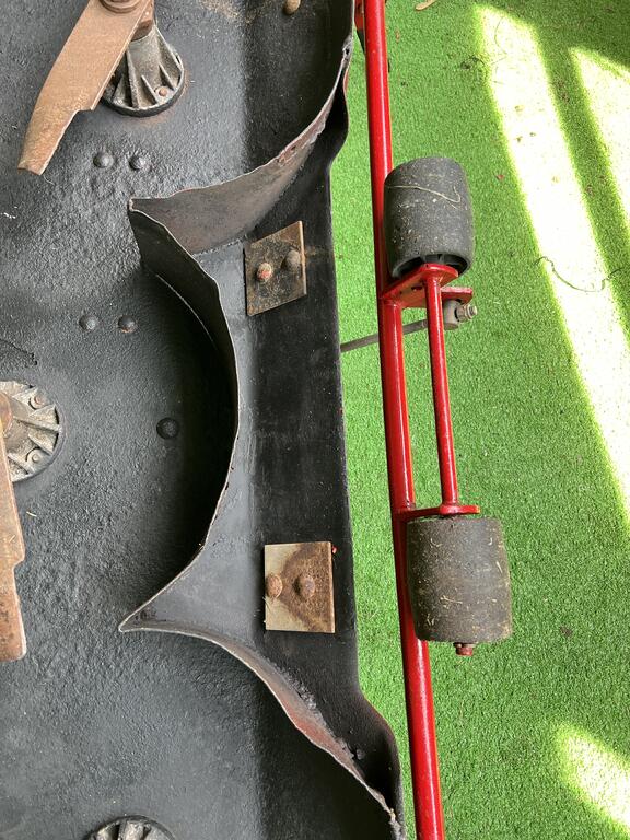

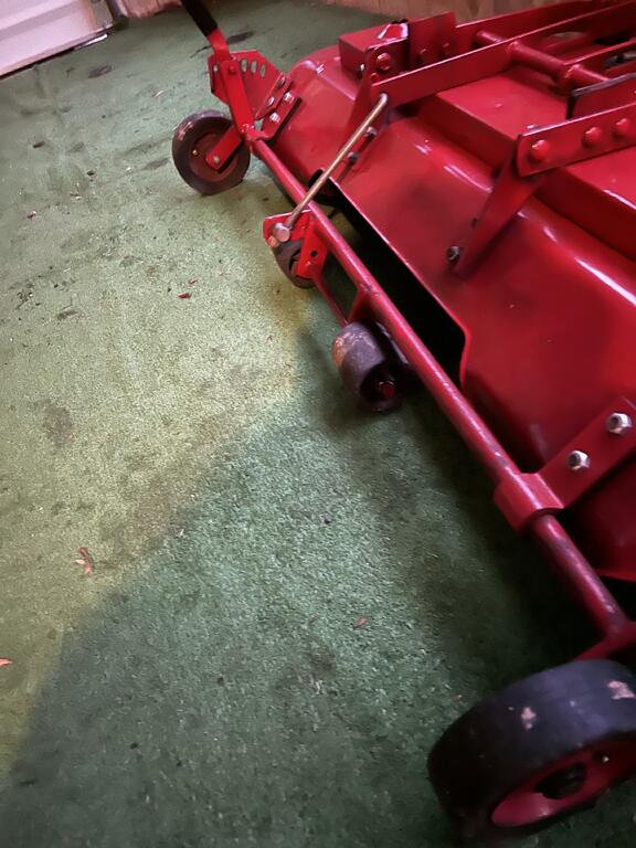

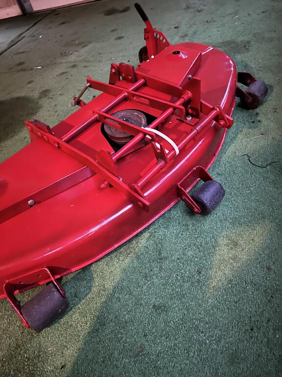

pacer 3,174 #4 Posted July 15, 2023 1 hour ago, Ed Kennell said: Even if you identify the deck model number, it is possible the spindles and blades were changed at some point in time. Do you have blades on the deck and they are just worn? If so take all 3 off and check each blade for dimensions, all to often the spindles will be different - one may have cratered and replaced with a different type. If you dont have blades determine the diameter of the shaft and note if all 3 of the spindles are the same. If that is a bit confusing, take a picture of the bottom of the deck (you took great pics of the top of the deck) and one of us can probably help out more........ Share this post Link to post Share on other sites

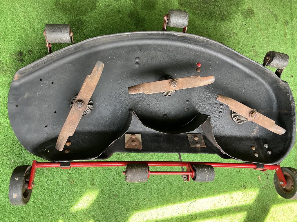

gretle_2.0 41 #6 Posted July 15, 2023 Here are some pictures of the bottom of the deck, I believe the blades are supposed to be 106637 if I’m not mistaken. Share this post Link to post Share on other sites
peter lena 8,960 #7 Posted July 16, 2023 @gretle_2.0 would definetly replace those blades , looks like preveious owner gave that a black lubricant based covering , boy are you lucky! would take advantage of that coating and give it a gear oil , brush down , to enhance it and fortify whats there . would also let that get hot in drying proped up to the sun , using the deck lift frame as a holding point , like this , been doing this for years , zero rot or issues . also prefer a hi temp grease , with a 550 + temp rating , for those spindles , and related idler pulleys . how do those blades / spindles sound when you spin them? the quieter , easier , smoother they move tells you the story . would like to think with current look , that its good . also a good time to re grease the muel drive bearings . let me know , pete Share this post Link to post Share on other sites
76c12091520h 3,720 #8 Posted July 17, 2023 You are correct on the blade part # ( 106637 ) , That deck could be from the late 70's thru the mid 80"s. Any earlier and it would have the " dd " style spindle shafts with the 2 pins on either side of the blade bolts , and if it were a newer deck from the Toro years it would have the reinforcing bar along the front leading edge. We have all the parts you would need in stock just about an hours drive away. 3 Share this post Link to post Share on other sites
