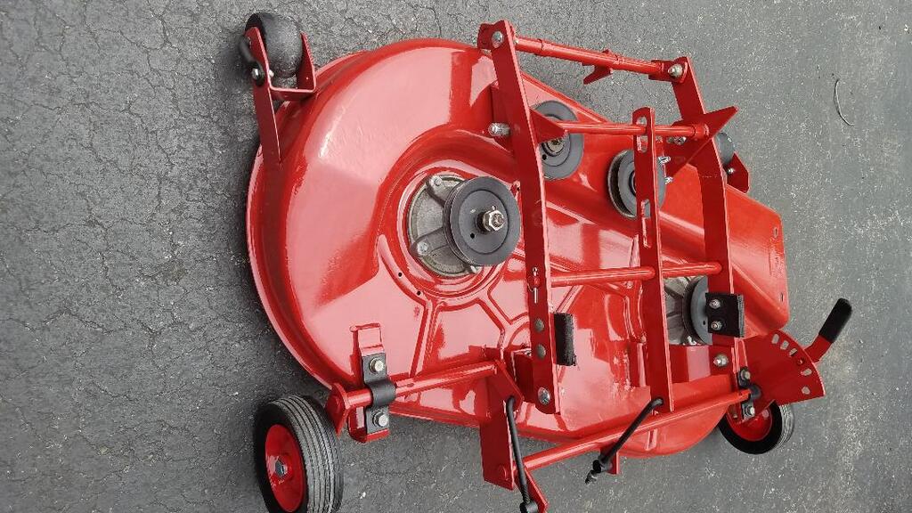

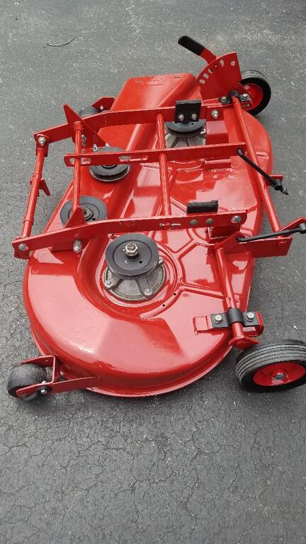

Brockport Bill 1,818 #26 Posted July 11, 2023 heres a 37 s.d. I owned originally since 1989 I had blasted professionally 1 1 Share this post Link to post Share on other sites

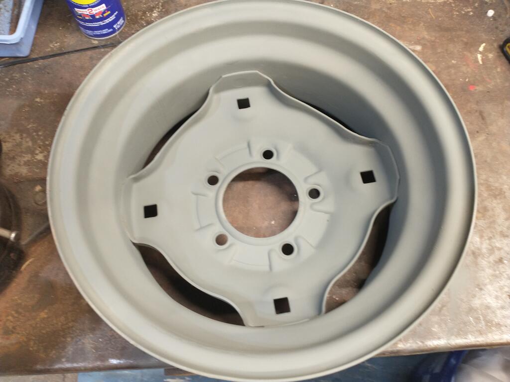

squonk 42,302 #32 Posted July 20, 2023 (edited) Wheel out of the vinegar bath after the electrolysis tank. Wire wheeled a few nooks and crannies. then primed. Edited July 20, 2023 by squonk 8 Share this post Link to post Share on other sites
Thatoneguy 197 #33 Posted July 20, 2023 On 7/20/2023 at 8:30 PM, squonk said: Wheel out of the vinegar bath after the electrolysis tank. Wire wheeled a few nooks and crannies. then primed. That is looking good! 1 Share this post Link to post Share on other sites
ineedanother 1,370 #34 Posted July 20, 2023 On 7/20/2023 at 8:30 PM, squonk said: Wheel out of the vinegar bath after the electrolysis tank. Wire wheeled a few nooks and crannies. then primed. Soooo much better than sandblasting IMO. I don't even go the vinegar route at all anymore. I don't see the need and really don't want to deal with the leftover vinegar. Share this post Link to post Share on other sites
squonk 42,302 #35 Posted July 20, 2023 I use the vinegar to kill weeds. 5 Share this post Link to post Share on other sites
