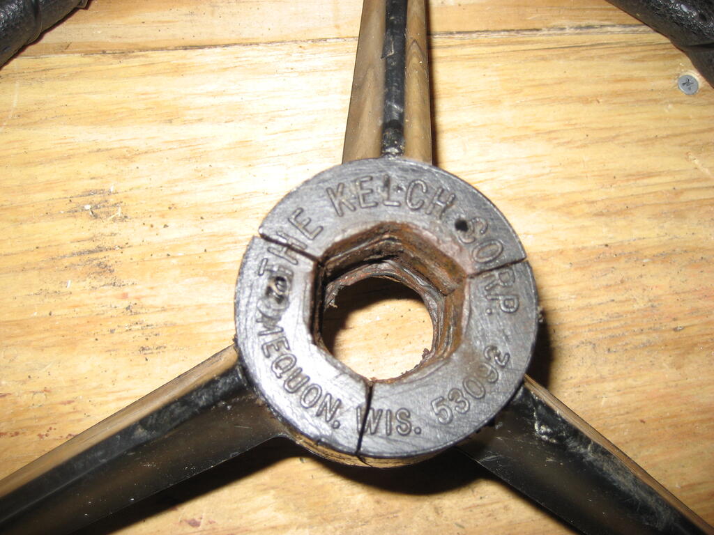

ri702bill 8,969 #6 Posted July 10, 2023 (edited) As Pete said - place a length of wood - 2x3 between the steering shaft below the wheel side opposite the hammer and other end seated solidly up against the garage inner wall stud - the key is solid - Use a RollPin Punch if you have one... Once the pin is out, you are NOT done - the steel hex hub may (most likely is) rusted to the shaft. The wheel hub is overmolded onto that hex - go easy. IF you hub already has splits in the plastic at the pin area, it may very well break apart when you try to remove it..... been there, done that... If you break the wheel, the hub opens up and removing it gives good access to the hex for removal........ Curious - are you in Solebury?? Edited July 10, 2023 by ri702bill 1 Share this post Link to post Share on other sites

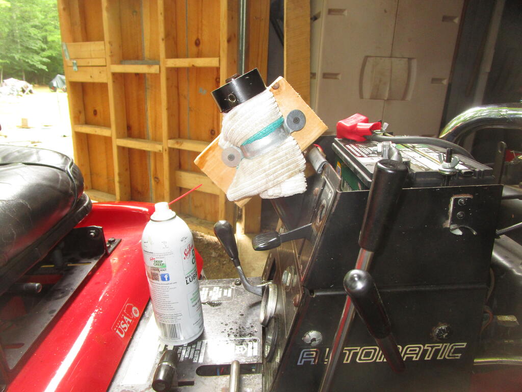

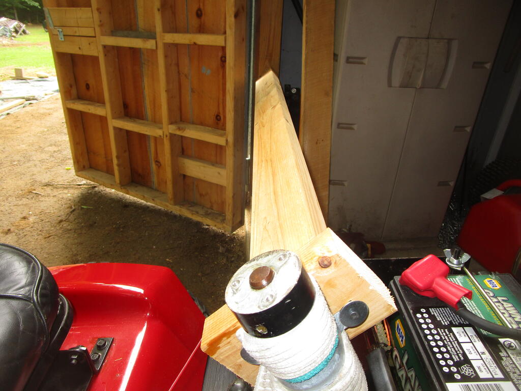

JCM 10,017 #7 Posted July 10, 2023 @hotajax Try this for removing that roll pin. This is a little bit different on a 420, same basic principle. Steering wheel hub mount on a 420 instead of a roll pin through the steering wheel. 1 4 Share this post Link to post Share on other sites
peter lena 9,088 #8 Posted July 10, 2023 @hotajax https://www.indiamart.com/proddetail/ms-clamp-20193037155.html could even consider a pipe hanger to bolt on to wood or weld on a pipe , @JCM first picture showes the solid stopping effect needed to get that pin moving . pete 3 Share this post Link to post Share on other sites
JCM 10,017 #9 Posted July 10, 2023 Riser ring / Friction clamp could be used as well as Pete noted in that link. 1 Share this post Link to post Share on other sites
kpinnc 13,732 #10 Posted July 10, 2023 (edited) 4 hours ago, hotajax said: I need to remove wheel so I can see what type of hub it is. I can simplify that for you: it's 0.75 inch diameter with a roll pin pressed into it. No splines. Standard Kelch wheel more than likely. Being it's been there since 1985, it will be brown welded pretty hard. Getting the roll pin out is the easy part. Getting the wheel off without destroying it is the hard part. Soak it alot, and take your time. Edited July 10, 2023 by kpinnc 2 1 Share this post Link to post Share on other sites

hotajax 226 #13 Posted July 14, 2023 On 7/10/2023 at 5:48 PM, kpinnc said: I can simplify that for you: it's 0.75 inch diameter with a roll pin pressed into it. No splines. Standard Kelch wheel more than likely. Being it's been there since 1985, it will be brown welded pretty hard. Getting the roll pin out is the easy part. Getting the wheel off without destroying it is the hard part. Soak it alot, and take your time. What is a Kelch wheel? Is that a brand or style? Thanks. Share this post Link to post Share on other sites
kpinnc 13,732 #14 Posted July 14, 2023 1 hour ago, hotajax said: What is a Kelch wheel? Is that a brand or style? Thanks. Just a brand. They made oodles of tractor steering wheels. The one below isn't WH, but typical. Share this post Link to post Share on other sites
