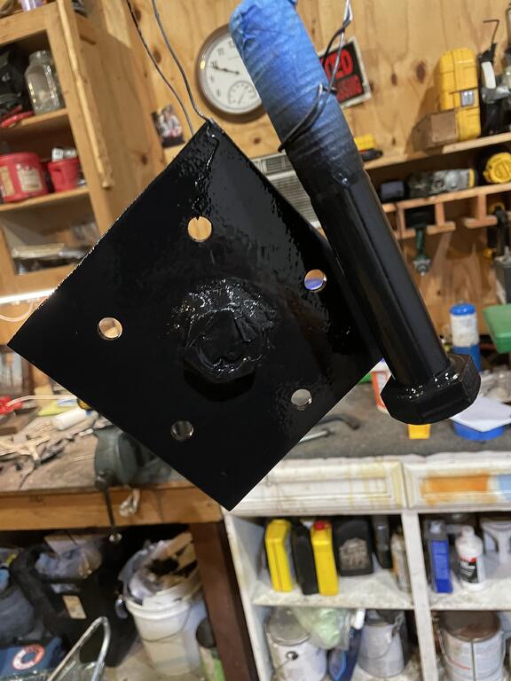

Easier to control the force being applied if the bolt has a fine thread.
@Handy Don unfortunately I have already welded the course thread bold on the plate.  Hopefully it will get it off and maybe I will make one with fine threads later down the road!  Thank you for the advice though I did not think about that when I was bolt shopping!
You'll be fine with the coarse thread as long you're conscious of the difference while using the puller.
Remember.  It took 40+ years to become stuck.
It won't likely slide right off.
Tighten it up.
Heat if possible.
Let it set a bit.
Repeat.
Repeat.

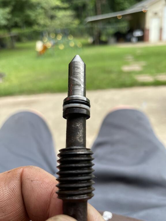

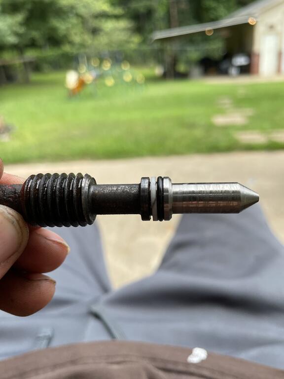

A little update on my sundstrand.  After pressure washing it the by pass valve leaks once it is screwed in passed a certain point. I put a new o-ring on it but still does the same thing.  If I screw it all the way in I can sit there and watch it start to seep past it… any ideas.  Does this require thread tape or any type of thread sealant?
@daveoman1966 ?

Got the puller made and painted.  Going to give it a try this evening.

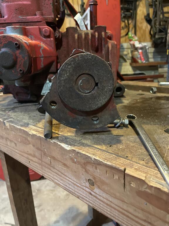

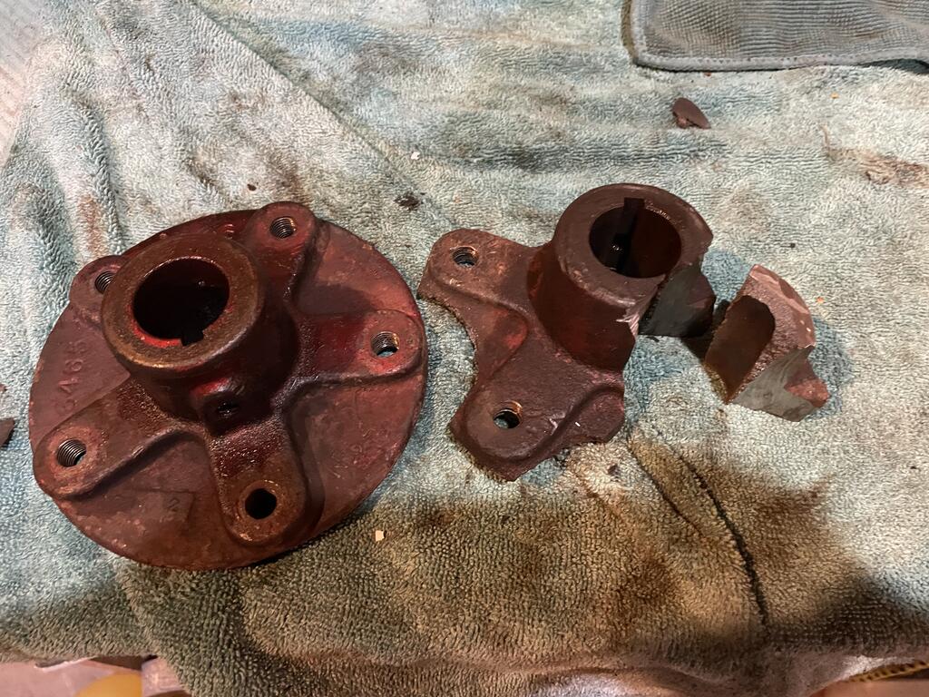

Things are just not going my way…. Any ideas?  I am thinking cut it off….
  • Sad 1
ineedanother
Yep. Cut it off. Don't ever consider a BFH to remove a hub! The axle is held laterally with a c-clip which doesn't tolerate excessive force being applied.
Thatoneguy
BFH? What is that?
ineedanother
Big friggin hammer :D
  • Haha 3
Wheel-N-It
DITTO, just cut it off. Nothing there left to save
Thatoneguy

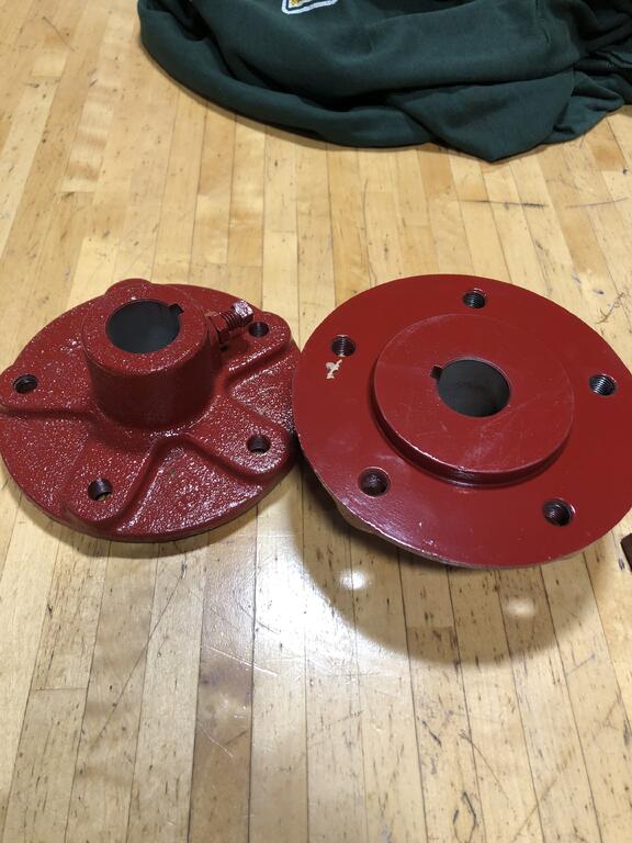

Well after about 3 1/2 hours and who knows how much propane, I had to cut one hub off and the other slid off like a piece of sandpaper on wool!  Checked for play in the shaft and will be replacing seals before reassembly! Thanks to everyone for their help getting them off, especially @richmondred01 for being faster than Amazon on the new hubs!

Well I broke the first hub last Thursday trying to get it off.  Then I thought it might be a good idea to wait and get some advice as I wasn’t really sure what to do when I got down to 3 lug holes!! :tools-hammerdrill:
I got the puller finished Monday night and got it all bolted up and thought hell I don’t even have a socket or wrench big enough to fit it…. :text-imwithstupid:
So you could call it 5 days!

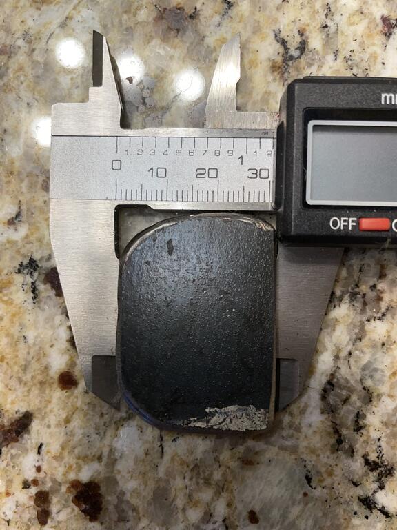

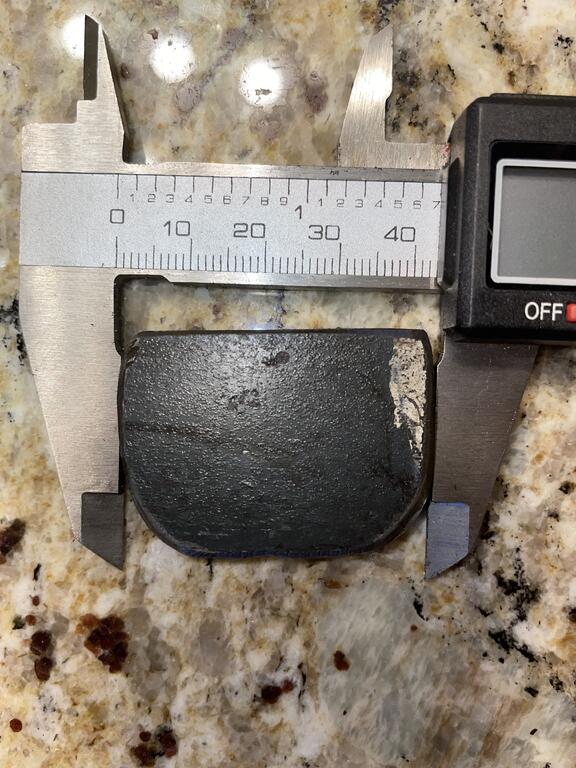

This is what I came up with to get my needle bearing out of the pto pulley housing..  I am no machinist and lucky me :angry-banghead: my caliper battery died, but the way I read it it is 1.30x1.42 with the sides rounded.  I can get it in there without modifying anything on the pulley housing and pounded :tools-hammer: it right out.
Edited by mower
oliver2-44
If your planning on using the same bearing, I would clean it in place.  The needle cage will probable get damaged trying to remove it. you can flush it with solvent and an old 1" brush, then give it a final spray down with a cab of brake clean.  Fill  it with a clean cloth and tape it off for painting.
Of course if your replacing it that will work.  I know there is a snap ring on the PTO end with the roller bearing.  I seem to recall their also being one on the needle bearing end.
Thatoneguy
Yes I got everything out of it fairly easily. I will be getting a new needle bearing. :text-thankyouyellow:
