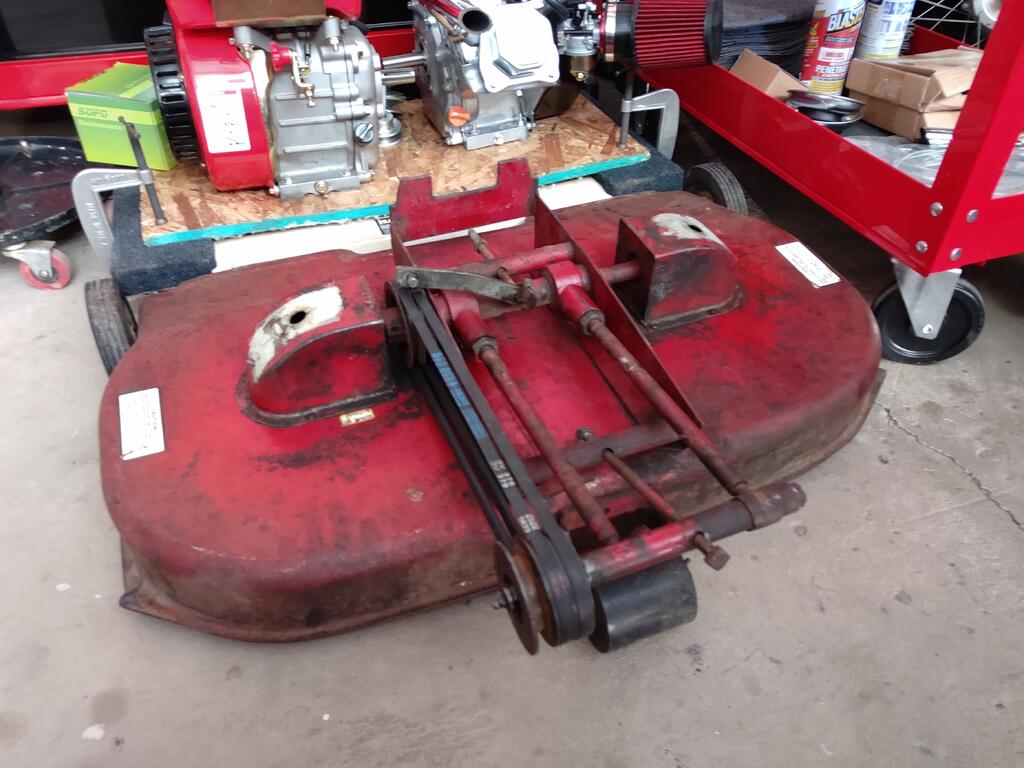

Got ambitious & took apart mower deck to replace belts. Wasn't fun but not too terrible of a project. Luckily, everything else was in really good shape. Scraped & painted underside w/POR. The blades are pretty beat up. I sharpened them as best as I can. Stated to look for a blade set. Looks like that may not be easy to obtain?? Old p/n 3719-L, 3718-R. Superseded to p/n 8777 blade set which doesn't seem to easily available either? Tomorrow I'll try Tractor Supply & my local family owned Toro dealer who I've done business with for years. They were a Wheel Horse franchise. Lastly, I also will have to find a couple caps/plugs to cover the grease fittings.

Looks like you are off to a good start. Careful - the blades can be installed wrong - upside down or right to left..
Are the blades timed per the manual so there is no "territorial dispute" between them??
Place an ad in the Wanted section for the 8777 Part Number - they ARE out there...
ML3
I have then timed. All together when I hand spin the pulley the blades move freely without hitting each other.

It isn’t just that the blades don’t hit each other. They should be 90º apart to help with balance and clipping movement.
Also, the cross-shaft “face” gears should mesh with the bevel gears with only a very small amount of gear lash. (I used a thin shim washer behind one face gear between it and the step in the shaft to get my gears to close the gap).
Correct rotation, when looking up from underneath: belt side--counter clookwise, non-belt side--clockwise.
The bent up blade corners are toward the shell, i.e. away from the grass being cut.
It’s not possible to over-grease the gears. They are turning VERY fast and will sling grease a lot.

There is no p/n or anything on the blades at all. I'm sure they been replaced. Definitely a left & right blade as they are different
I got them 90° apart. I know that's for balance. I'll check the gear lash- thanks for the info!

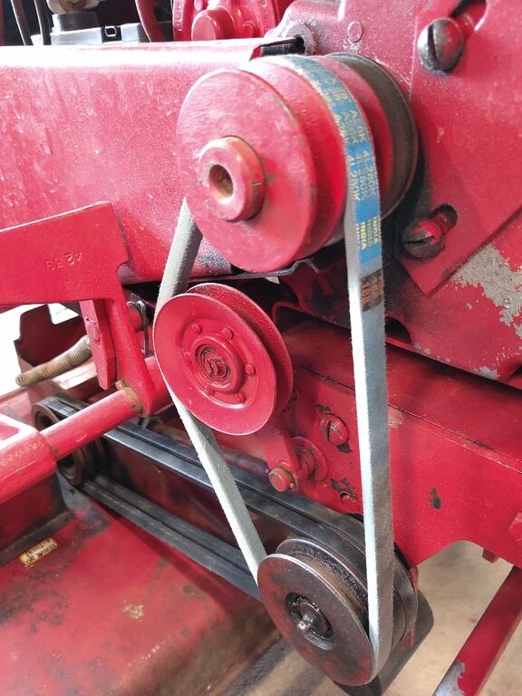

Got mower installed. Needs a few adjustments however it cuts properly & runs quiet/smooth. The foot engagement pedal tensioner pulley is quite loose so it doesn't sit even with other pulleys. Looks like I'll be needing one of them. Also have to get a correct pedal tensioner spring too.

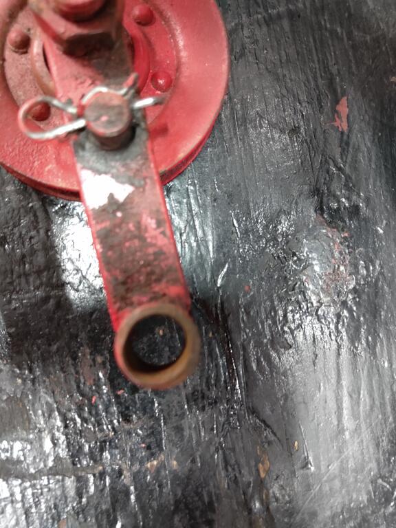

Definitely "egg" shaped. Now I gotta find one....
Handy Don
That one has seen a lot of use!
If you have (or have access to) the skills/tools, I'd consider cutting and grinding to remove the existing bushing and welding on a new one.
Take careful and complete measurements before starting in, of course, but that isn’t a hard job. :)

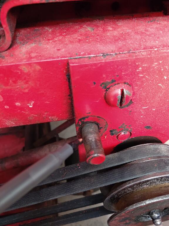

K&B is looking to see if he has one. The bushing I think is long gone. Also the pin/stud it mounts to on tach matic looks a bit rough too. Don't know pin/stud is available separate or part of tach matic? K&B said to give him couple days to look but thinks he may have what I need.
Handy Don
On that model, the pin is welded to the bracket from the rear. This, too, could be replaced without too much trouble by a decent welder. I have done similar ones on other parts.
