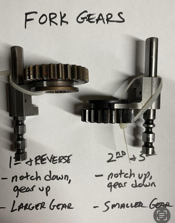

squonk 41,291 #11 Posted July 5, 2023 22 hours ago, PWL216 said: I have a set of forks from a 312-8. Would that work? No. hi -lo fork looks like this. 1 Share this post Link to post Share on other sites
PWL216 890 #12 Posted July 6, 2023 16 hours ago, squonk said: No. hi -lo fork looks like this. Thx Squonk, you’re right. Thx for the correction. I’ll look tonight if I have the hi lo 1 Share this post Link to post Share on other sites

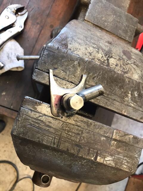

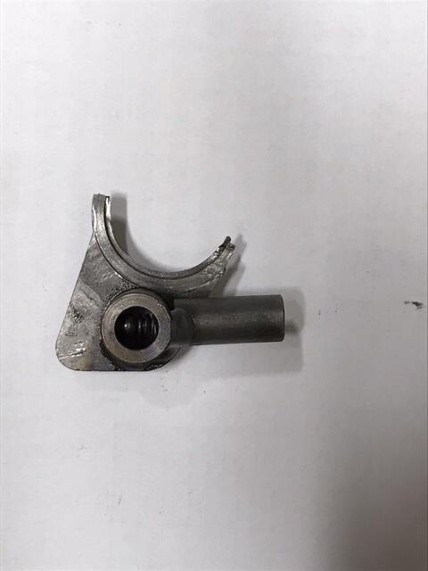

Jeff Diemer 5 #13 Posted July 9, 2023 After striking out finding new I went for the repair. carefully removed the old plate to use as template. 1-14/" hole saw, 3/4" drill, piece of .125 steel ,some red dykem and some grinding and filing I have a working fork. the steel was thicker then the original and I had to thin down the area where it fits the gear but maybe it it will be a little stronger. The old plate was bent pretty good but it is only 43 years old. Transmission now back together and shifting feels good.Test drive in a couple more weeks. 1 4 Share this post Link to post Share on other sites
