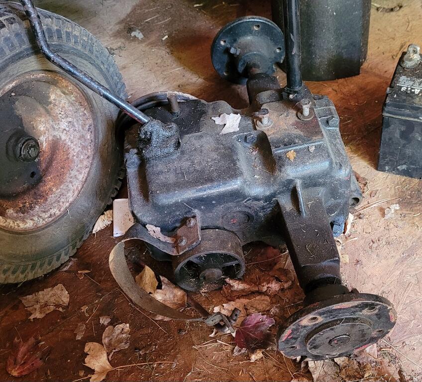

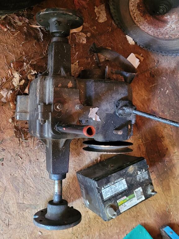

Jrblanke 918 #1 Posted July 2, 2023 Hey guys, any idea what transmission. This is? This one came out of the tractor @wallfish built at the 2022 wheel horse show. But I can't remember what it was. I looked through some of the manuals and watched a couple of @stevasaurus videos. at first i thought it was a 1967-68 5060 trans...but it has a dip stick tube. So I'm thinking it's later. James Share this post Link to post Share on other sites
Pullstart 68,524 #2 Posted July 2, 2023 Looks like an 8 speed. 1” or 1-1/8” axles Sue? 2 Share this post Link to post Share on other sites
WHX?? 53,334 #3 Posted July 2, 2023 48 minutes ago, Pullstart said: Looks like an 8 speed. 1” or 1-1/8” axles Sue? You callin him a boy named Sue Kev? ... Brake hub and hubs say later but if ' Fish put it together all bets are off. 1 3 Share this post Link to post Share on other sites
ebinmaine 75,751 #4 Posted July 2, 2023 5 hours ago, Pullstart said: Looks like an 8 speed. Definitely not a 6 speed. See the brake drum location. This is a 5060 6 speed with Limited Slip Differential. Brake drum right beside the axle tube. Share this post Link to post Share on other sites
wallfish 18,787 #5 Posted July 2, 2023 Came out of a Raider. Someone beat on the hub and knocked the axle out. 6 hours ago, WHX?? said: You callin him a boy named Sue Kev? ... Brake hub and hubs say later but if ' Fish put it together all bets are off. We did a complete trans swap and put a tractor together. Not build a trans but you're absolutely right if I did. 1 Share this post Link to post Share on other sites

squonk 44,860 #8 Posted July 2, 2023 (edited) 8 spd. All you really need to know is what the axle length and diameter is. Hubs look like the HD ones so I would say 1 1/8" Lowell has bearings and gasket. A-Z has the axles and any gears you might need. Everything is the same internally with all the 8 spds except the number of pinions. Tear it apart. Let's see what it needs. Probably doesn't need any more than a gasket and c clip. Edited July 2, 2023 by squonk 2 Share this post Link to post Share on other sites

stevasaurus 23,515 #10 Posted July 2, 2023 If it has 1 1/8" axles and is a Limited Slip, it is a 5073. Raider trans with dipstick. Brake drum on cluster gear shaft. If it has 1" axles, it is a 4 pinion #5086...Raider. An 8 pinion 8 speed has 1 1/8" axles. A 4 pinion 8 speed has 1" axles. Brake drum on cluster gear shaft. 2 1 Share this post Link to post Share on other sites
Jrblanke 918 #11 Posted July 2, 2023 1 hour ago, stevasaurus said: If it has 1 1/8" axles and is a Limited Slip, it is a 5073. Raider trans with dipstick. Brake drum on cluster gear shaft. If it has 1" axles, it is a 4 pinion #5086...Raider. An 8 pinion 8 speed has 1 1/8" axles. A 4 pinion 8 speed has 1" axles. Brake drum on cluster gear shaft. It has 1" axles. I'll have to watch a couple more videos of yours to figure out what the cluster gear shaft is, haha. 2 Share this post Link to post Share on other sites
