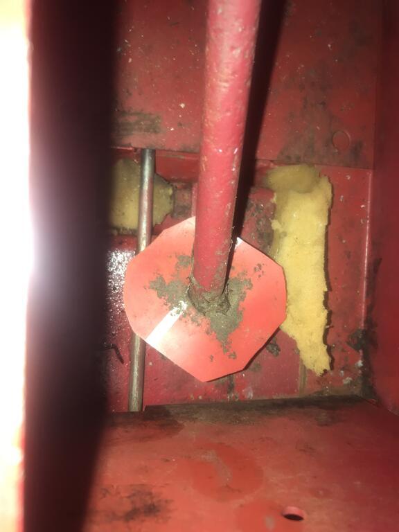

oliver2-44
5 hours ago, stevasaurus said:
I love you Oliver2-44!!  Hi Jim, how you doing??  :occasion-xmas:  I learned to type in the Navy.  :banana-dance:
I'm doing great Steve, Busy with all kind of family things and a little tractor work every now and then.
