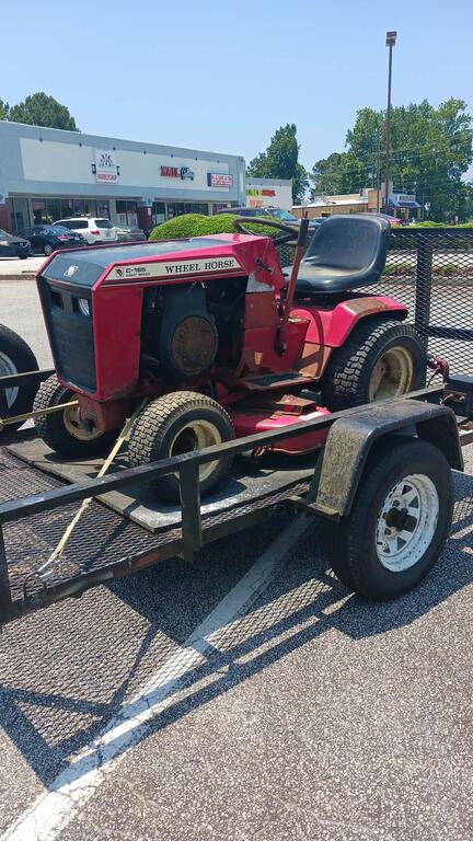

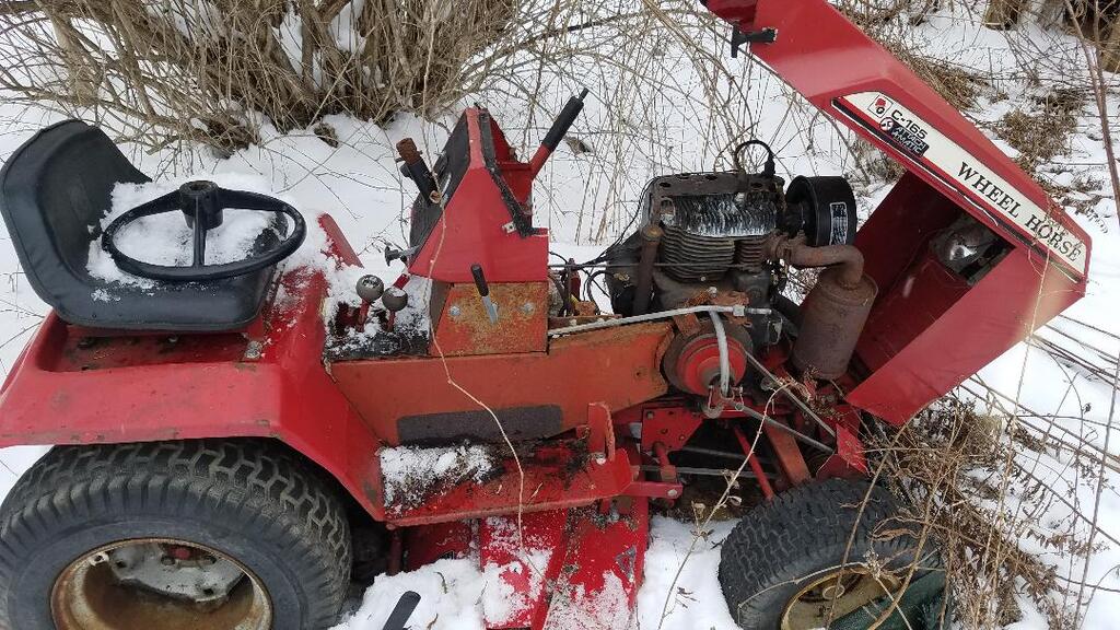

sbtgog80 12 #1 Posted June 25, 2023 just picked up this C165!! just dont know about this model , needs a new drive belt and a pin to hold the hood in place . 3 7 Share this post Link to post Share on other sites
Sparky-(Admin) 21,841 #2 Posted June 25, 2023 Very nice and with a deck ! That model was made from 1980-1984. If you find the model number tag we can tell you it’s exact year. 5 Share this post Link to post Share on other sites

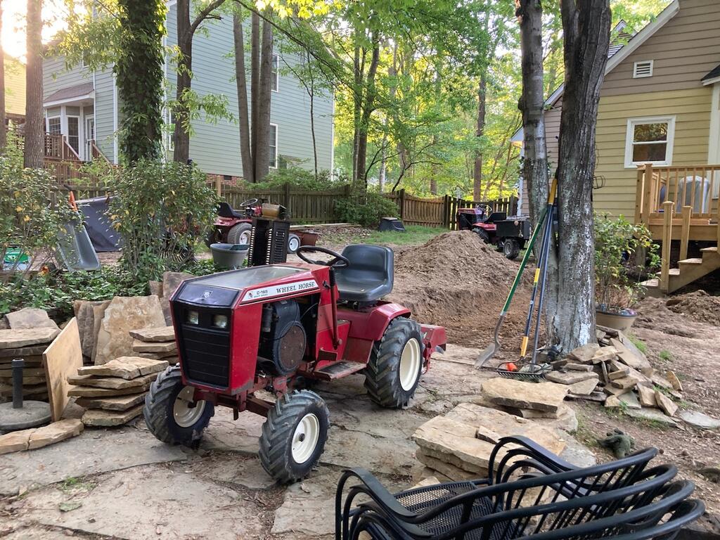

ineedanother 1,369 #7 Posted June 25, 2023 Good find. I only have 4 but this is my favorite 1 2 Share this post Link to post Share on other sites

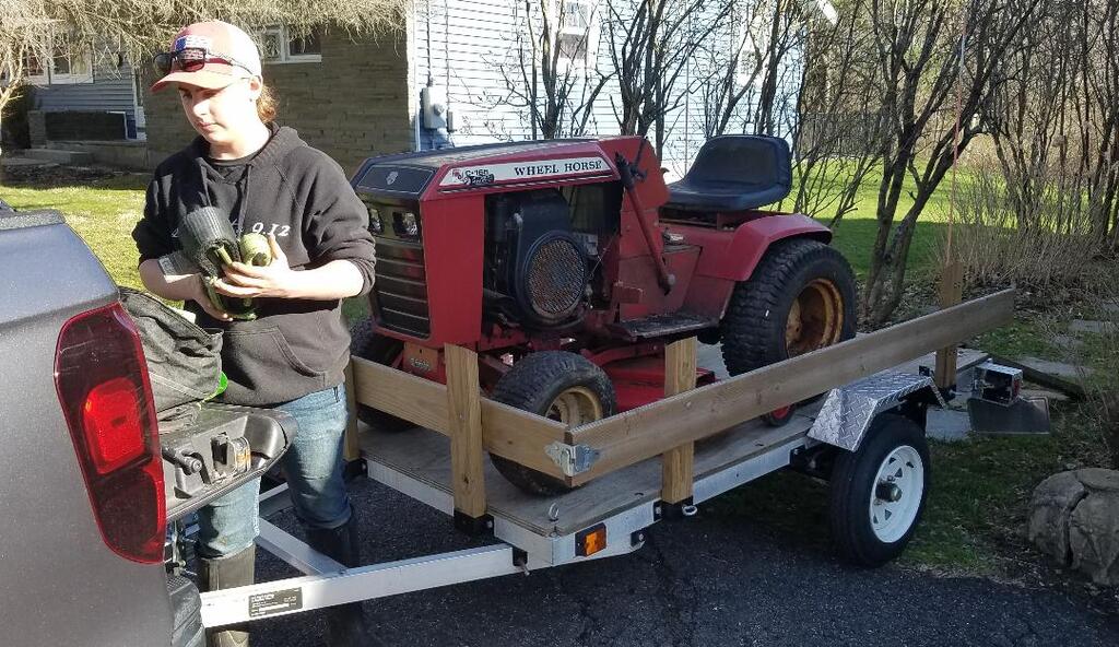

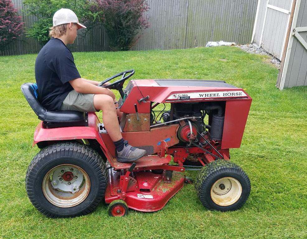

Brockport Bill 1,803 #10 Posted June 26, 2023 my grandson and I rescued a long abandoned C165-8 a couple years ago - got it running with help of a Rd Sq friend - a little labor time, and not too much $ -- it's now at my grandsons as one of his along with his 520HC ------- I'd love to find a C165 with the hydro -- don't see many of them ever posted? 3 1 Share this post Link to post Share on other sites

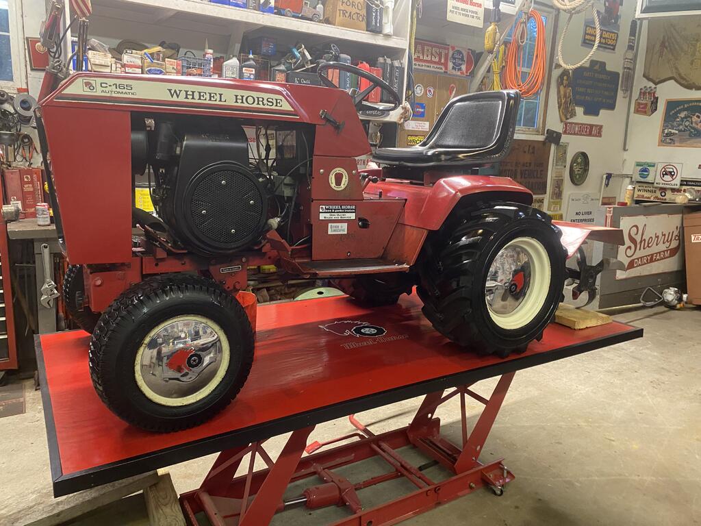

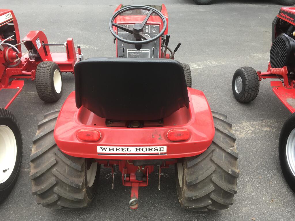

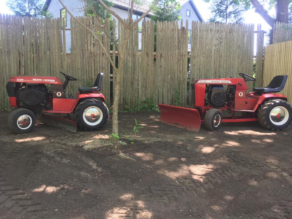

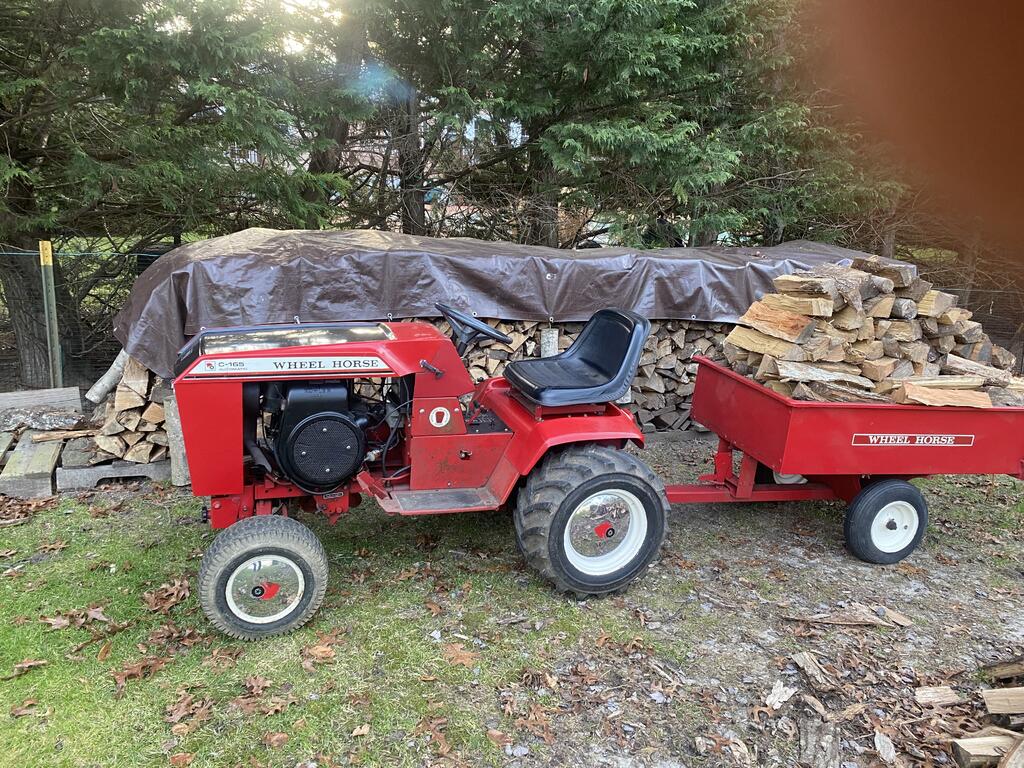

c-series don 9,363 #11 Posted June 26, 2023 @Brockport Bill Ask ye shall receive! Here’s a couple pics of mine. 4 Share this post Link to post Share on other sites

Brockport Bill 1,803 #14 Posted June 26, 2023 1 hour ago, c-series don said: @Brockport Bill Ask ye shall receive! Here’s a couple pics of mine. omg - - Yikes, Don !!!! that is one gorgeous group of tractors -- but lovin that C165 -- plus as beautiful as it is, it's also a worker tractor with that tiller, hauling a cart, plows, etc!!! Curious tho?? Is there a difference between a C165 hydro, and an automatic ?? I see the hood decal says "Automatic" I checked TractorData.com but couldn't distinguish? Although I see the yrs vary with Eaton and Sunstrand? Share this post Link to post Share on other sites
ineedanother 1,369 #15 Posted June 26, 2023 2 hours ago, Brockport Bill said: my grandson and I rescued a long abandoned C165-8 a couple years ago - got it running with help of a Rd Sq friend - a little labor time, and not too much $ -- it's now at my grandsons as one of his along with his 520HC ------- I'd love to find a C165 with the hydro -- don't see many of them ever posted? I think that was a great find and rescue, and one of the little things I liked was that the steering wheel didn't pose a question. You knew what you had there! 1 Share this post Link to post Share on other sites

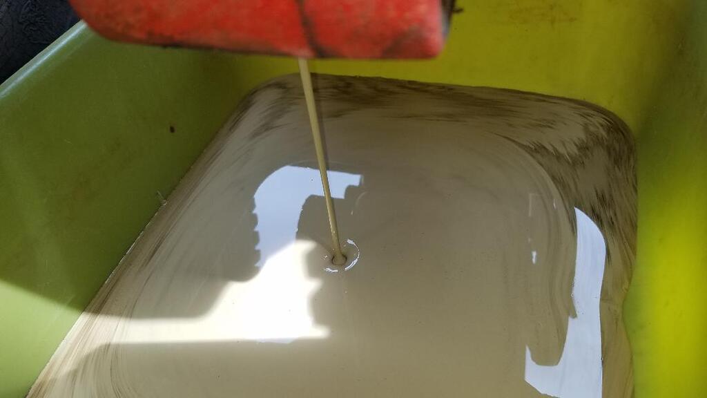

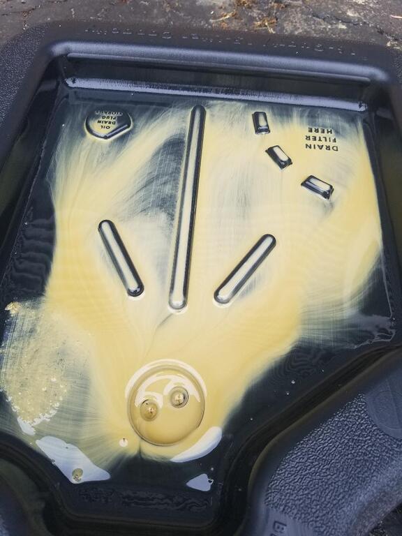

Brockport Bill 1,803 #16 Posted June 26, 2023 19 minutes ago, ineedanother said: I think that was a great find and rescue, and one of the little things I liked was that the steering wheel didn't pose a question. You knew what you had there! yes the steering wheel was one challenge ---- of course one always wonders "why was the tractor parked"? So worried about the engine internals -- but so far ok -- did need a coil, new motor mount, and other band aids, along with some typical tune up related work, Carb clean/rebuild kit, gas tank cleaned, new fuel line, some filters, plus points, plug, and fuel pump -- but also 3 flushes of tranny -- the gear shift boot was rotted from being left outdoors, thus water in the tranny -- so after the flushes and fresh gear oil, all ok - My grandson started some cosmetic work so we will see how that suceeds? 1 Share this post Link to post Share on other sites
c-series don 9,363 #17 Posted June 27, 2023 @Brockport Bill To answer your question, as far I know there is no C-165 hydro, just automatic. As you said, some came with some Sunstrands and the later models came with Eaton transmissions. I have an easy way to determine which is which. If you look at the filter location, the Sunstrand is on the side, and the Eaton is on the end of the transmission. It gets a little confusing, but in the 300 series tractors there is a difference between the A and the H models. The A models had an eaten 700 transmission and manual lift which was not made for ground engaging implements. The H models had an Eaton 1100 transmission with the heavy duty inch and an eighth axles. In the 400 series the A has the Eaton 1100 (417-A and 418-A) The 518-H however had an Eaton 700 while the 520-H had an Eaton 1000. So there you go, now you’re probably more confused than before 🤣🤣 I’m pretty sure I am ! 2 Share this post Link to post Share on other sites
