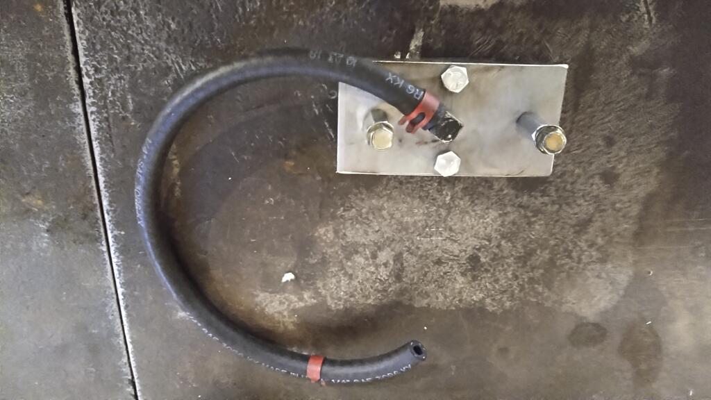

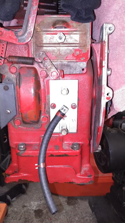

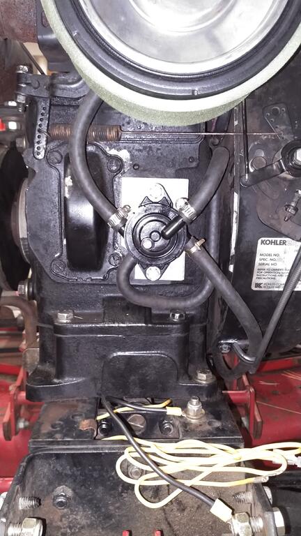

I've been switching to vacuum pulse pumps over the last few years. Works great
