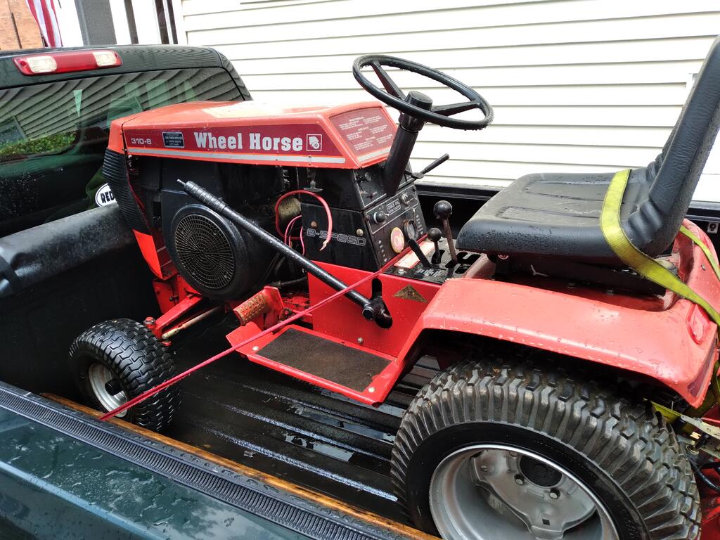

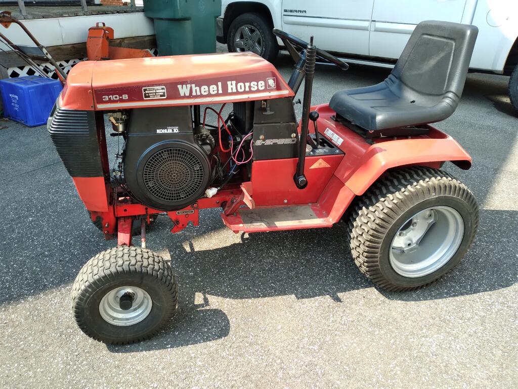

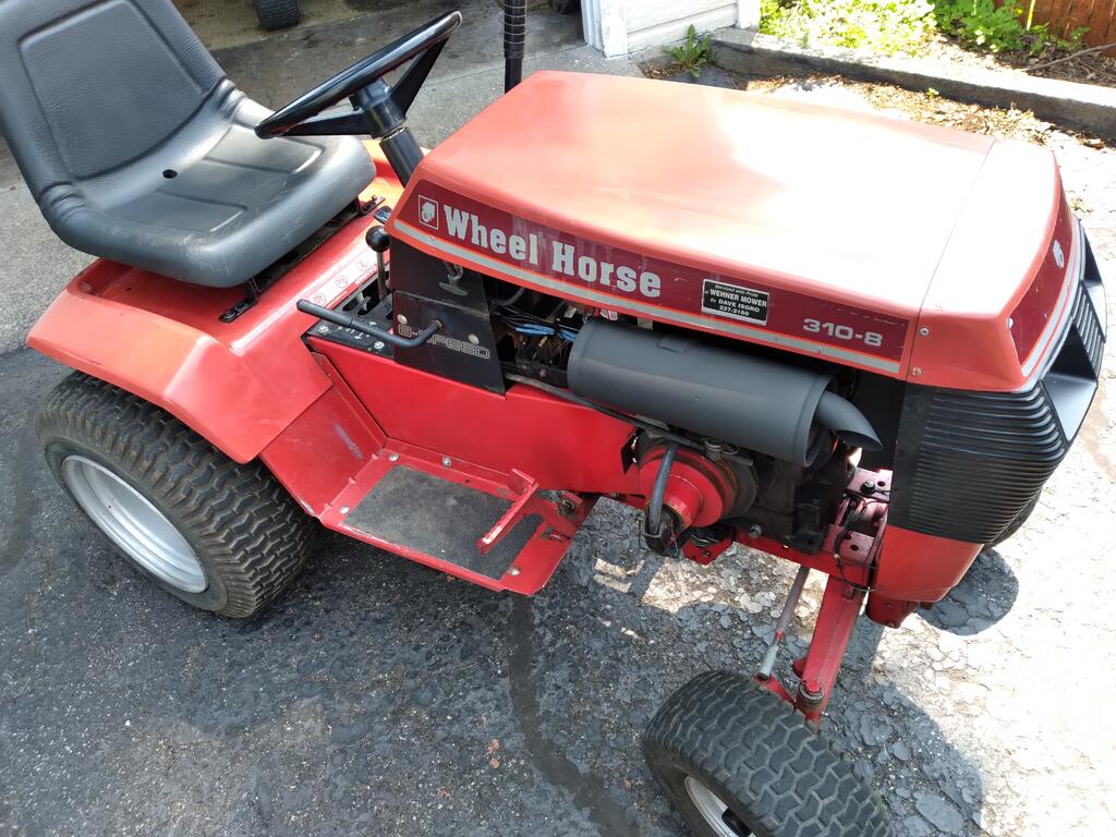

D_Mac 9,147 #1 Posted June 17, 2023 (edited) So as many of you know i picked this up for free about a month ago. Gave me some trouble getting it running but it is now running and driving again. Previous owner didn't want to repair it. The throttle plate on the carb had come off and the carb was damaged. The starter was also sticking. Offered it to me for free if I just came to pick it up. Long story short after a couple of carburetor tries, new head gasket, cleaned and greased the bendix on starter, new battery, new fuel filter, new gas it's running nice. Even came with a 48 inch deck. Seat was replaced last year. I still need to clean it all up but I am so happy to hear it running so well. I'll post more pics as I do more to it. Edited June 17, 2023 by D_Mac 9 2 Share this post Link to post Share on other sites
squonk 42,534 #2 Posted June 17, 2023 So. Are you going to tell us what was wrong? 2 Share this post Link to post Share on other sites
Pullstart 64,533 #3 Posted June 17, 2023 Look at the improvements you’re making working on these old tractors! Two years ago, you wouldn’t have pulled a head without someone there walking you through it. Now, you’re an all around small engine mechanic! 2 1 Share this post Link to post Share on other sites
D_Mac 9,147 #4 Posted June 17, 2023 (edited) 16 minutes ago, squonk said: So. Are you going to tell us what was wrong? I'm embarrassed to say. I told you I emptied the gas tank and put fresh gas in it. Well it seams you have to blow out the gas lines, and clean out the fuel pump and new carb as well. Full of water. Live and learn. Now I know. 7 minutes ago, Pullstart said: Look at the improvements you’re making working on these old tractors! Two years ago, you wouldn’t have pulled a head without someone there walking you through it. Now, you’re an all around small engine mechanic! Lol read above and I had help the whole way through. Edited June 17, 2023 by D_Mac 3 Share this post Link to post Share on other sites

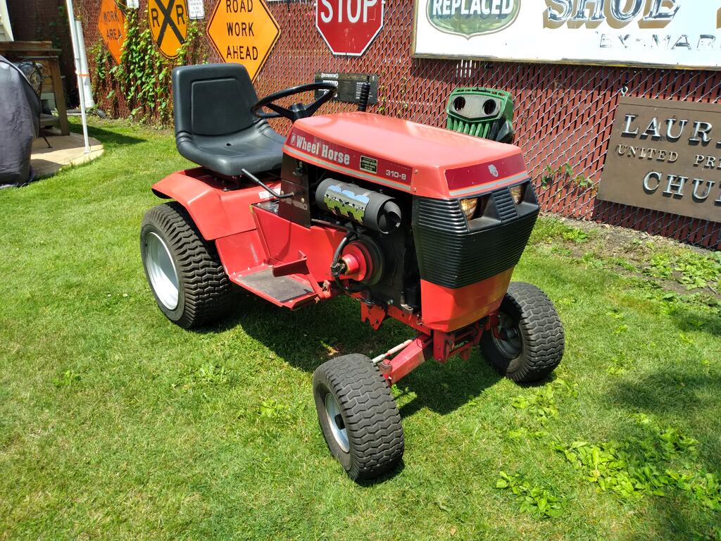

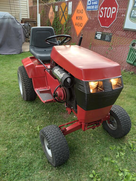

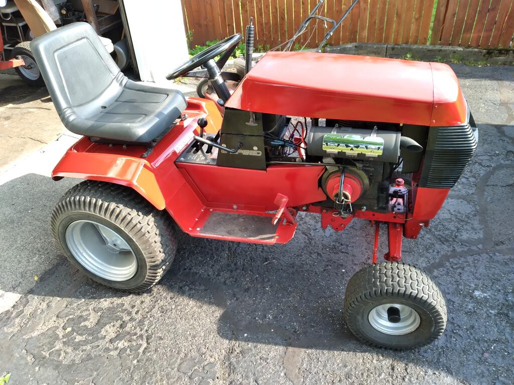

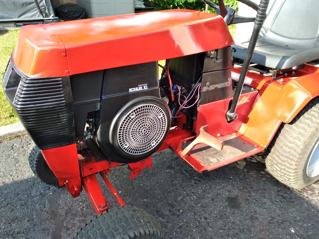

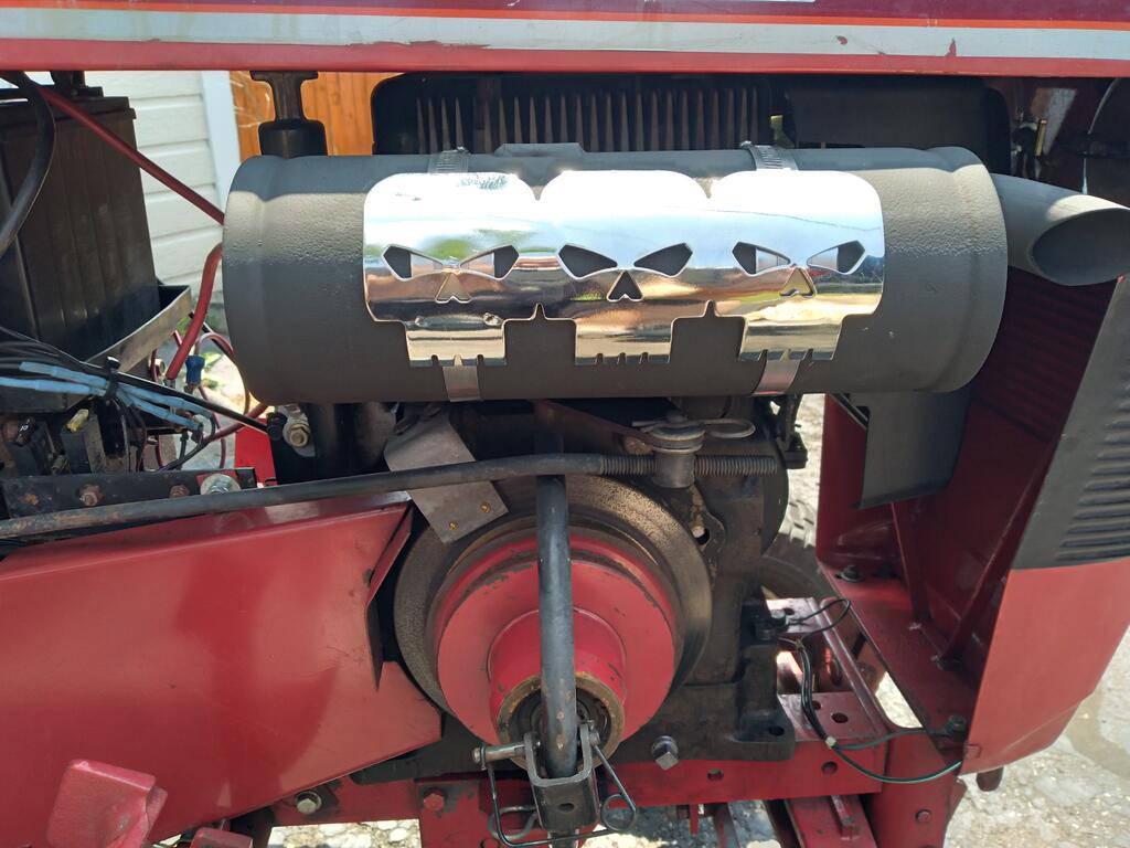

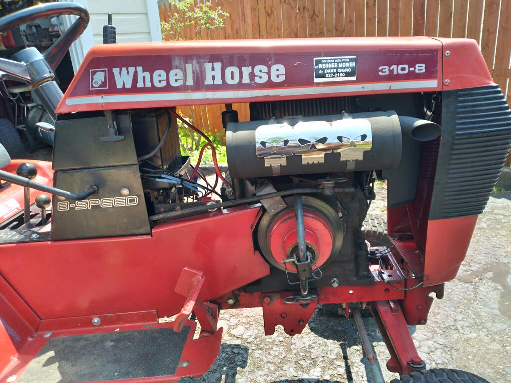

D_Mac 9,147 #13 Posted June 18, 2023 So this morning I brought it home from my buddies garage. Gave it a bath and added some chrome and a little paint. Painted the muffler black with some high temperature paint. Added a chrome heat shield to it. Then removed the debris screen and painted it with some chrome paint. I plan on removing the decals and painting the hood and seat pan / rear fenders with some Regal Red. They have been painted before and color does not match. I mentioned before I have a set of 416-8 decals I might use on it just cause I have them leftover from previous project. Put the deck in the shed will look it over another time. Seems solid and clean. Might have to pick up the rpms some . At full throttle I don't think it's at 3600 rims. Going to need all of that to turn that 48 inch trough some high grass. 3 Share this post Link to post Share on other sites

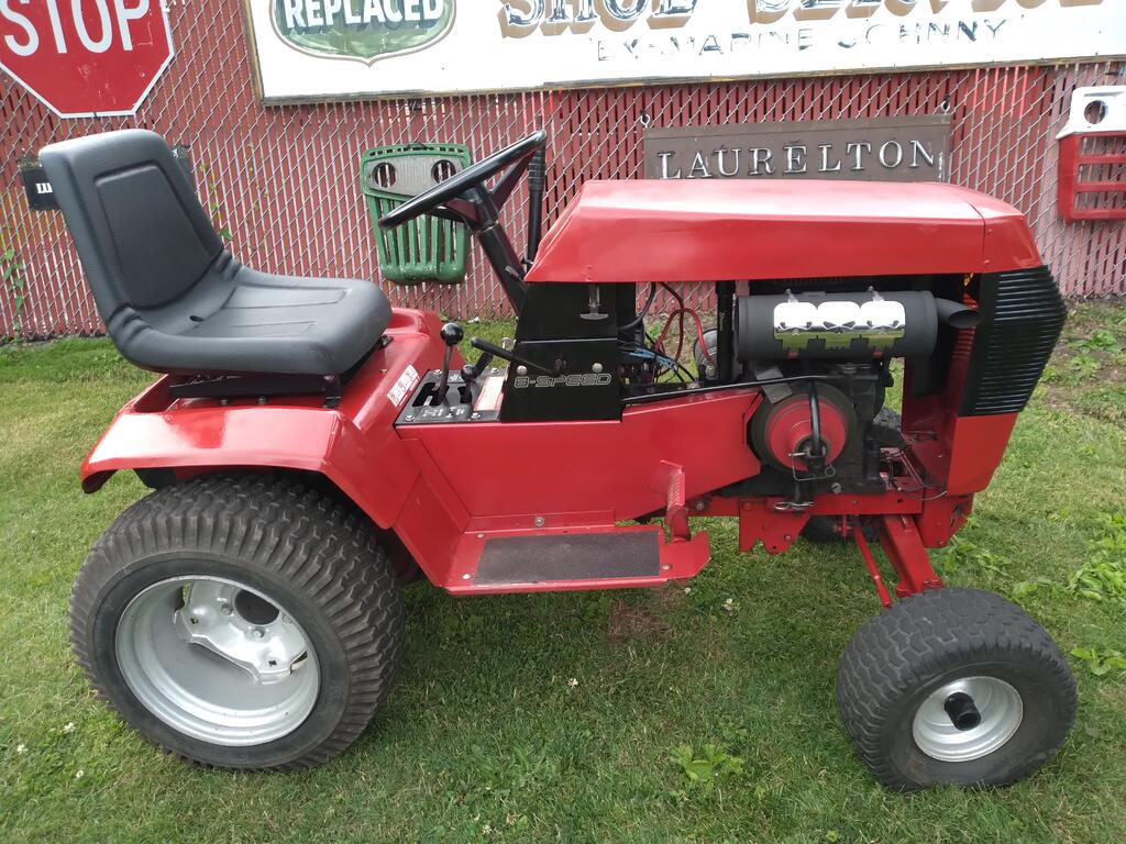

D_Mac 9,147 #14 Posted June 18, 2023 (edited) Sooooo....Removed the decals, some Regal Red on the hood and rear fenders. Looks a lot better. Give it some clear tomorrow. Coming along nice. Done for the day now. Edited June 18, 2023 by D_Mac 1 1 Share this post Link to post Share on other sites

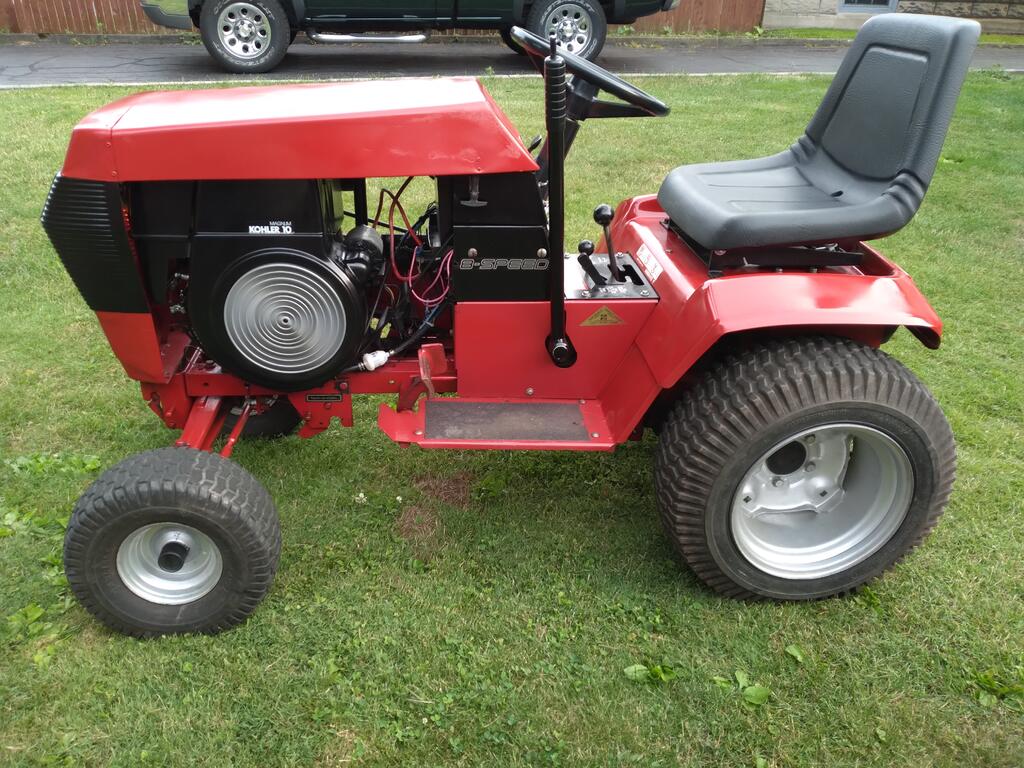

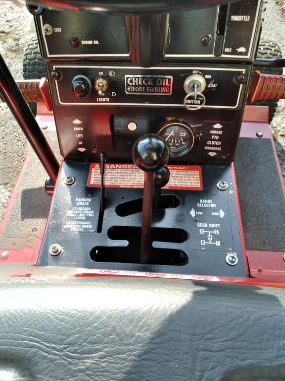

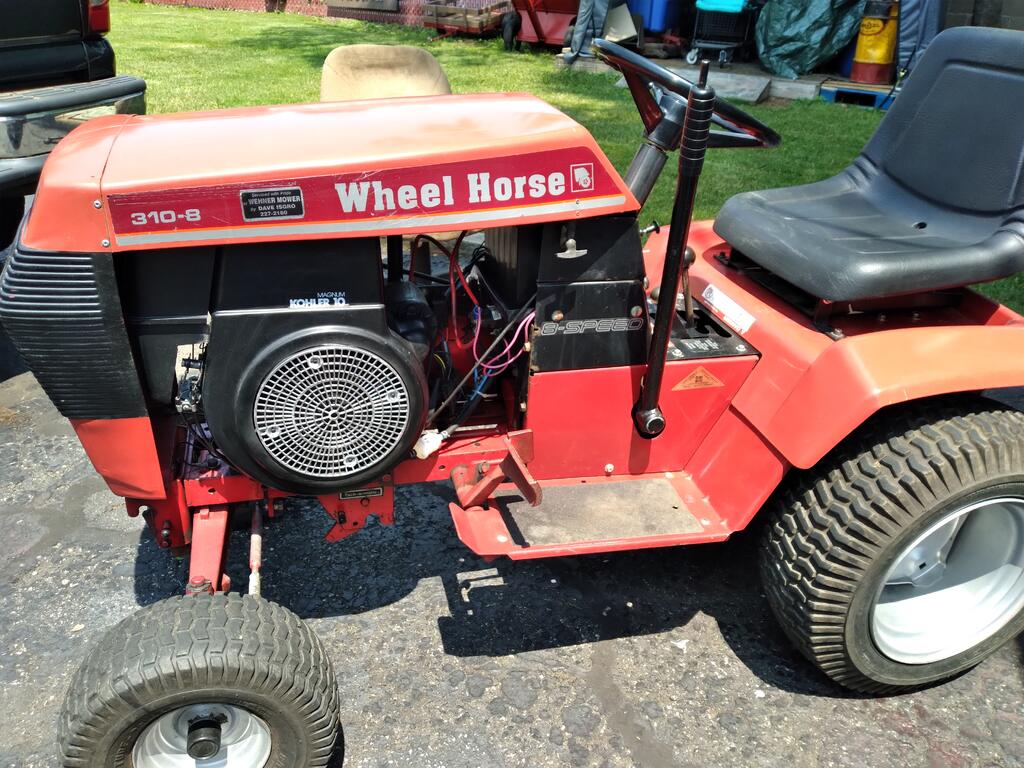

D_Mac 9,147 #15 Posted June 20, 2023 3 coats of clear. Got a little orange peel in a couple of spots. Overall it looks a lot better. After the clear I rubbed it down with some detailing wax. Poured some dry gas in the tank. Took it for a spin. Still thinking about decals. Noticed the volt meter isn't moving. Oh well, what do you expect for FREE !!! 2 1 Share this post Link to post Share on other sites
ineedanother 1,396 #16 Posted June 20, 2023 Looking good Your voltmeter has to have a good ground and those hood stands aren't great for that. On the back of the meter one terminal is 12v in and the other is ground. 1 1 Share this post Link to post Share on other sites
D_Mac 9,147 #17 Posted June 20, 2023 Thanks... any idea what that " test" switch does ? 30 minutes ago, ineedanother said: On the back of the meter one terminal is 12v in and the other is ground. Share this post Link to post Share on other sites
tunahead72 2,518 #18 Posted June 20, 2023 Your tractor has a low oil safety switch that's supposed to prevent the engine from starting if the oil level is low. The "engine oil" light is supposed to come on in that case, and you can test the light by moving the "test" switch up. My personal preference is to pay a huge amount of attention to that "CHECK OIL BEFORE STARTING" sticker just below that, and follow that advice religiously. 2 1 Share this post Link to post Share on other sites
Jon Paulsen 291 #19 Posted June 20, 2023 I dig it! I don't get all three of my thumbs up for just anything... Happy for you and your nice machine. You saved a soul. 1 Share this post Link to post Share on other sites
D_Mac 9,147 #20 Posted June 20, 2023 Yeah when I hit the switch no light comes on. Seems to do nothing. The push button start works. It also starts with the key. Not sure why you need both. 1 Share this post Link to post Share on other sites
tunahead72 2,518 #21 Posted June 20, 2023 1 hour ago, D_Mac said: ... The push button start works. It also starts with the key. Not sure why you need both. You don't, somebody was messing around in there before you got it. I'm going to stay out of the (to me) difficult electrical discussion, you'll just hurt yourself if you listen to my advice on wiring. 2 Share this post Link to post Share on other sites
