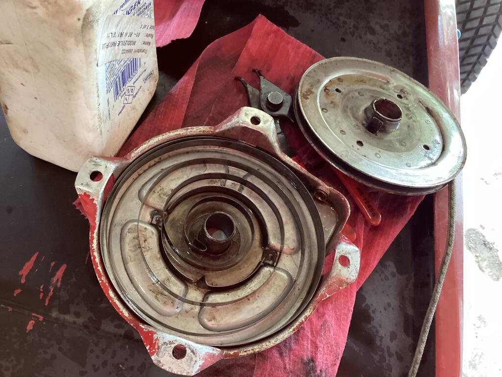

Pullstart 68,521 #2 Posted June 15, 2023 The assembled look. This one is off my RJ35. The things dads do to keep kids happy… Share this post Link to post Share on other sites

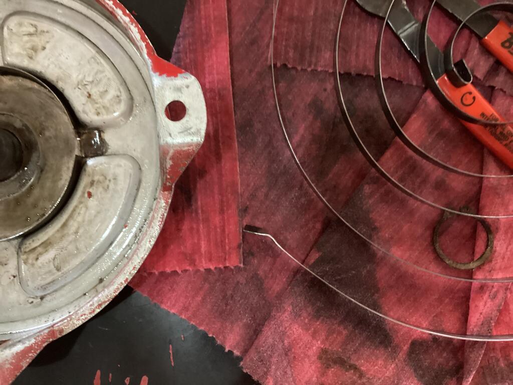

Pullstart 68,521 #4 Posted June 15, 2023 1 minute ago, WHX?? said: I just keep the rope in the groove and wind it. Once you have it to where you want just fish the rope out of the hole and put a vice grip on it. Tie the handle on. Somewhere I have the manual for doing it but on on this phone. I need to figure out where the other end of the spring goes, it done sprung. Share this post Link to post Share on other sites

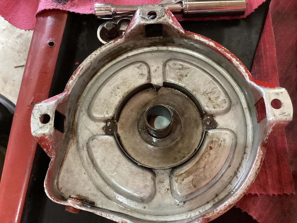

WHX?? 53,327 #5 Posted June 15, 2023 The outside end should have a tee or notched that fits into a slot on the housing. The hook on the inside end sets in that tab sticking up near the center. Share this post Link to post Share on other sites
Pullstart 68,521 #6 Posted June 15, 2023 Which slot does it go in? Does the spring need more bend in it? Share this post Link to post Share on other sites
WHX?? 53,327 #7 Posted June 15, 2023 Yep I think so ... ok should be hooked like the inside. Looks like it just straightened out which is tough to do on spring steel. 1 Share this post Link to post Share on other sites

Pullstart 68,521 #9 Posted June 15, 2023 2 hours ago, WHX?? said: Yep I think so ... ok should be hooked like the inside. Looks like it just straightened out which is tough to do on spring steel. So the bent tab on the housing is in need of straightening and the spring is in need of bending? 13 minutes ago, ri702bill said: AND do wear gloves & goggles - don't need another misadventure posted in "bumps & bruises"!!! suppose any heat on the end of the spring is in order? MAP gas? Propane maybe? Share this post Link to post Share on other sites

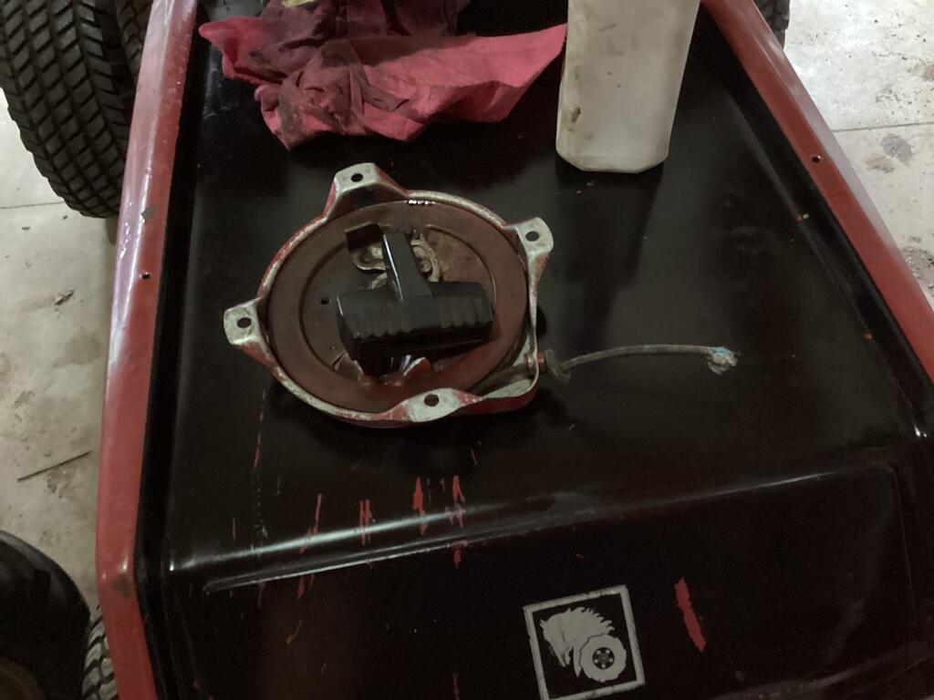

Pullstart 68,521 #10 Posted June 16, 2023 All is good! I even gave a black hood some WD40 lovin’ while I was at it! 2 1 1 Share this post Link to post Share on other sites
