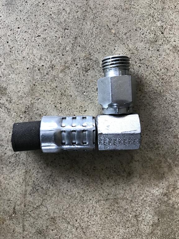

RPDeP 4 #18 Posted June 17, 2023 I cut the right angle connectors off the ends of the hose and one of them is blocked. I can't see light or push air through it. The hose is fine, as is the other connector. The blockage is in the 90 degree elbow and not in the crimped area. I may try to cut apart the elbow to really identify the issue. 1 Share this post Link to post Share on other sites
Handy Don 13,143 #19 Posted June 17, 2023 11 minutes ago, RPDeP said: I cut the right angle connectors off the ends of the hose and one of them is blocked. I can't see light or push air through it. The hose is fine, as is the other connector. The blockage is in the 90 degree elbow and not in the crimped area. I may try to cut apart the elbow to really identify the issue. Pictures, please! 1 Share this post Link to post Share on other sites
Bill D 2,068 #20 Posted June 18, 2023 7 hours ago, Handy Don said: Pictures, please! Yes, please post pictures. I'm sure Wheel Horse Parts & More will replace your defective hose. Share this post Link to post Share on other sites

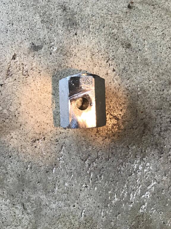

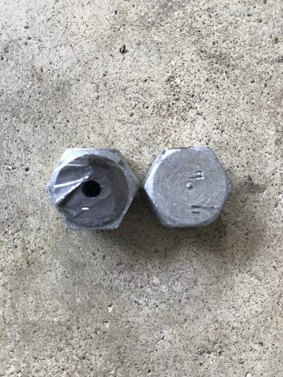

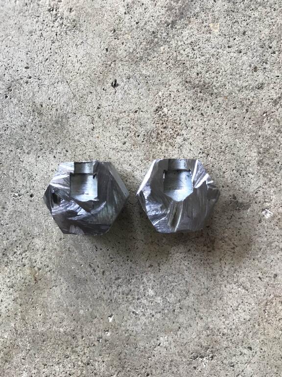

RPDeP 4 #21 Posted June 20, 2023 (edited) Here are the pictures of the cut up right angle hose connector. Edited June 20, 2023 by RPDeP 1 Share this post Link to post Share on other sites

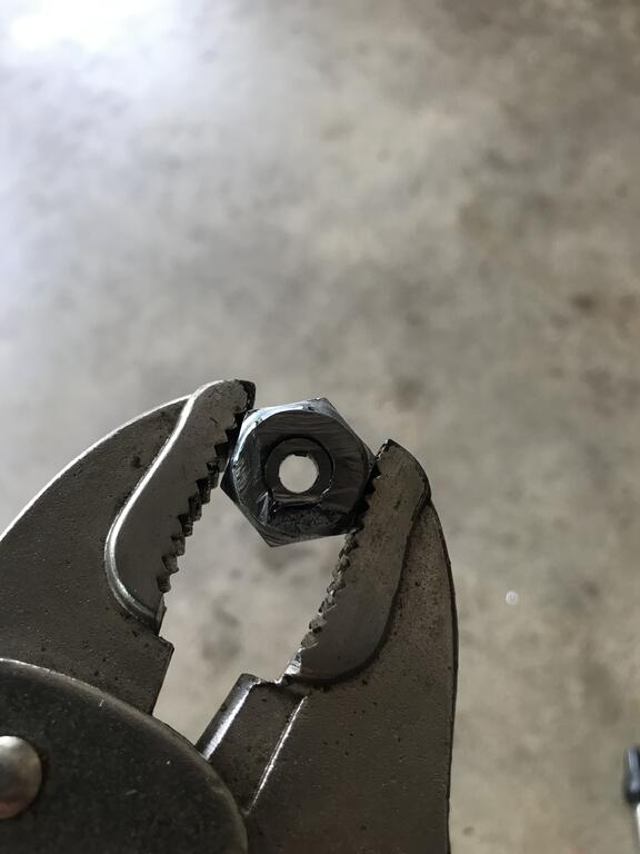

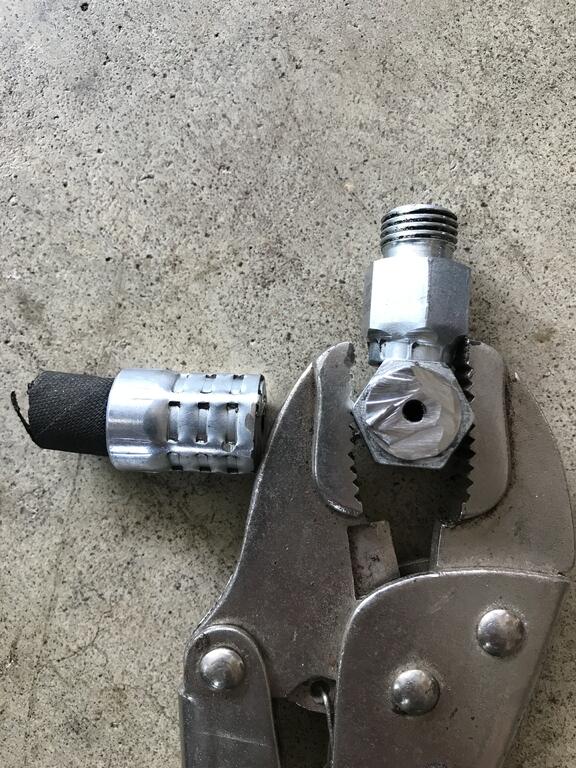

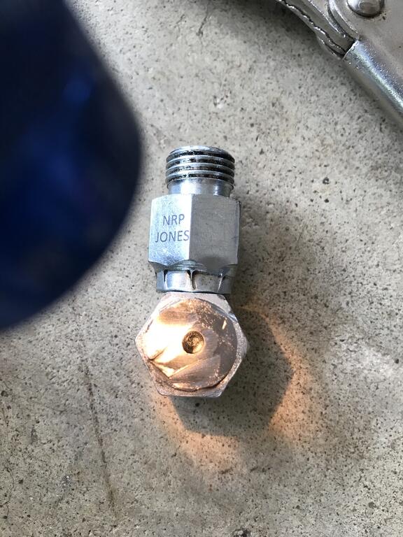

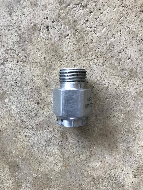

RPDeP 4 #22 Posted June 20, 2023 (edited) An these final two tell the story. Edited June 20, 2023 by RPDeP Share this post Link to post Share on other sites
Handy Don 13,143 #23 Posted June 20, 2023 Wow. So a manufacturing defect that the oil passage wasn’t fully drilled out. Like you, this possibility would have been WAY down on my list. Share this post Link to post Share on other sites
RPDeP 4 #24 Posted June 20, 2023 Tells me the connector manufacturer doesn't test/check the connector nor the hose manufacturer the completed hose. Share this post Link to post Share on other sites
Handy Don 13,143 #25 Posted June 20, 2023 31 minutes ago, RPDeP said: Tells me the connector manufacturer doesn't test/check the connector nor the hose manufacturer the completed hose. Yep. Kinda makes you want to grab someone and shake them.....but better not. Share this post Link to post Share on other sites
