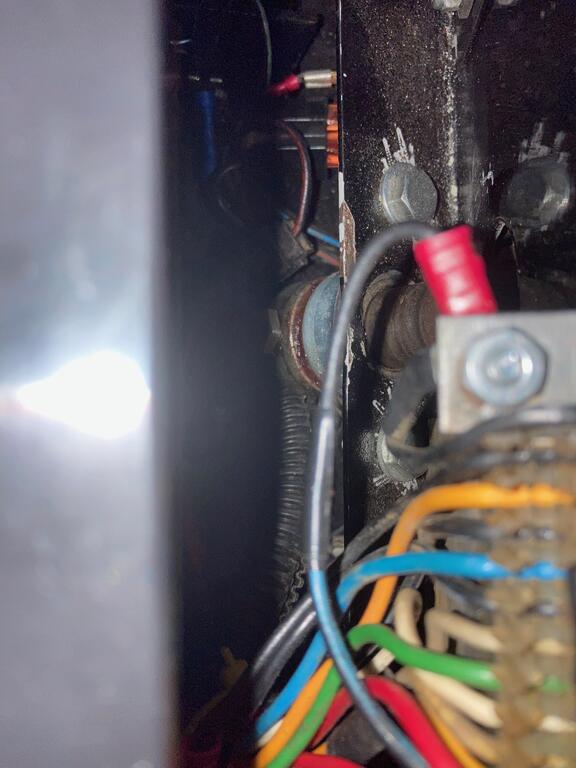

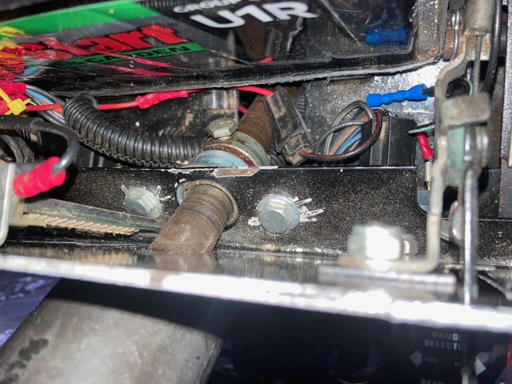

Searcher60 209 #1 Posted June 15, 2023 Hello everybody! Restoring a 1987 416-8, with the 16 HP Magnum. Would somebody post pics of how the wiring from the warning light circuit board was routed? It seems like a lot of wires to put in the same hole where the steering shaft goes thru the battery box base plate? A pic of wiring behind the battery and the wiring in box where the gear and range shifters are would be nice. Thanks for any help! Share this post Link to post Share on other sites

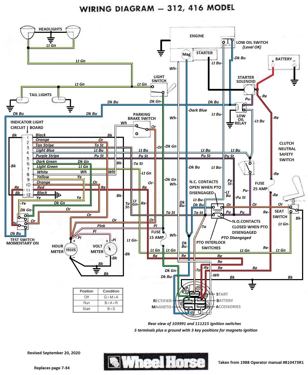

biged77 113 #2 Posted June 16, 2023 I restored a 1988 416-8 and used a plastic spllit tube to route the wiring to the circuit board. It's tight but enough room. The raceway should keep the wires from chafing. Be sure to use the revised detailed wiring diagram that has been corrected for a wiring error. 1 Share this post Link to post Share on other sites
