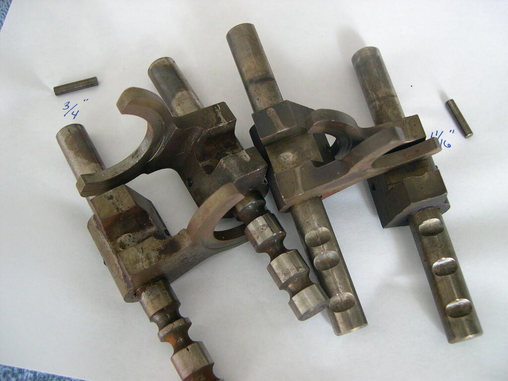

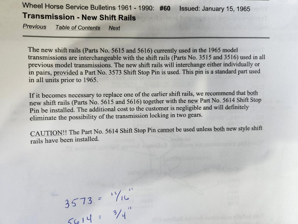

Racinbob 11,665 #5 Posted June 15, 2023 The flats on the rails helped but didn't totally resolve the issue.Some time before that they issued another service bulletin stating that 40w lube should be used to help. A much more positive fix was service bulletin 60. Old rails on the right, newer on the left. This was a newer version which was most likely due to manufacturing process changes. They are fully interchangeable. Keep in mind though that there is a difference in the first/reverse and 2nd/3rd rails. Note the center detents, Make sure you use the longer 3/4" stop pin if you put the newer rails in otherwise is won't help. 1 1 Share this post Link to post Share on other sites

Racinbob 11,665 #9 Posted June 15, 2023 Actually the vent relieving flats only helps the problem but doesn't eliminate it. Service bulletin #60 provides a positive mechanical stop. Prior to the flats Wheel Horse had issued another service bulletin stating that 40w lube should be used to help alleviate the suction. That even made it in some of the owners manuals and they neglected to switch it back to the heavier lube after a real fix was done. Share this post Link to post Share on other sites
